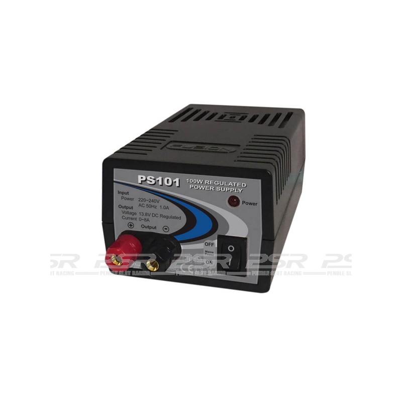

Does the LED on the front of the power supply light up ?
Is there a fuse in the mains plug for the power supply
12th-Mar-21, 11:23 AM
The fan comes on and the red led lights up on the front. I have not checked the fuse in the plug but took the previous observations as indicating there was power entering the box.
I'm not the most confident person when it comes to electrical matters, but the multimeter picked up the voltage on another power supply I have in the garage, so I don't think it is anything obvious that I am missing.
Anyway, it's packed up in a box and about to go off to Nelson for a replacement.

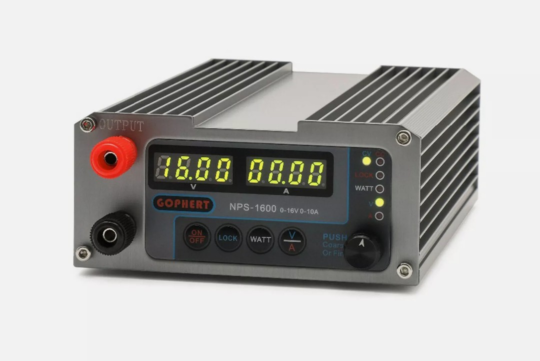

I have one of these on its way from China for my Hudy.
All my little Fusion has to do is send 13.8v to my SCP and track...

13th-Mar-21, 07:31 AM
I'm now wondering whether many of your unfathomable problems with SCP are down to the way you've described using your fusion 101 supply.
When I first started getting an Oxigen team together "Kessel Run" , I struggled getting the component parts for home car (setup and testing) together.
I found that powering the controller from the same DC supply leads (that feeds the car) caused all kinds of problems. More problems than I can list.
I bought the 201ADJT and all ofthe issues went away.
I suspect that the 2 DC outputs for the 201 are separately regulated from the AC input so noise from the motor can't impact the controller.
Alan W
Alan W
