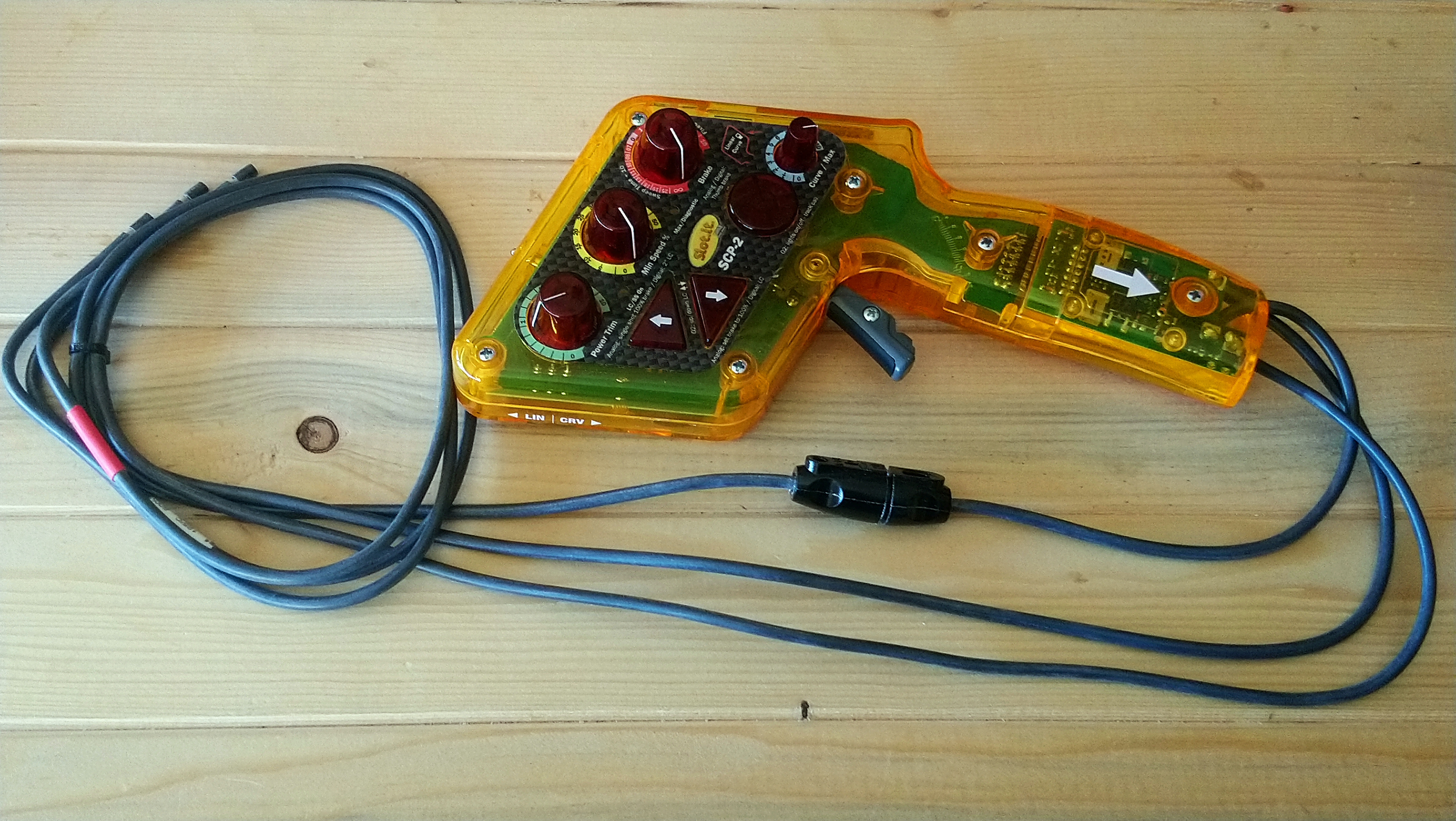

RE: Slot.it High Current Analogue Cartridge - BAracer - 26th-Feb-21
As someone who takes design too seriously, I have to say that the weight of the wiring on the 'metal' cartridge is pleasingly floppy and heavy, and the inline 10A fuse holder wouldn't look out of place in a 10kva sub-station...
[attachment=12823]
