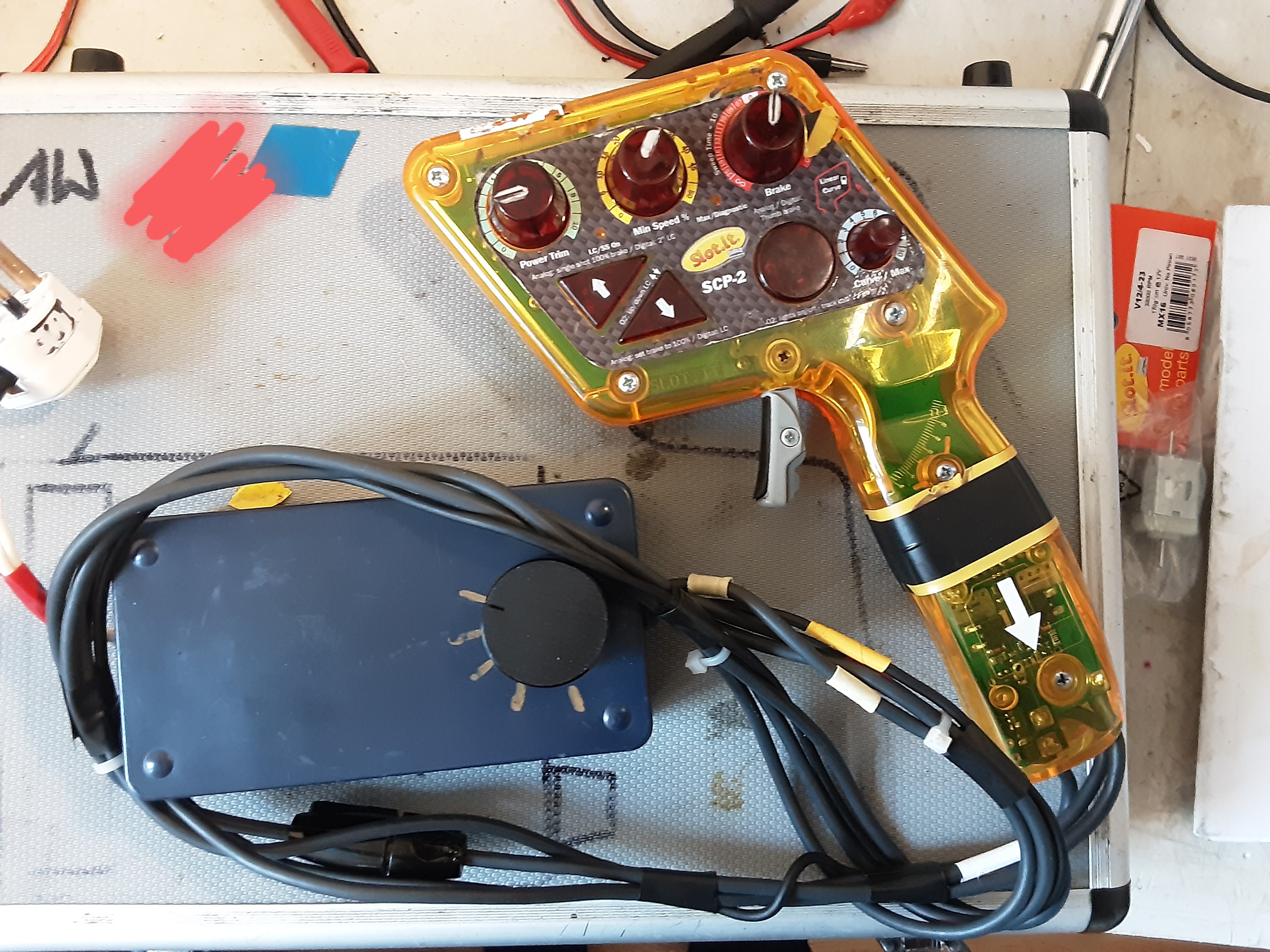

Whether to build a separate box or integrate it into the SCP2 relay bypass box ?
A whole separate subject - covered by slot.it in the link here.
https://slot.it/wp-content/uploads/2020/...P1.en_.pdf)

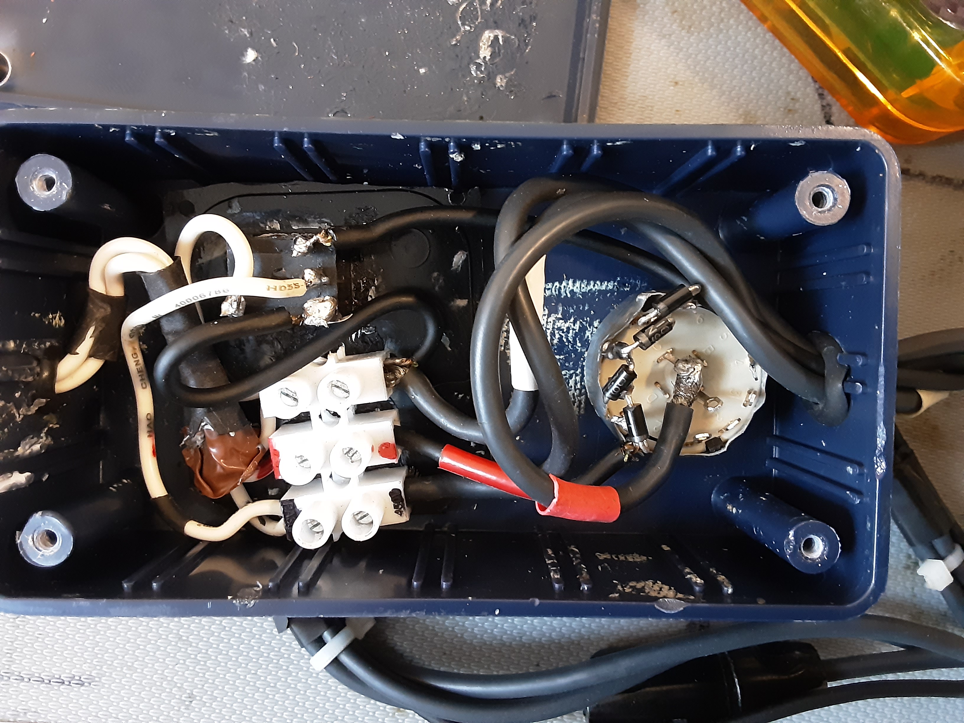

My existing relay bypass box was not large enough for the components needed for the brake-choke. Thankfully, a trawl of my electronic dump-box brought up a suitable box of perfect size, along with scavenged diodes and a scavenged rotary switch (originally bought for a guitar pickup switch project)
The question of whether to use diodes or resistors was decided after enquiring at LSC about the braking technology built into their plug points. LSC use resistors and the general view is that this isn't really a good solution because it doesn't just soften the brakes, it changes the behaviour of the brakes. The voltage dropped by resistor is dependent on the current passing whereas a diode drops a fixed voltage.
I used this diagram as a base for the unit and built and tested a simple 4 position brake softer. This will certainly be good enough to have better control of the linear braking.
The only opportunity to test was at Nascot wood. Fri25th March and it worked well on cars using slot.it mx16 S-can motors.
Not an ideal test because NWSCC is Ninco Plastic, nothing like Molesey.
The only opportunity to test for Molesey was at the event.
As it turned out, any use of the softener circuit , deadened to power to the car.
It was almost like the brakes were on even if the throttle was being pressed.
This behaviour could be a result of:
- the wiring at Molesey
- using higher power motors at the event
- an unforseen issue with the SCP circuitary.

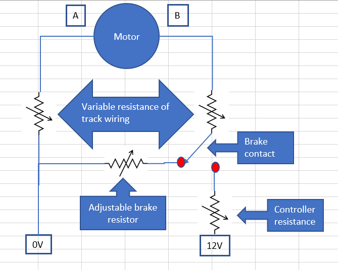

The variable resistance of the track wiring/rails is present all the time, I can't understand why adding some resistance  in the controller/separate box would make a difference.
In practical terms what is different about the brake behaviour between the 2 methods?

"The variable resistance of the track wiring/rails is present all the time,"
- If you have anything less than infinite resistance between the rails "all the time",  this is a short circuit  and the track won't be able to power the cars.
"I can't understand why adding some resistance  in the controller/separate box would make a difference"
-When a dc motor is open circuit, no current can flow in the coil., If no current flows, no backEMF can be produced
-When a dc motor is closed circuit (shorted across the contacts) current flows through the coil producing a backEMF causing the motor to resist being turned.
Between the 2 extremes, the level of backEMF can be controlled by introducing a resistance between the motor contacts.
The resistance allows some current to flow. A variable resistance can produce various amounts of backEMF.
"In practical terms what is different about the brake behaviour between the 2 methods?
- diodes drop a fixed voltage
- resistors drop voltage dependant on the amount of current flowing.
In practical terms, control of diode based braking should be less impacted by the motor being used.
Alan

I didn't say the 2 rails were shorted together, simply that when we apply the brakes, each side of the motor is still connected via the track rails/wiring. The diagram probably explains it better.
This wiring has a resistance which changes all the time depending on how far or near the car is to the controller.
The negative side of the motor is always connected to ground via the track wiring, the motor is never ""open circuit"
There is another situation where current will not flow across the motor, that is when both side are connected to the same voltage, important point because this is what helps us get the same braking effect all the way round the track.
(31st-Mar-22, 07:07 AM)Nonfractal Wrote:  Between the 2 extremes, the level of backEMF can be controlled by introducing a resistance between the motor contacts.
Alan
OK, so it seems that a resistance brake adjuster might need to be turned further than a diode one to get the same breaking effect, but no drastic change like some sort of sweep braking or worst still, reverse sweep braking.
Joel
