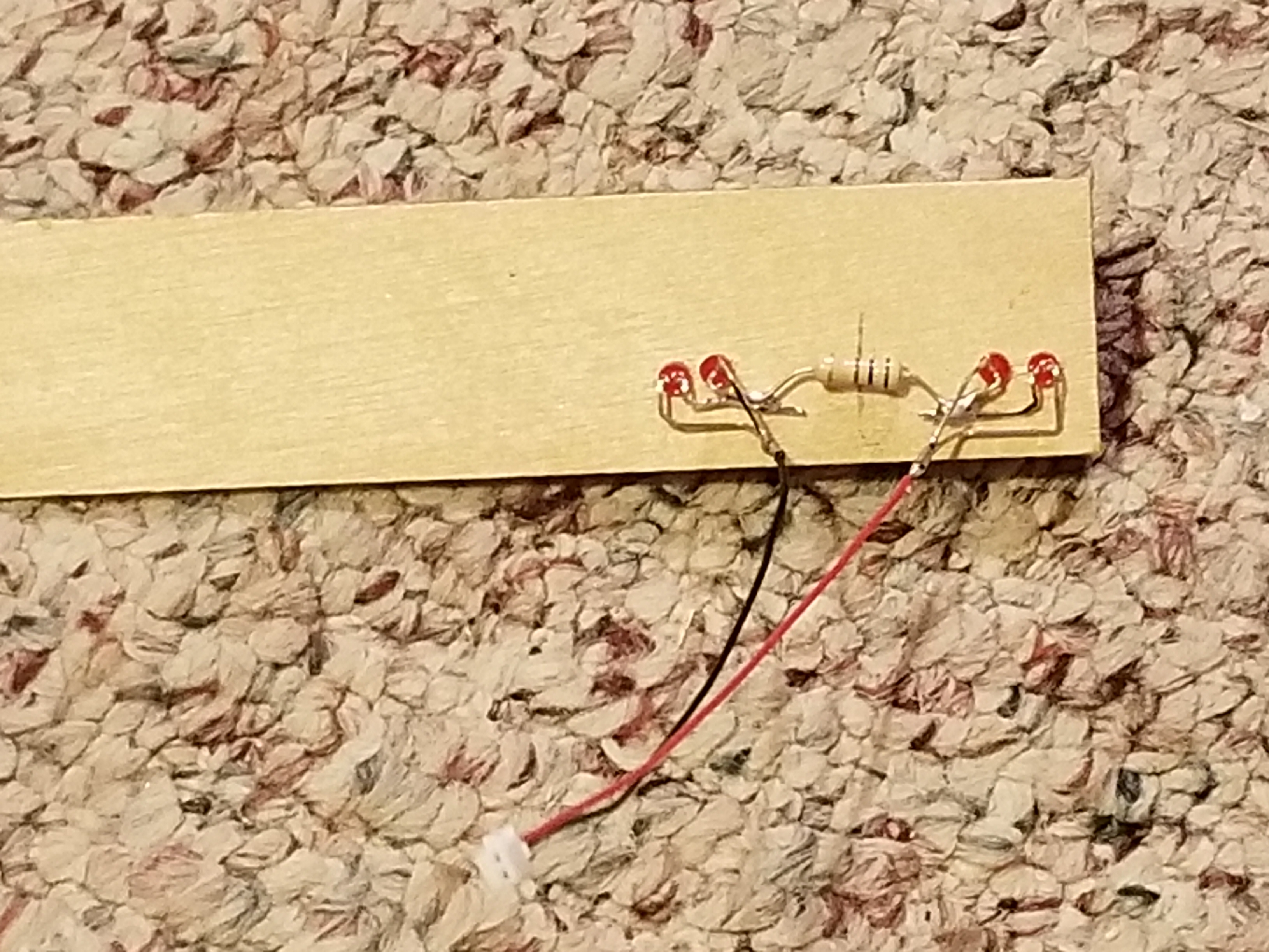

Here are the LED tail lights after being soldered together with their resistor in a wooden jig. The jig matches the holes drilled into the resin body shell.

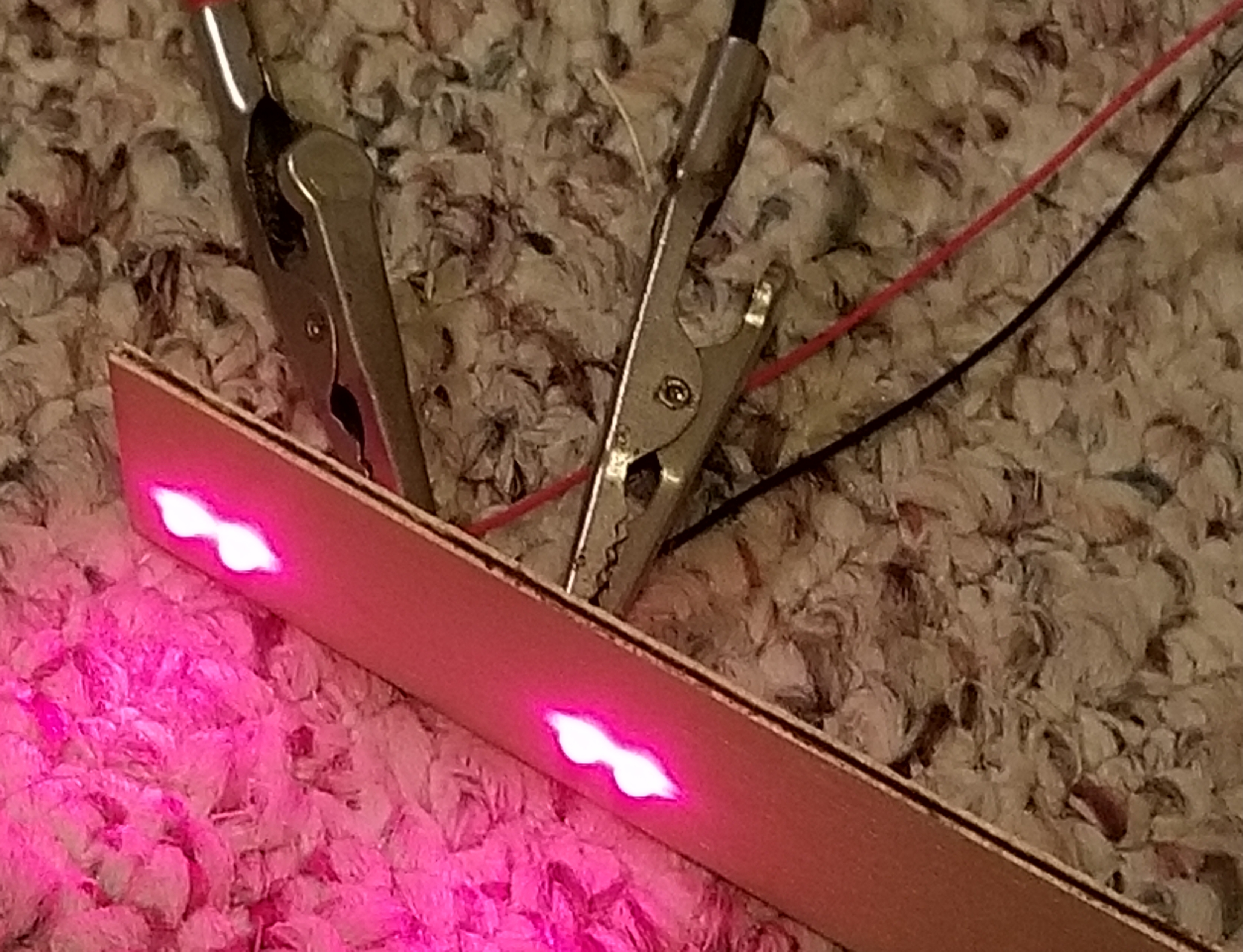

Thanks! Sometimes fitting the LEDs is a bit fiddly. What was done for this car was to fit each LED separately into the body shell, bending and trimming the leads to clear the tires, then putting them into the jig to solder. Before using RC56 aliphatic glue to secure them they were tested using a 12v source. The resistor allows for about 14v max if memory serves.

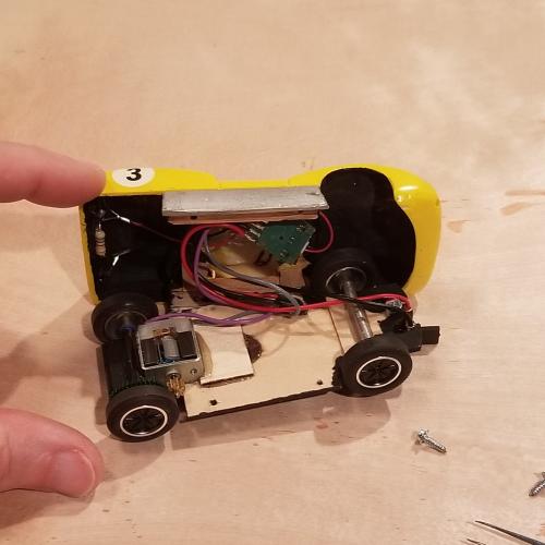

Here's another picture showing some 'innards' so if you're squeemish don't look!
[+] 2 members Like ARUP's post
