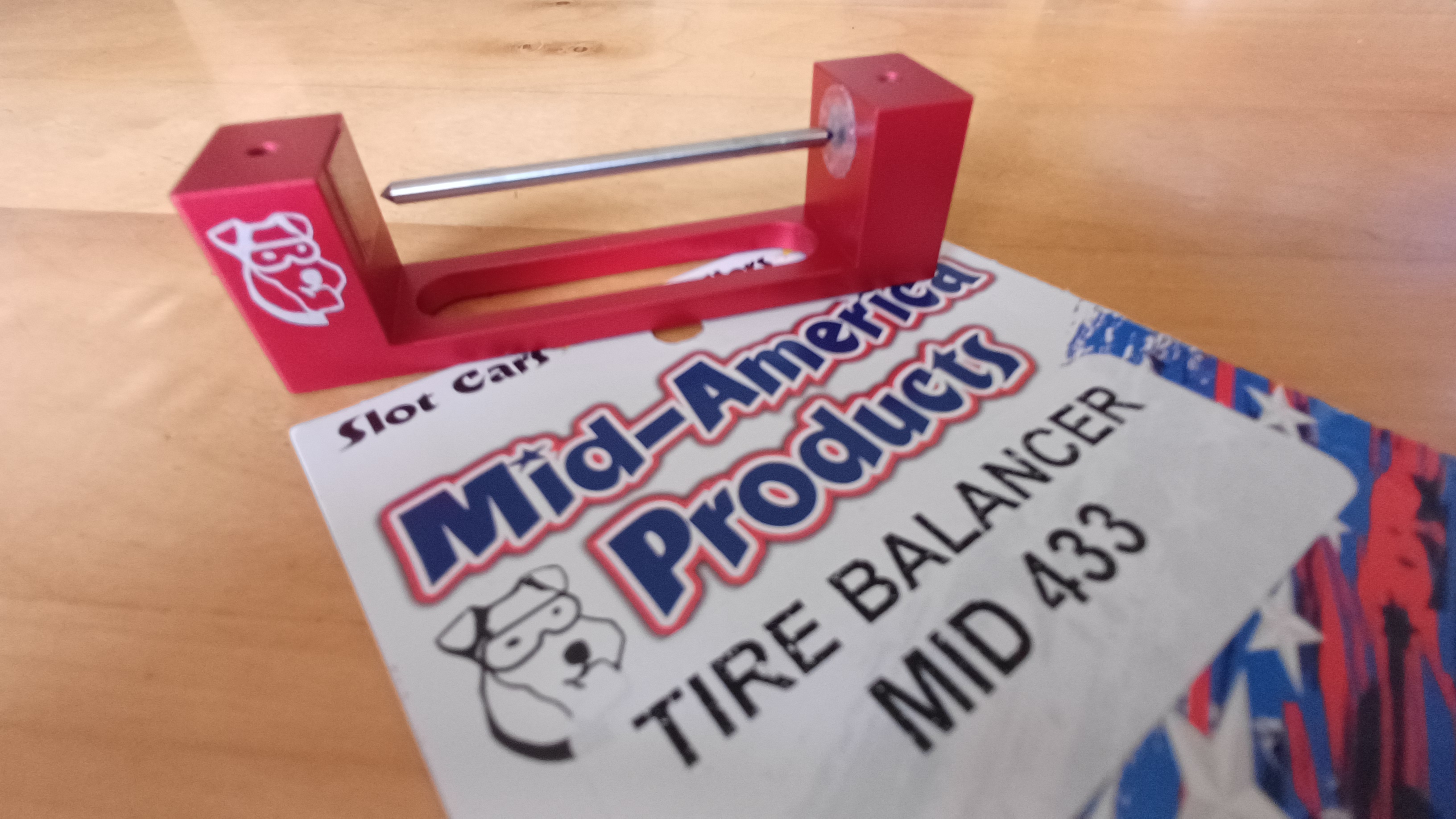

I blame you ARUP for the purchase of this bit of kit that I never realised I absolutely needed!
How could I have every built cars with out of balance axle assemblies?
Hopefully it will get used more than once!

Used it last night on one of my GT proxy cars. Really interesting learning experience and really makes you think about the mechanics of a slot car drive train.
Right now, I can't imagine not using it on all of my car builds. It's a simple exercise to load up each component onto the test axle and see how it spins.
Having a balanced drive train has got to be better than un-balanced one, so in this hobby of simple technology, I'll take every marginal gain I'm given.

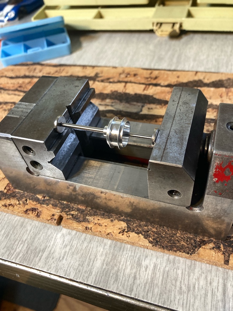

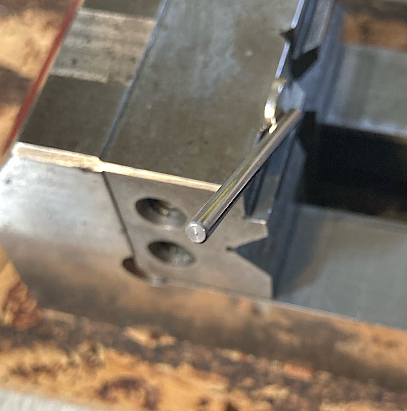

I happened across that Cleve vid on balancing too - it only made sense that at the scale speeds these things travel, any elimination of vibration would have to be a positive.
Had a small machinists vice I had made decades ago & it filled the bill nicely while also being .. you guessed it ; a vice. Useful for holding things.
On most any / all of the solid axles there is a tiny nub left from the parting off process in manufacturing, it's but just a few thousandths ( if done correctly ) but thats all thats needed to have it spin perfectly on center.
It really is apparent just how unbalanced a wheel is with even a shortened, hollow grub screw in place.
Have only used it once too, but balanced 4 wheel sets.
Like others I haven't really experienced lowered times I can quantify, but the car is just a bit quieter on track satisfying to a degree an obsessive nature of leaving no stone unturned.
