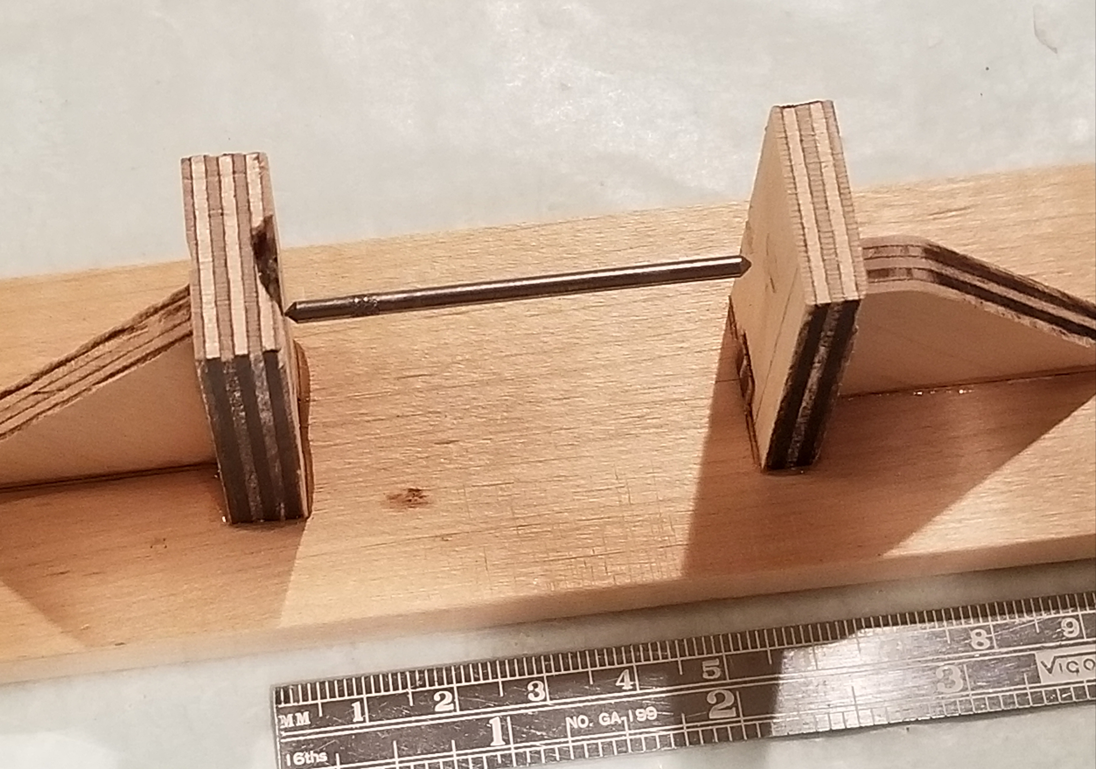

Wheel Balancer
           Home made using plywood. The uprights have magnets let into them. One end has a bit of glass over the magnet so the axle with a beveled end contacts it instead of bare magnet surface. When not in use the axle is stored in a pocket in one of the uprights. It works great to balance gears, too!

You balance by either removing material from the heavy side or adding weight to the light side.
I made one like is in this video by James Cleave who's a world championship finalist
Can you balance a wheel/tyre combo the same way? Where do you remove the mass from?
I love puttering with gears
Remove mass from where you can...if that's not possible then add tape to the light side.

For those intetested in 'rolling your own' (hah!) chuck an axle in your drill and while spinning use your Dremel with a cut off wheel to grind the point. This job turned in a lathe would be ideal.
