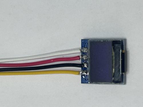

Here’s another installation.

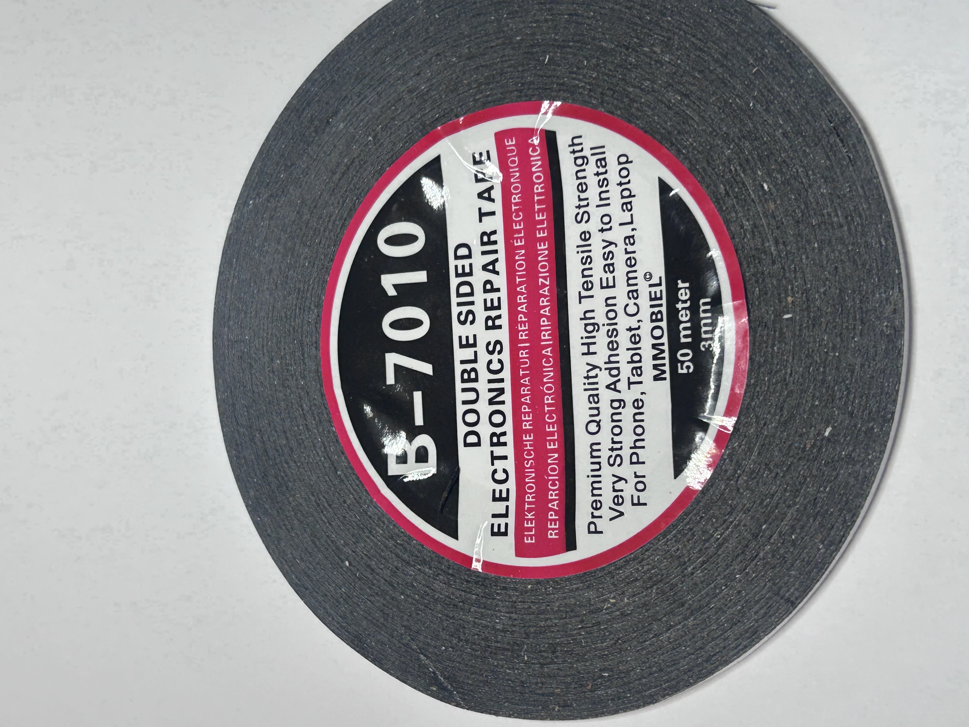

So I found some 3mm black double sided tape that is basically invisible once installed.

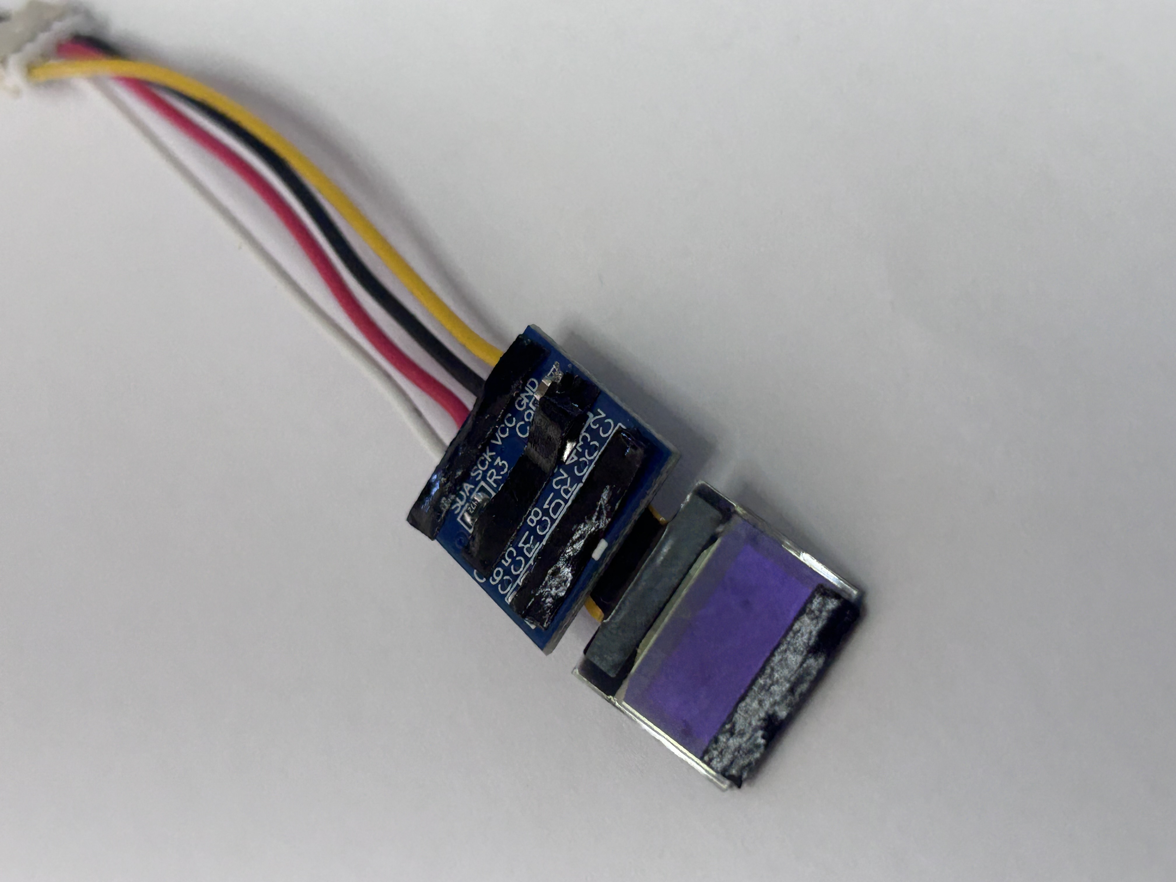

First we remove the double sided tape the factory uses to stick screen to board.
It then folds to any windscreen angle.
Here’s the tape.

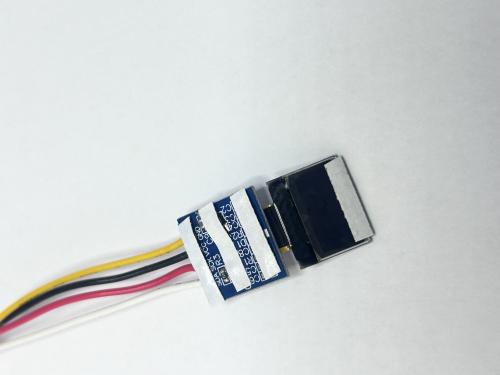

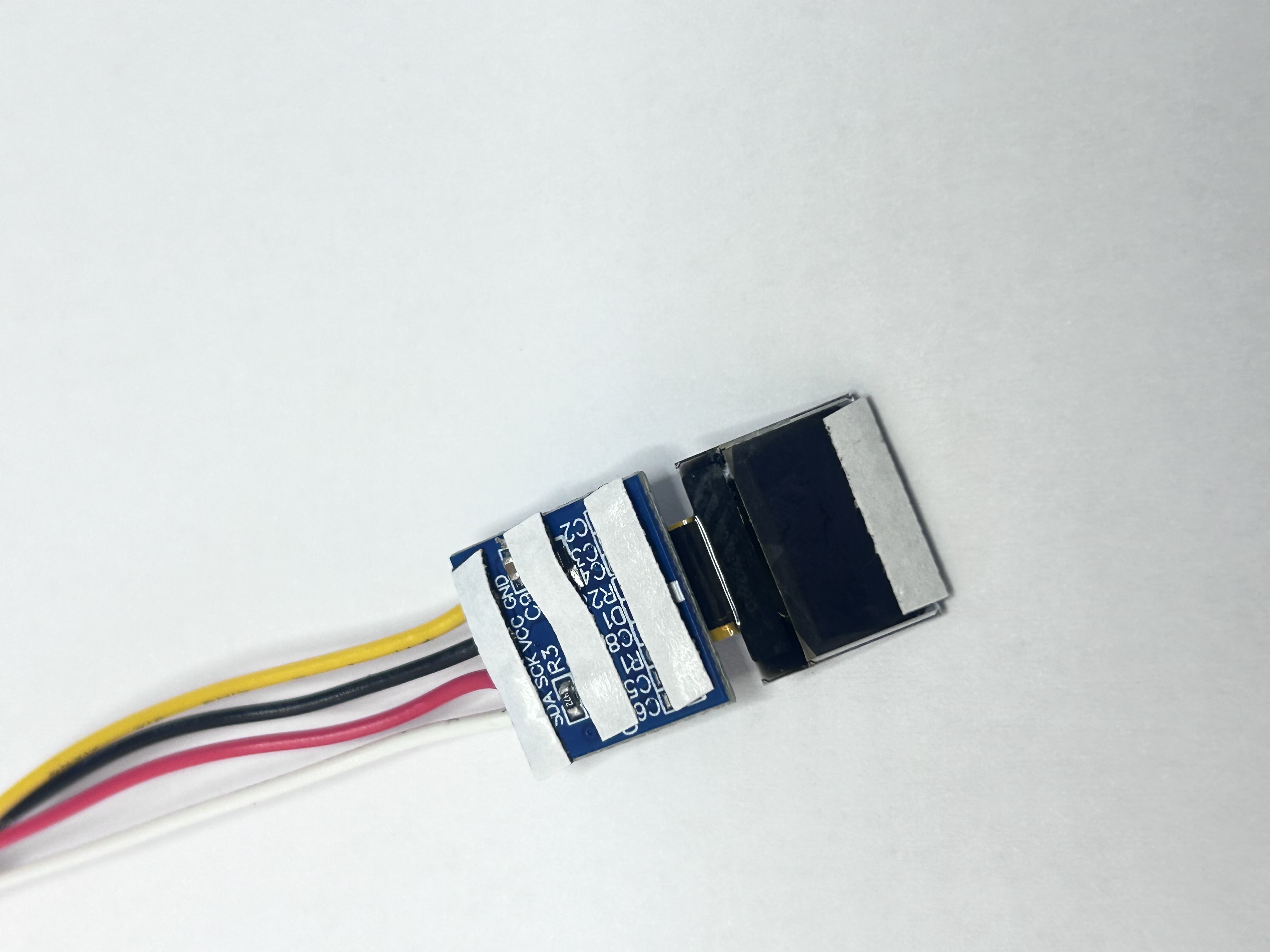

Next cut 4 strips and apply. 3 to the board, 1 or 2 to the screen.
Then remove backing.
Then attach to to body and windscreen.
Here’s the finished product. Perfectly to scale.

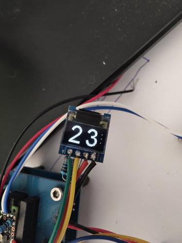

Here’s bunch to solder.
