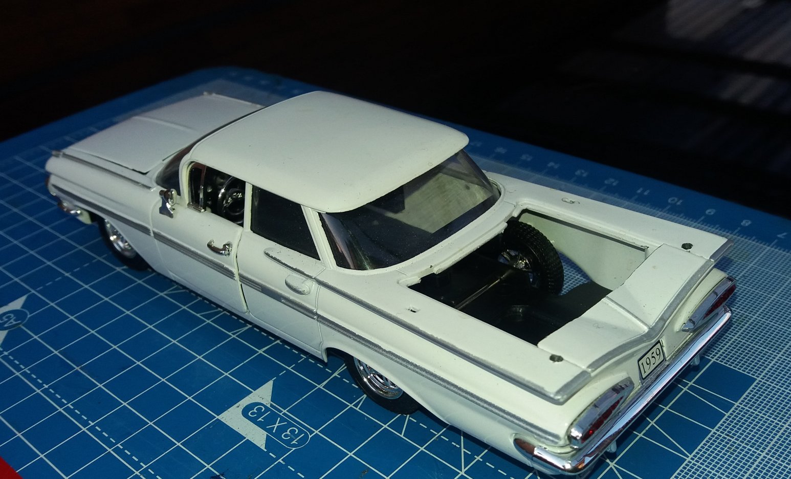

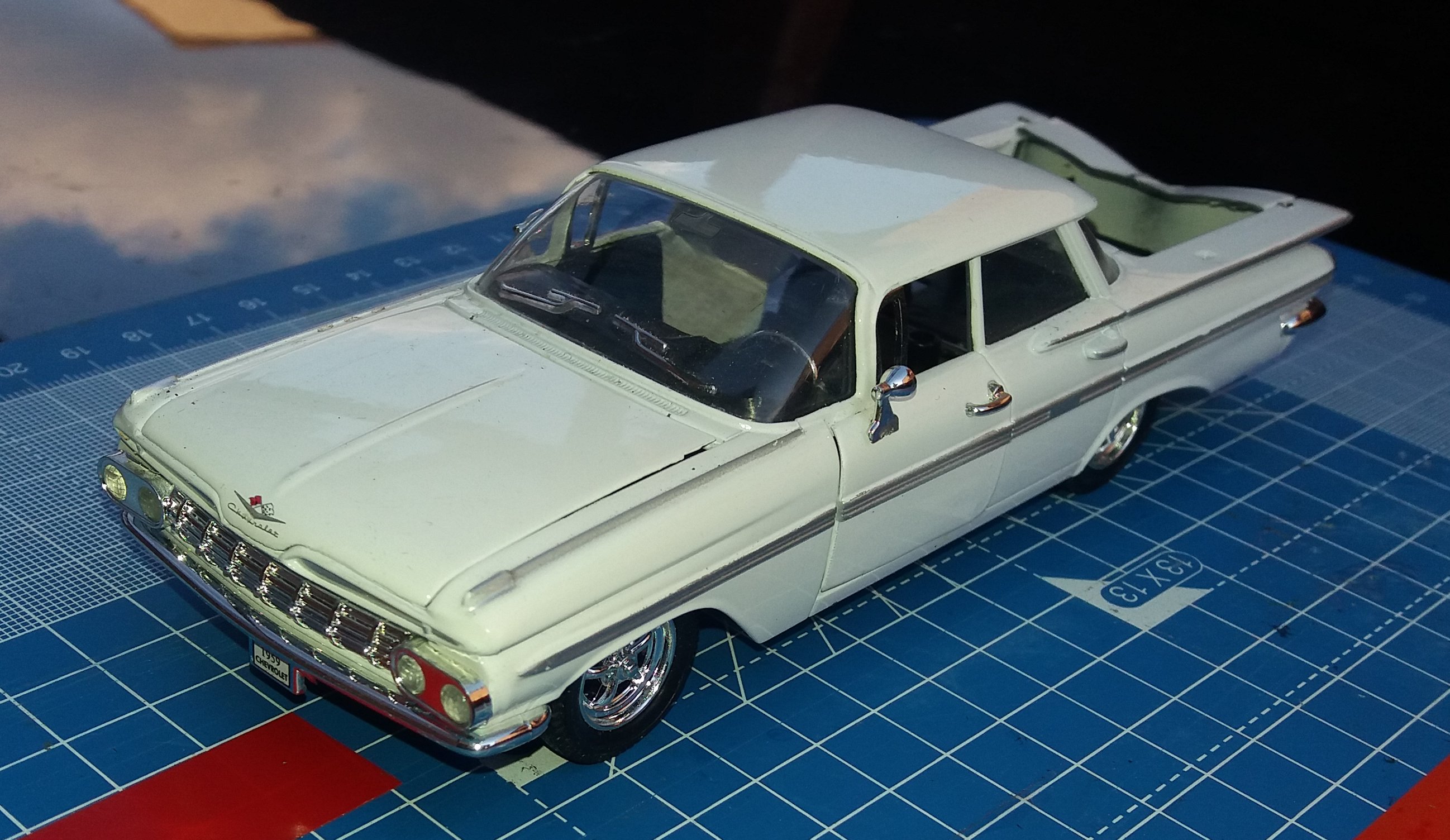

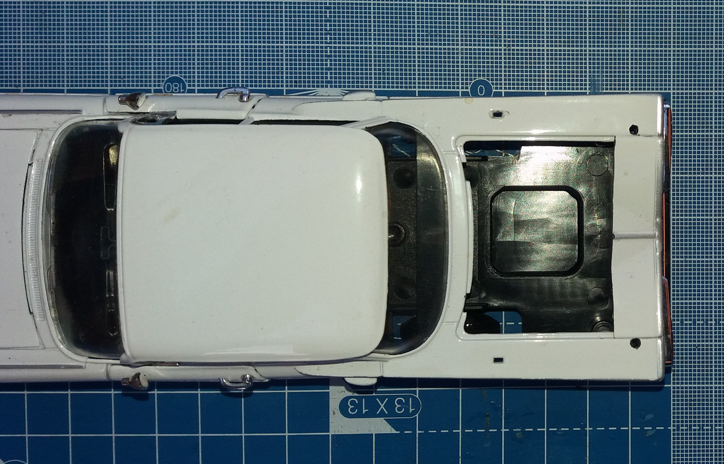

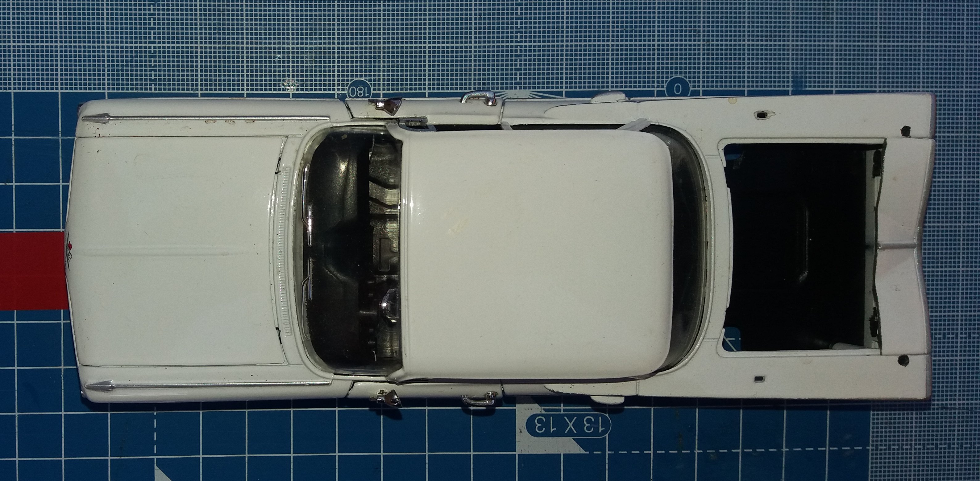

Impala is 170mm long, 60mm wide and about 47mm high. Wheelbase = 95mm.
Took the overhead shots with the lens over the front and then the rear so as to reduce any parallax error.
Have chopped the trunk lid in anticipation of creating the station wagon - I think I know where the off-cut is, will search for it shortly.
Its essentially the sedan version of the red coupe that Lloyd shows above.
Note the long rear overhang...

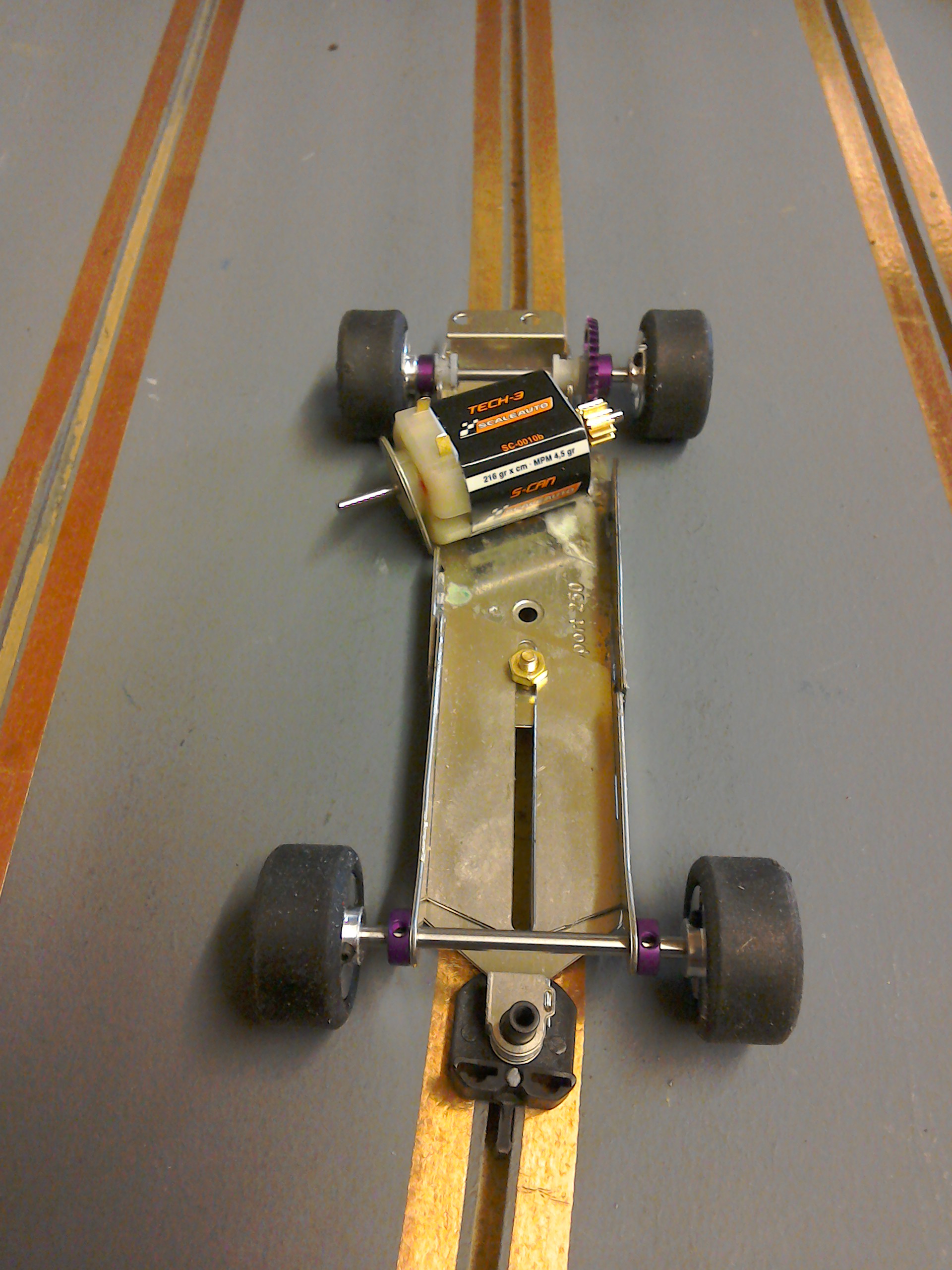

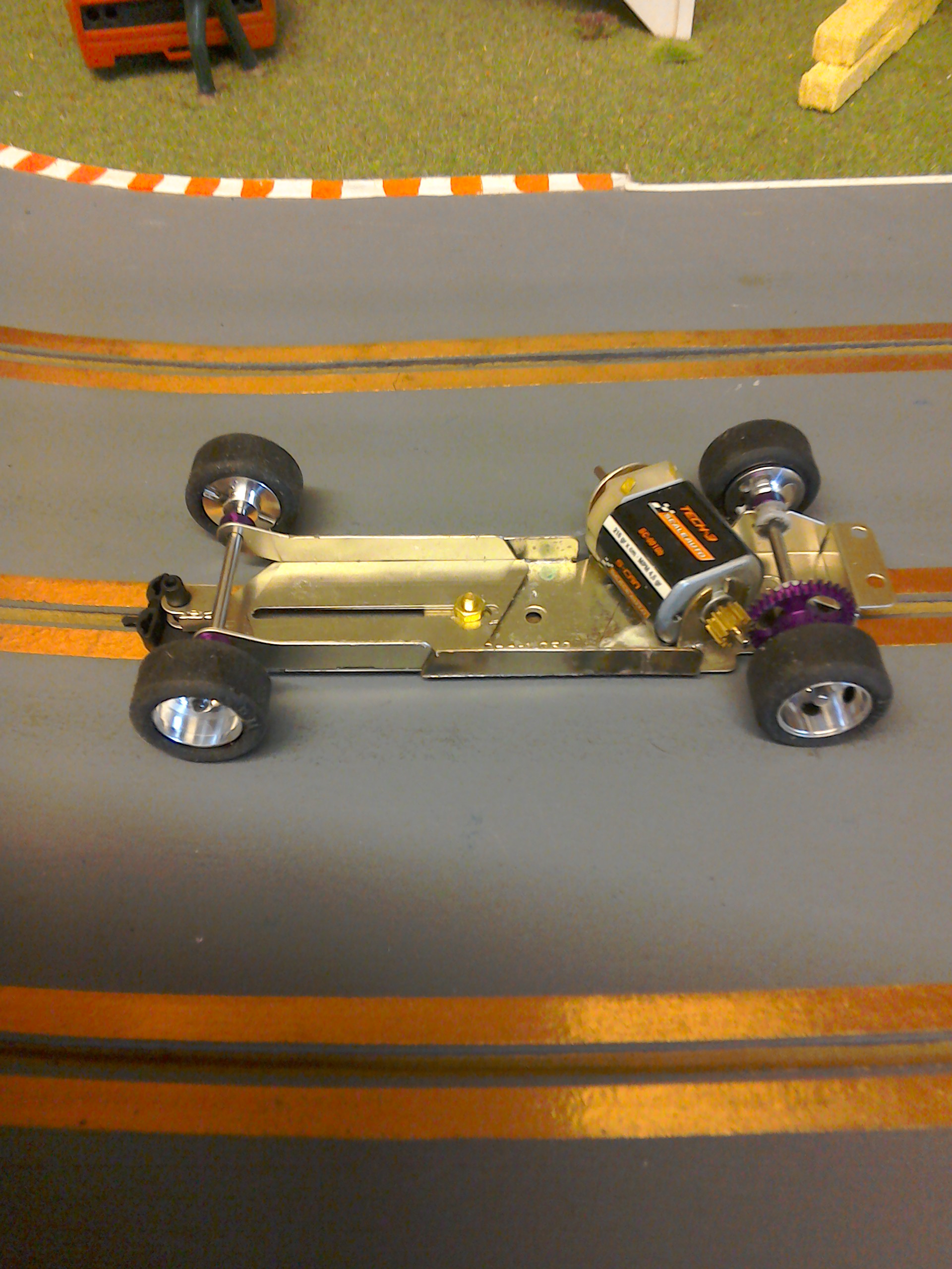

Done a little more to the Fairlane chassis ,a quick list of the parts , chassis is a psr wheels ,pinion aw gear , axles, stoppers are slot it ,tyres are Brm ,guide is scaleauto ,shou sh be able to give it a run tomorrow .As an aside , which icon do you use to like another post ?

Oh yes the motor is a 30 k scaleauto
