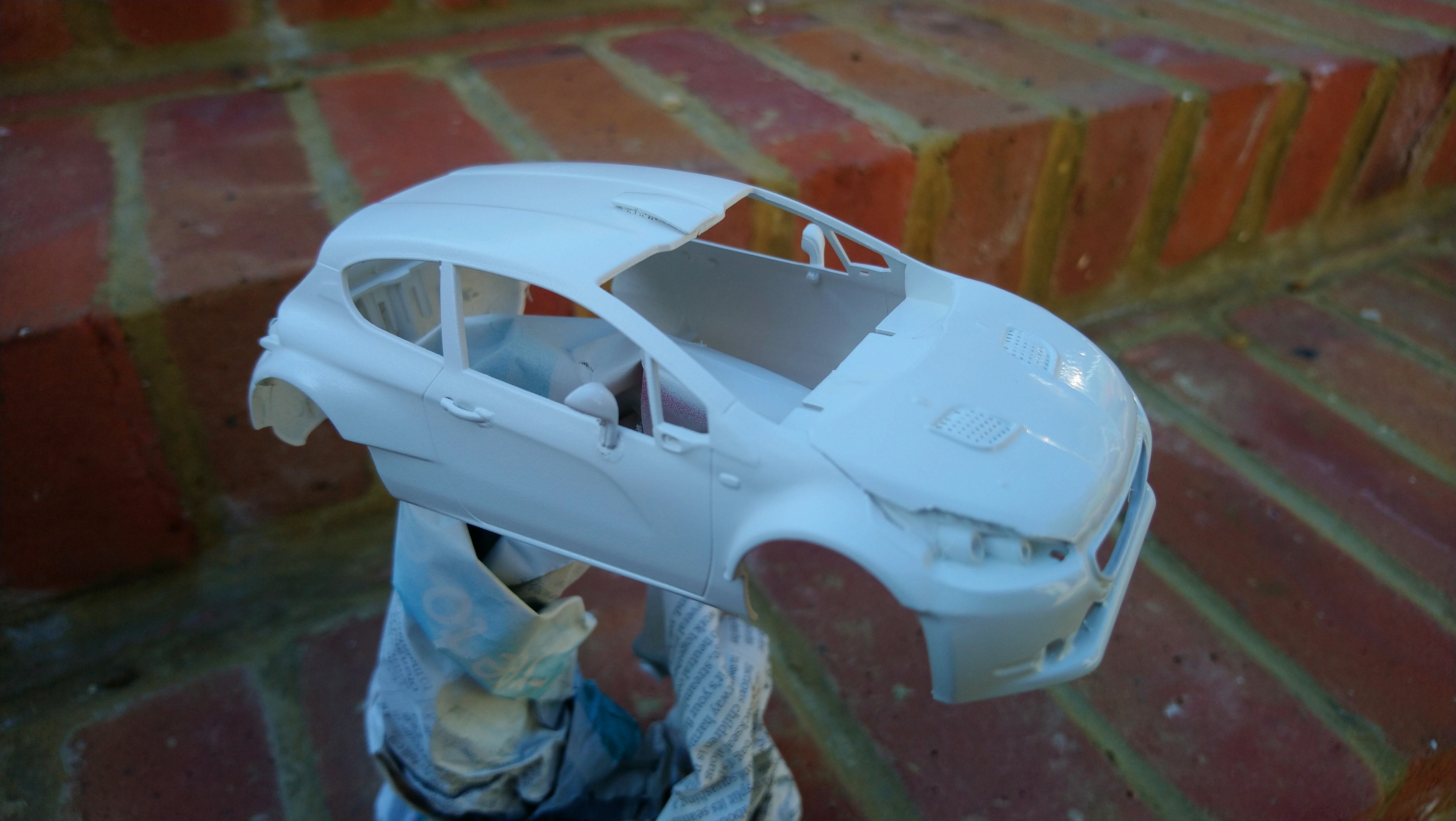

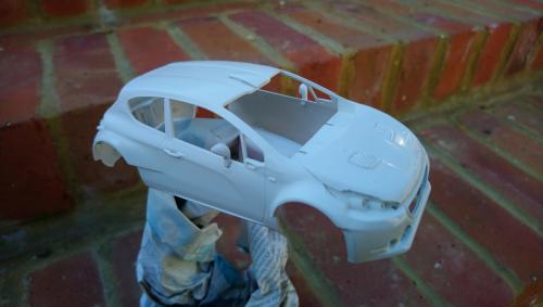

After I wrote it down, it sort of made sense and I could see all the problems with my other options.
Anyway, here is the body with three coats of Peugeot Bianco White...
White paint on a white primer,..probably not a great learning combination, but equally it probably hides all the imperfections!
And for the final coat, I put on a rubber glove to avoid what I now call "white hand syndrome" (or whatever colour you are using...)
So now I'm thinking that I need to leave it for four days and will apply the decals and clear coats on Sunday.

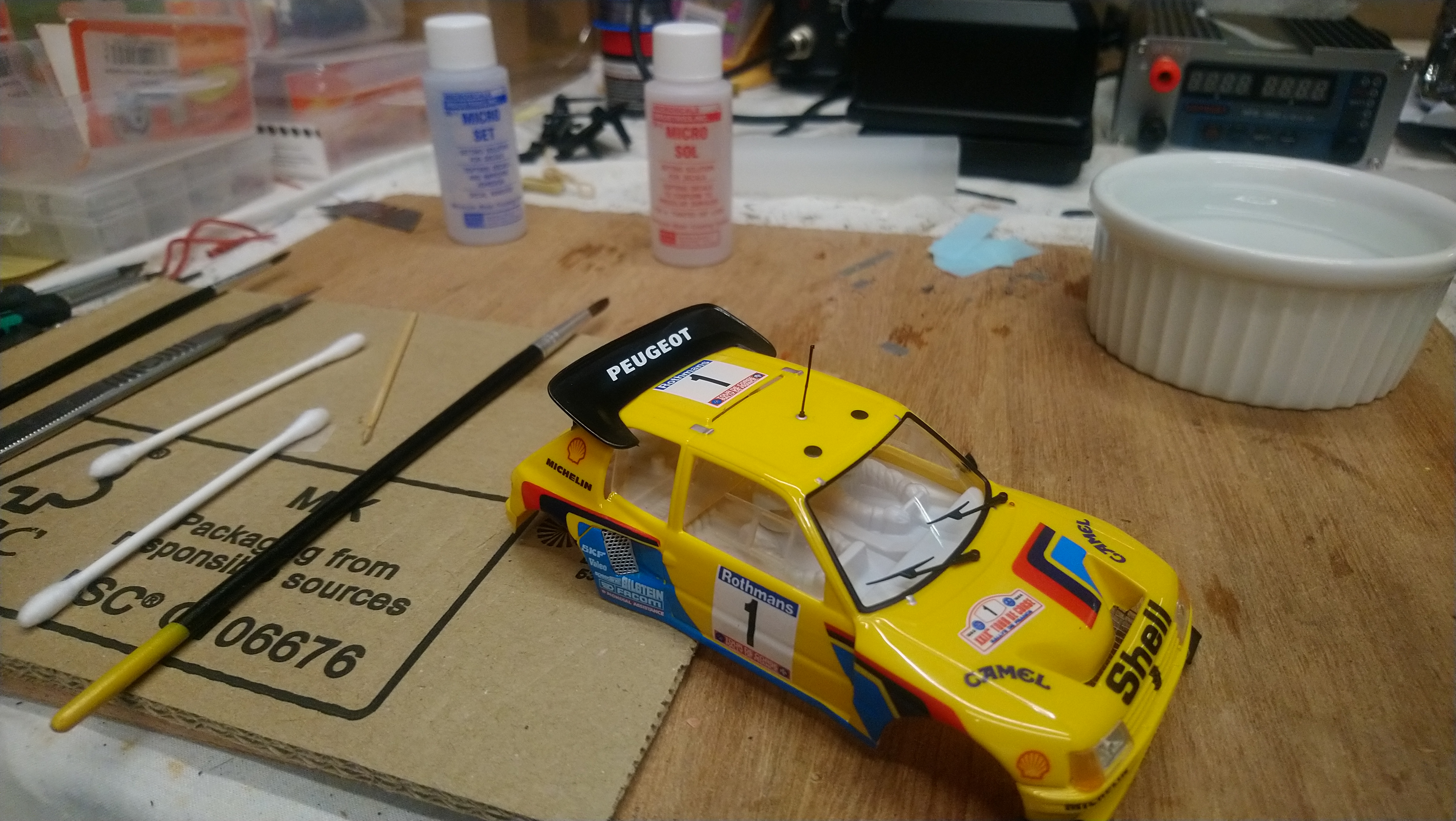

Practiced placing decals on this SRC Chrono 205. Seems strange to apply half in the factory and leave half for the slotter to do...
Anyhow, I've done some now, so feel more prepared to face the full car application on the 208.
I love puttering with gears

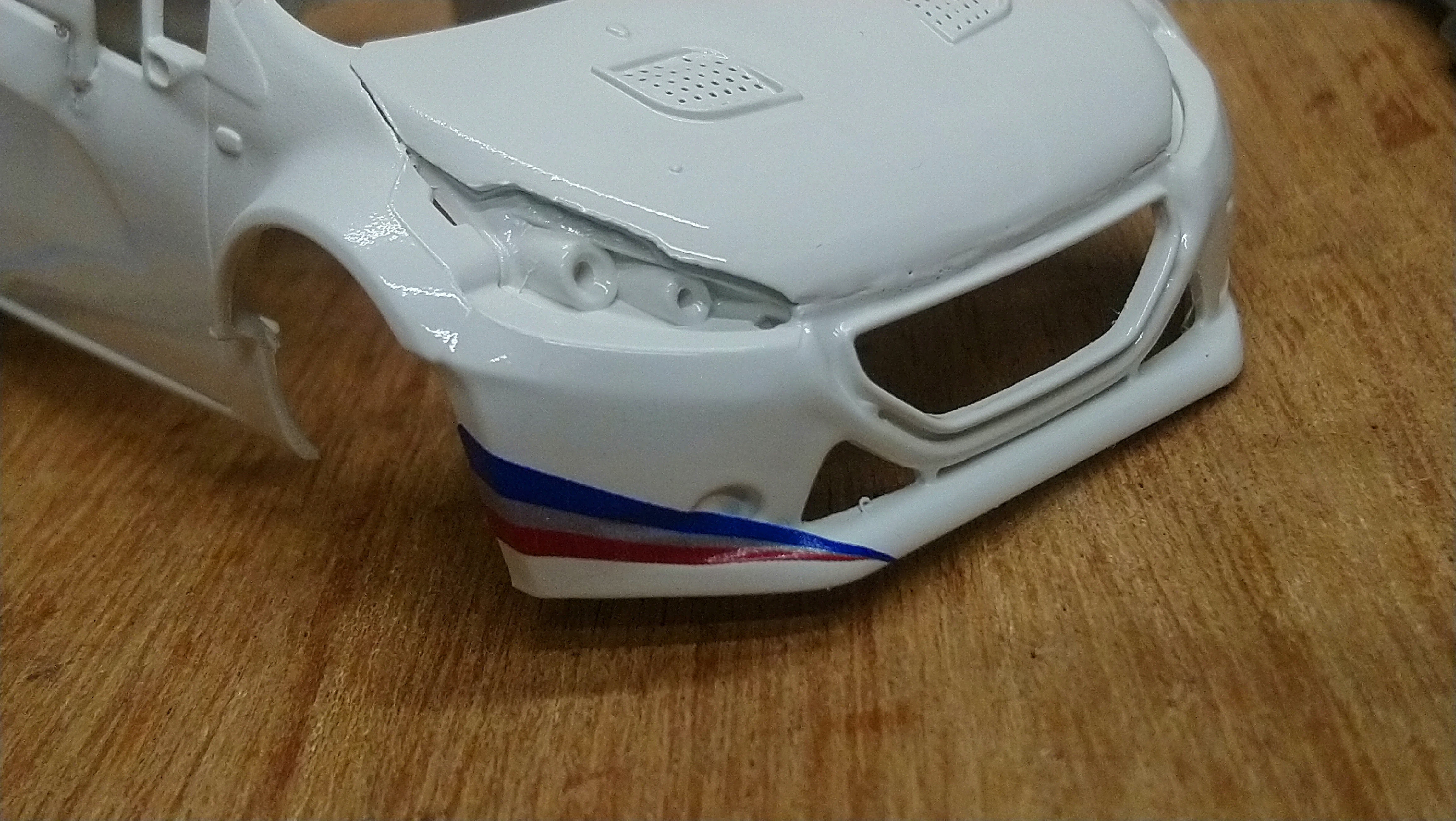

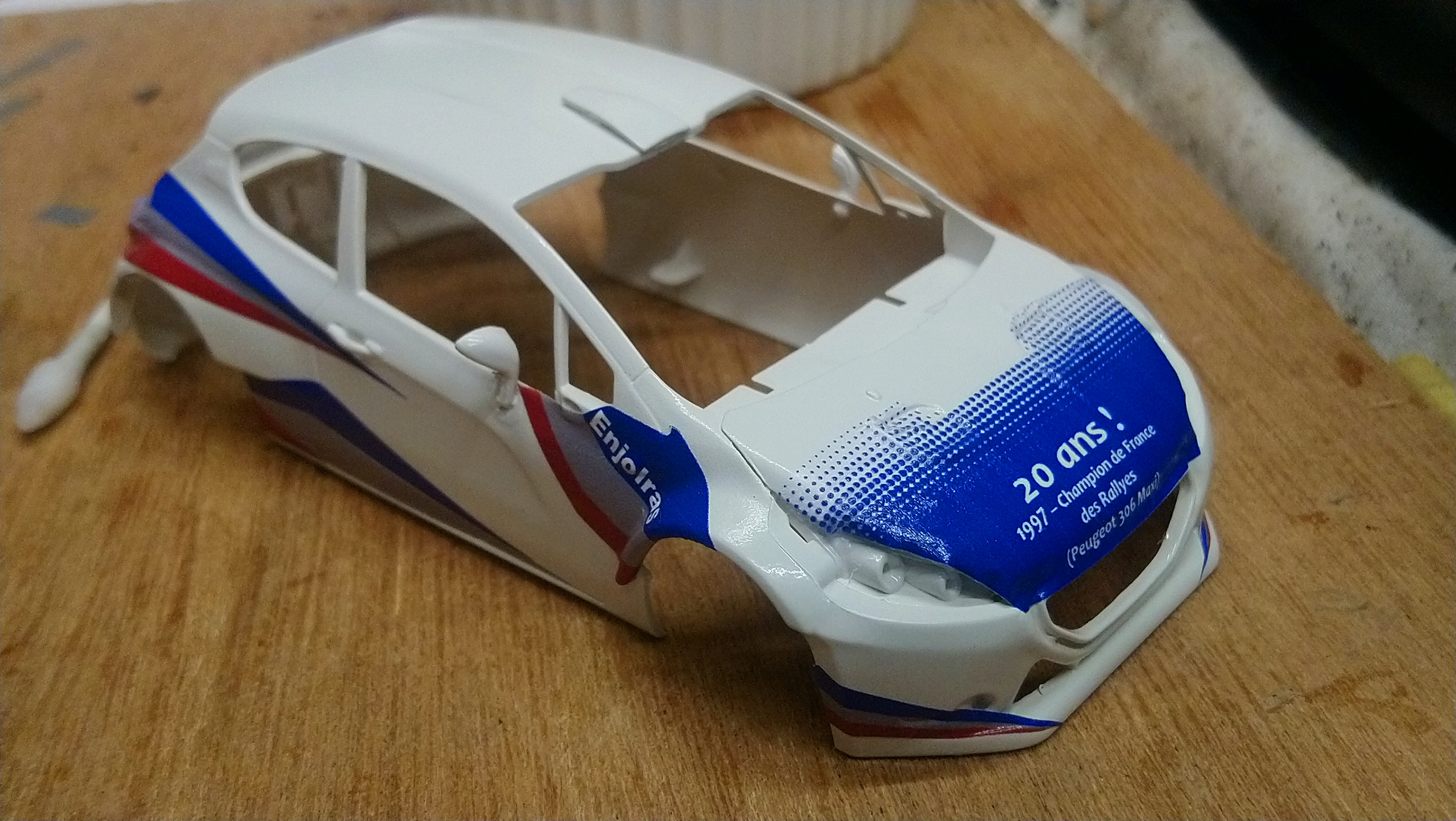

Blimey, this is stressful! I thought model making was meant to be relaxing!
First decal...
2hrs later, and it's time for a cuppa to relax my nerves!

Jeremy, If you run into issues getting the decals to conform to compound curves/creases/shut lines etc.,...........once you have the decal positioned and blotted, apply a thin coat of Micro Sol, and use a hair dryer with medium heat/medium air pressure to "melt" the decal. It will conform to compound curves and shut lines etc., and will look like it was painted on. modellers have been using this technique for eons with zero issues/great results.
Do not however touch the decal while you are "melting" it, nor for a few hours afterwards.
