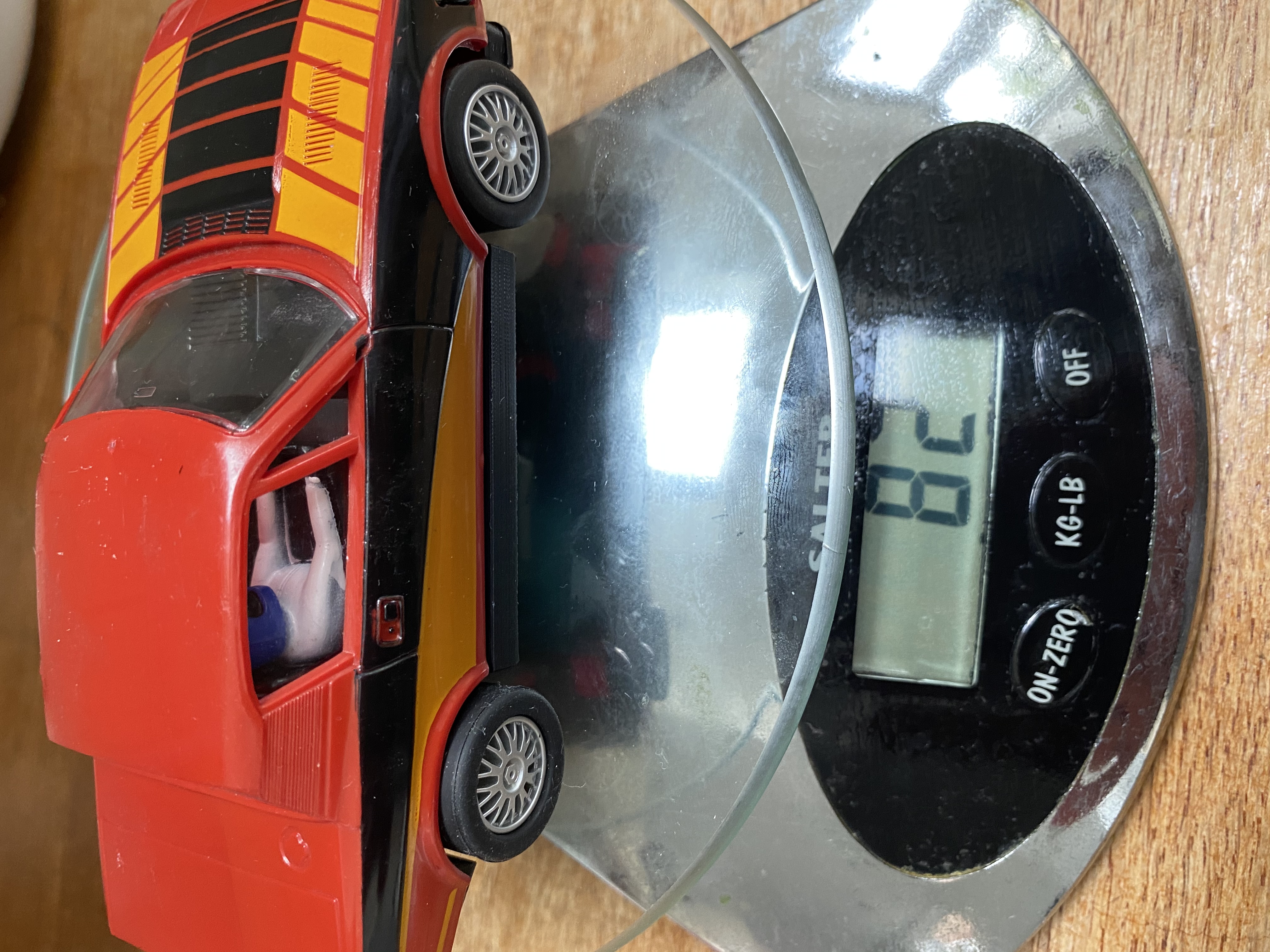

Hi
Pic of the underside of John Mays TR7 chassis as requested
Mine comes in a 82g with a short can motor and the BMW wheels
[+] 3 members Like 964rh's post
