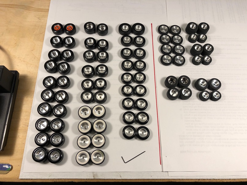

Here you go Bourne Again...... a vision of your future Rofl Rofl Rofl Rofl
There is another Unimat SL with milling head that doesn't fit onto my main bench..... Some would call me obsessive.... I call it "small collection"
