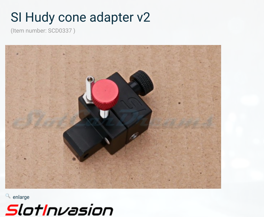

I found this on an Austrian website SCD...
If it allows you to put a camber to your tyres, then I want one!
Three questions: -
Is that what it does?
Any idea if they are still manufactured, as this is the only image of one I can find?
Does anyone have one to sell second hand?
Thank you.

do you have a 3d printer Jeremy ?
Camber adjustment HUDY by one_humanoid - Thingiverse
could be worth a shot m8

The article begins with "The HUDY tire truer has a little bit of adjustment to the camber of your tire, but not enough for the rubber tires we run on our BRM 1/24 cars."
For me. The Hudy has enough camber adjustment for urethane tires on a 1/24 scale tire. Just loosen the bolts holding the wheel cradle, give it a twist, and re-tighten it. It's all hand profiling beyond that.
Maybe foam and/or rubber tires are different?

I have my Hudy perfectly set up for parallel grinding...if i tweak it to do a camber, i will never get it parallel ever again!...
