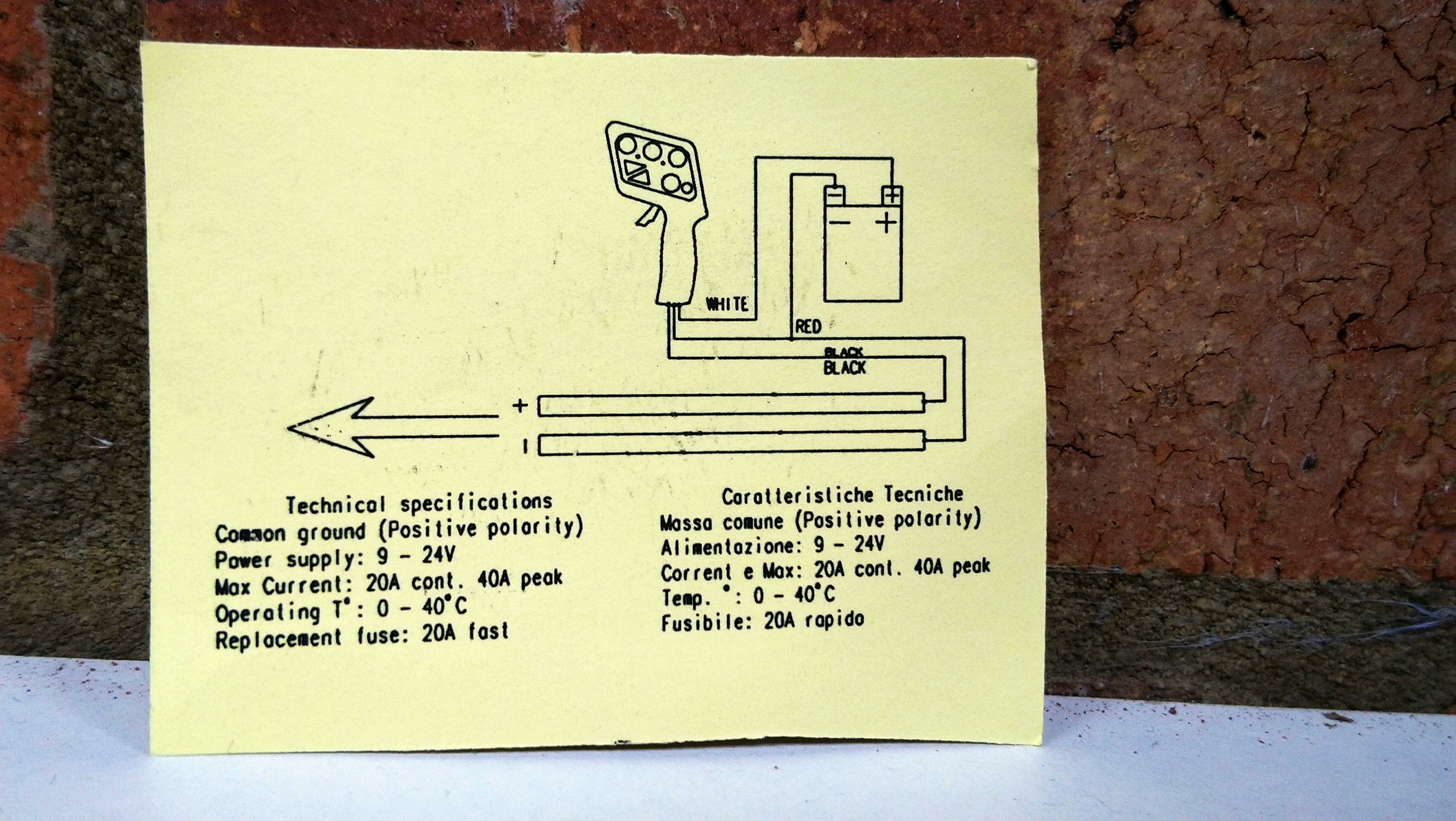

(7th-Mar-21, 04:56 PM)BARacer Wrote: Shall I just bite the bullet and get another handle so I can check if my current one is just duff, or are there any simple tests I can do with the current handle to see if it is faulty?
There are simple tests but you should write down what steps you are taking and only do one thing at a time to confirm operation. Without knowing which track you've wired up, I would start with making sure the wiring to/from the PS and track are correct. It sounds like you have 2 wires swapped.

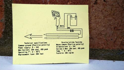

I followed this wiring diagram that came in the banana plug bag
I went by the colour of the bands on the three cartridge cables.
Thank you for your assistance DJP
Let's go...Off Road!
Posts: 285
Threads: 6
Likes Received: 356 in 152 posts
Likes Given: 200
Joined: Jul 2020
That diagram looks good, and it's how I have my Carrera track wired - Positive Polarity.
At this point, you need to determine if the Cartridge is dead.
If after turning on the power (with the controller connected as per the diagram, and no car on the track) the LED does not light Green then something went wrong. My analog cartridge has 2 glass fuses in it. I've never seen the cartridge you're working with. Take the fuse out and check it with a digital multimeter for continuity - it may look good but might not be. Only replace it with the same.
