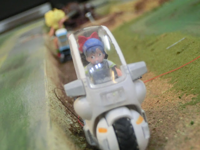

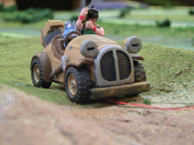

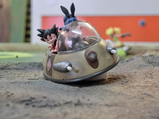

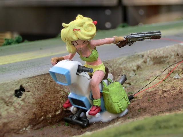

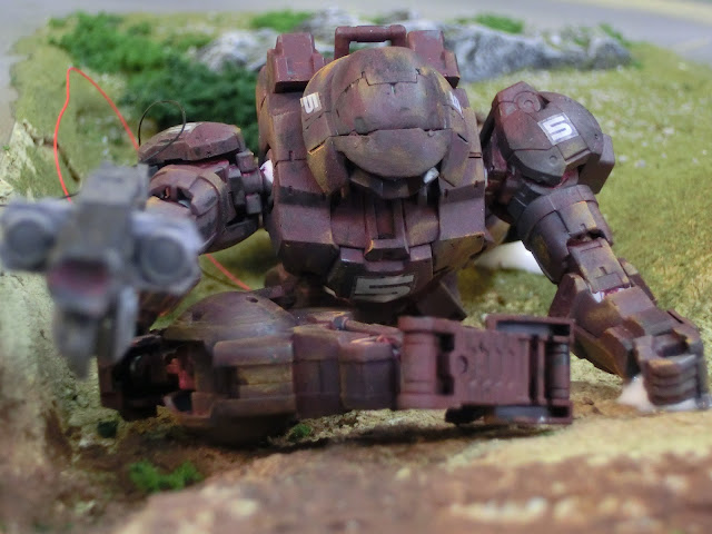

Some more baby steps in the track progress.  I have now finished up the models for the scenery.  Next to wire them into the control unit so that they can signify completed laps and fastest lap.  Once the wiring is done I can quickly finish the scenery and start some racing.
[Image: CIMG2751.JPG]
[Image: CIMG2752.JPG]
[Image: CIMG2755.JPG]
[Image: CIMG2756.JPG]
[Image: CIMG2759.JPG]
[Image: CIMG2757.JPG]
Unfortunately I was way too far into these before I thought about actually learning to paint - and subsequently that the paints I was using were terrible for painting miniatures.  I have since started watching a bunch of videos from a very talented miniature painter, made some purchases and have some plans for progressing the big track  Cool  Worth checking out if you like miniatures and scenery.  Squidmar Miniature Painting.

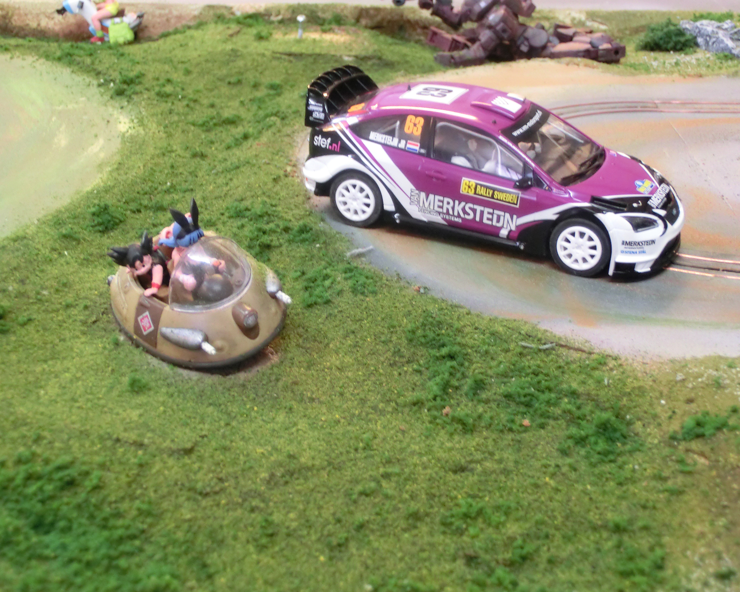

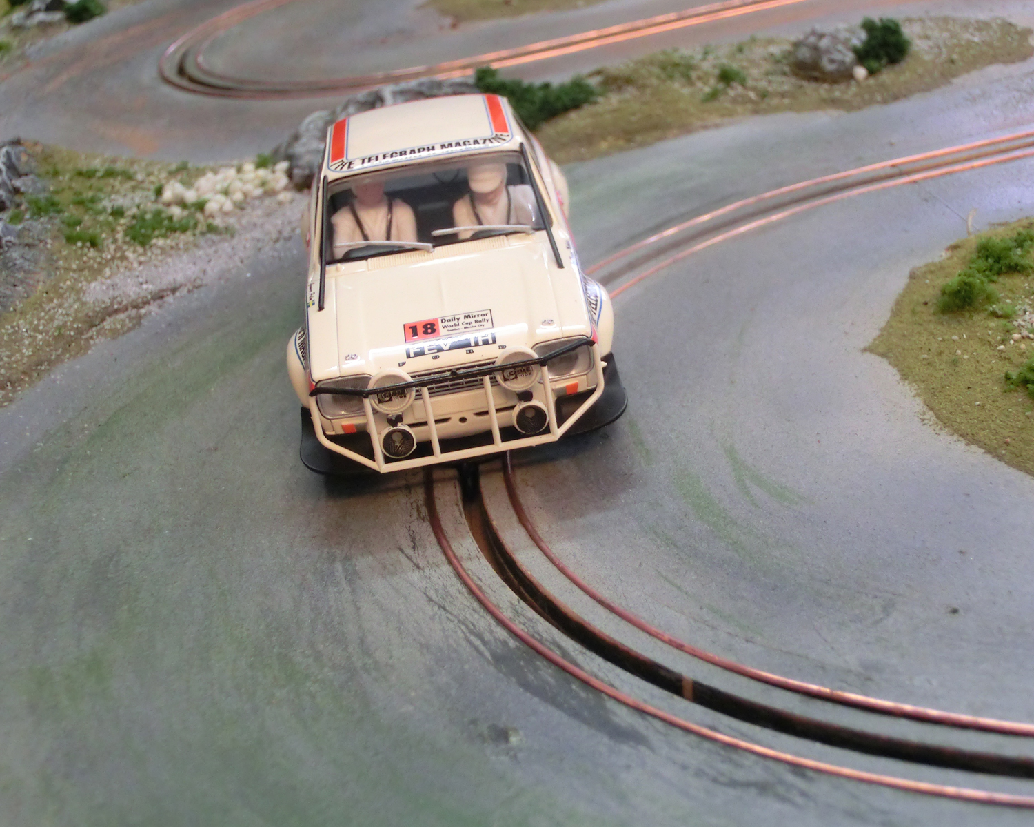

Finished for now - at least to a level where I can kick back and just enjoy it for a while.
[Image: new%2Btrack1.jpg]
Landscaping will continue to progress and get more details filled in, but mainly now will just continue to run the track to wear it in.
[Image: new%2Btrack3.jpg]
Main items left to do as improvements...  The track sensor can be a pain in the ar$e.  It is currently a photo gate and generally very good and reliable.  But if you have lifted the track or transported it and it needs adjustment, well my adjustment screws are on the underside of the track, so a pain to get to and adjust.  I plan to fit a plate under the sensor to raise and lower it using screws from the track surface on the start/finish line.  These will get covered with some scale cones.
