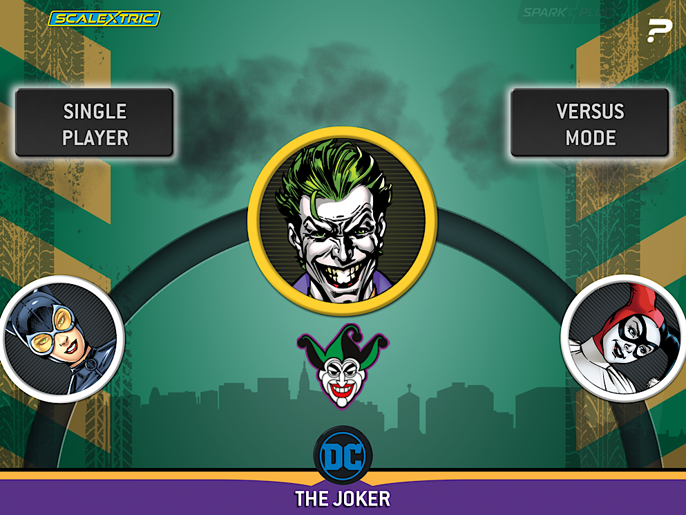

A new version of the app was released today with the option of the original Spark Plug look or the DC Comics version to coincide with the release of the Batman vs Joker Spark Plug set...
Functionality should be the same - I will have to find time for a play to see if there are any improvements or tweaks to how the app works.

There are plenty of ways you can customise the app, all of them accessed via the main menu...
And there is one alternative 'skin'...
