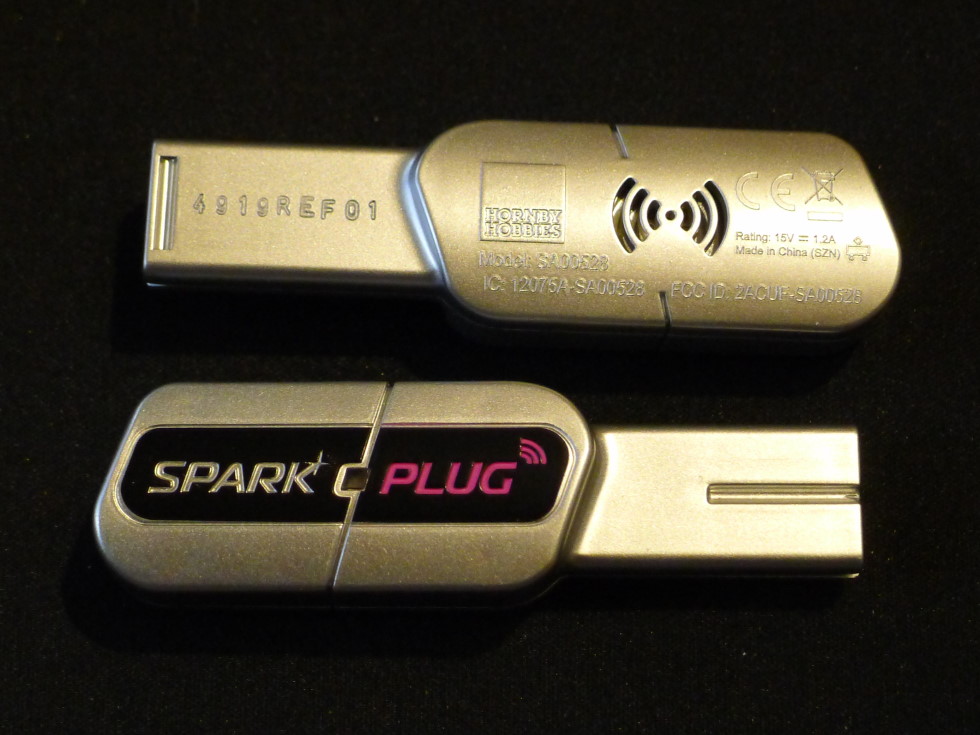

Scalextric's Spark Plug is a neat new gizmo that turns an Apple or Android smart device into a wireless controller. It looks like this...
[attachment=5659]

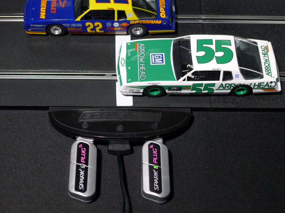

It plugs into the controller socket on the current version of the basic Scalextric analogue powerbase - the ones using the chunky plastic rectangular plugs...
[attachment=5661]

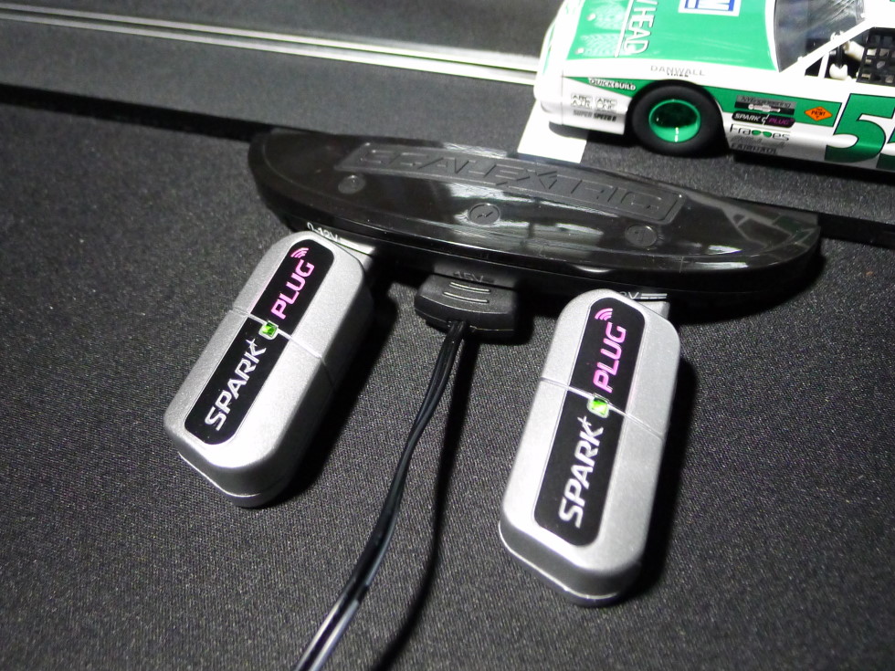

Spark Plug runs with the standard Scalextric analogue power supply (P9400) plugged into the base and a combination of Spark Plugs and standard analogue controllers can be used together.
When you plug in a Spark Plug and the power supply, nothing happens until you place a car on the track - the dongle recognises the car (the wheels spin if you hold the rear off the track) and the green LED on the dongle flashes...

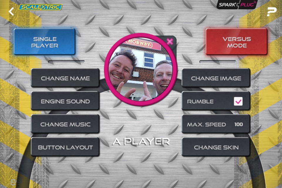

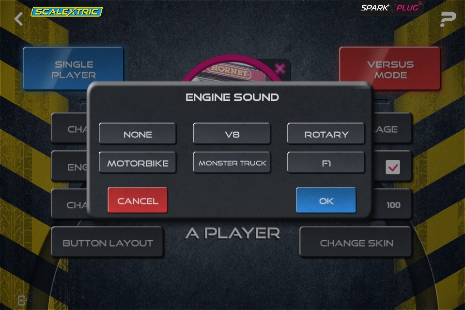

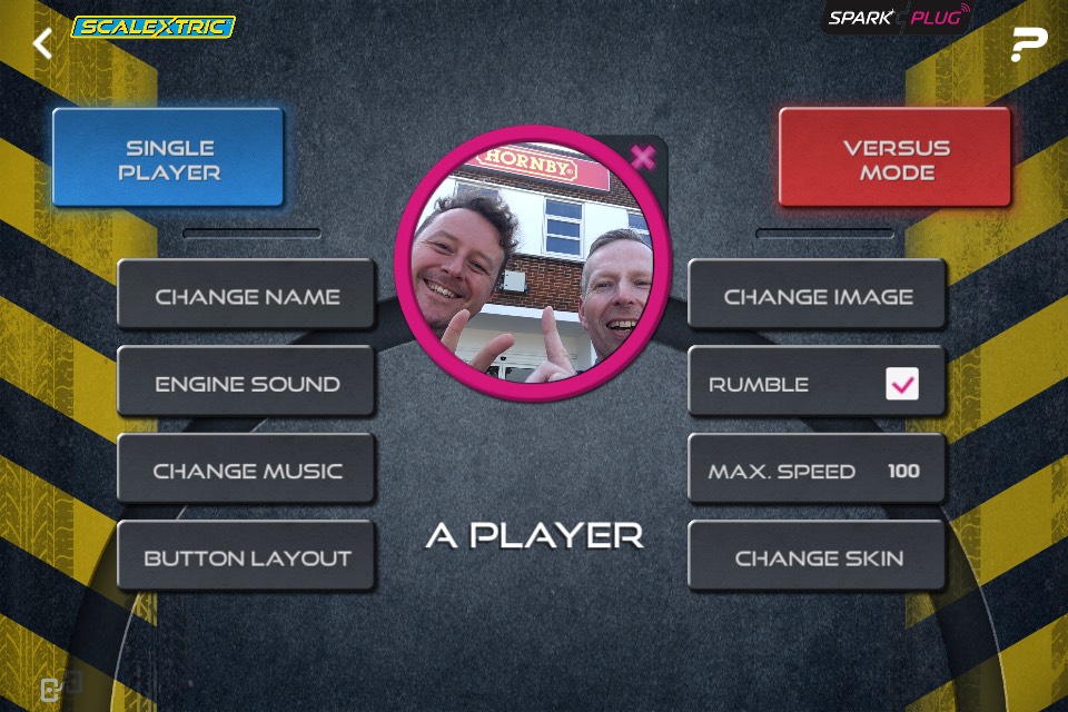

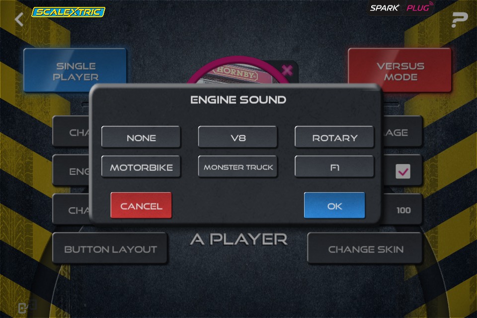

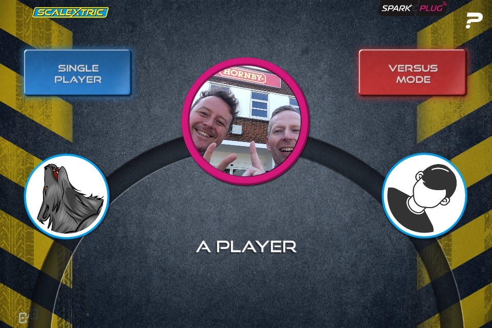

There are plenty of ways you can customise the app, all of them accessed via the main menu...
[attachment=5651] [attachment=5653]

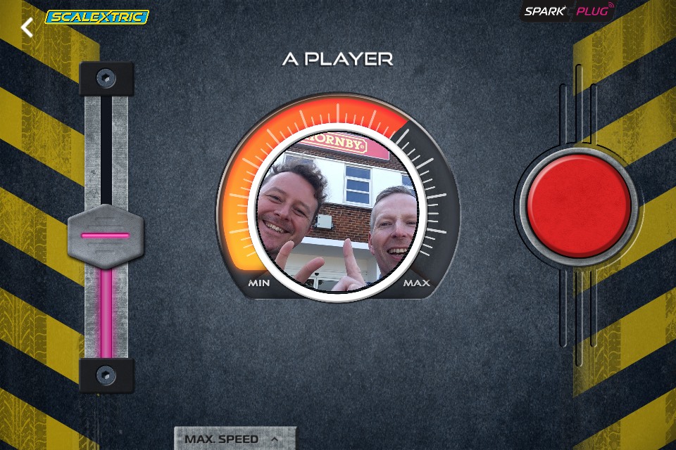

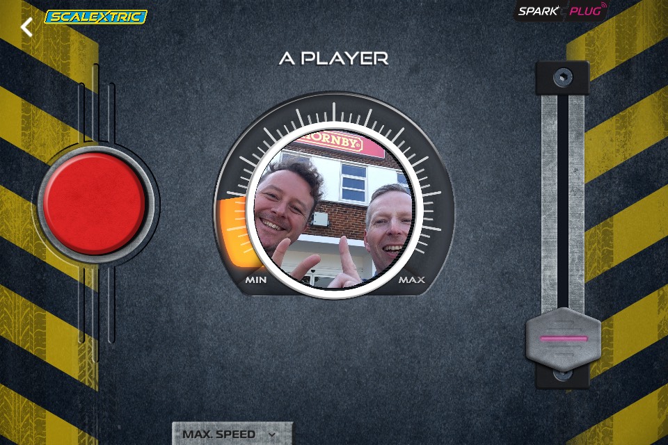

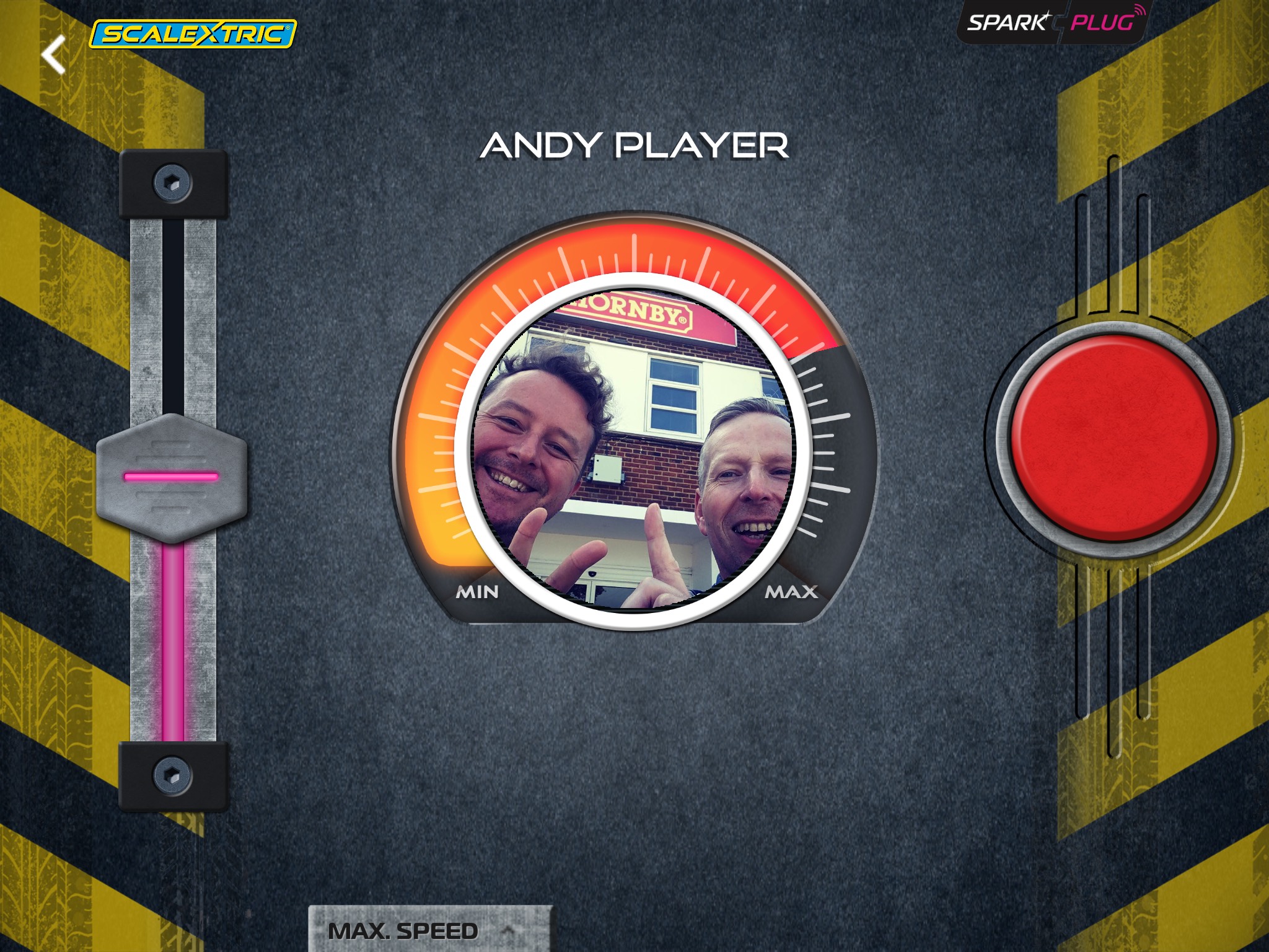

But the most important thing is how the Spark Plug works. This is the main screen in standard 'Single' player mode...
[attachment=5645] [attachment=5648]
On the left is a throttle slider and on the right a brake button. The slider drops back down to zero if you lift your finger off it, the braking effect depends how long you press the button for. The picture on the left is with the car slowed slightly with the brake - on the right it is slowed with the throttle. For those of us who have many decades of using a standard controller, it takes time and effort to get used to.
In fact, I've found it takes a completely different way of driving - instead of lifting off the throttle going into a corner, I dab the brakes (or step on them hard for a hairpin). It's not unlike using a race simulator or video racing game - and very similar to digital slot car racing using programmes like RCS64 with dynamic braking turned-off (which is how we race at WHO/digital). Essentially, it is left-foot braking a slot car using a smart device. Or it would be, if you change the screen round to the 'left-handed' setting, which - as a right-hander - I found slightly more intuitive...

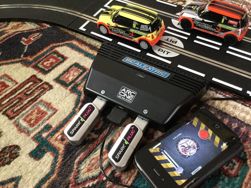

[attachment=5658]

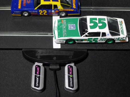

This was made quite simple by the fact that Spark Plug works with the basic ARC One powerbase. The controller sockets are the right ones and the various Bluetooth connections did not interfere with each other. I set up the simple rug-racing track with the Scalextric Mini Cooper S cars (with magnets) that I use for public events (see
here). I chose this set-up because it's how Spark Plug will be used by most people.
With a standard 'traditional' Scalextric controller I managed a pretty quick best lap time of 1.64 seconds. With the Spark Plug app on my 4-inch iPhone screen, I got down to 1.87 seconds, which wasn't bad. I then swapped devices and used Spark Plug with my 9.7-inch iPad - taking exactly a tenth of a second off my best on the phone - 1.77 seconds. Maybe it was because the controls were bigger?

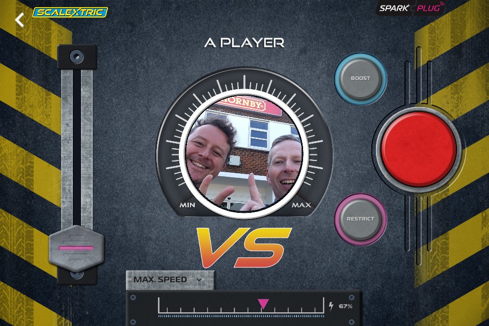

At the bottom of the screen is a button with Max Speed on it. This opens up a menu to set the power from 10 to 100% - ideal for beginners learning how to race. And it also gives more 'sensitivity' across the throttle range - especially useful on a slower, technical circuit. The Max Speed menu can be accessed from the main menu or from the race screen, which is ideal. Another 'learning aid' that is due with the next update of the app is an in-game option that penalises crashes and rewards drivers who stay on the track. It's a great way of training new slot car racers while have lots of fun...

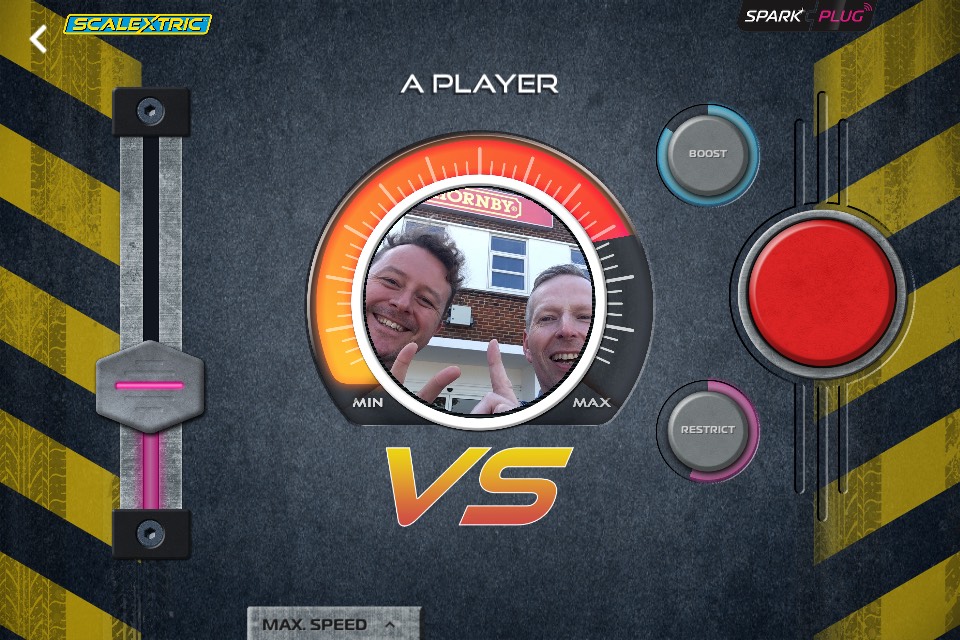

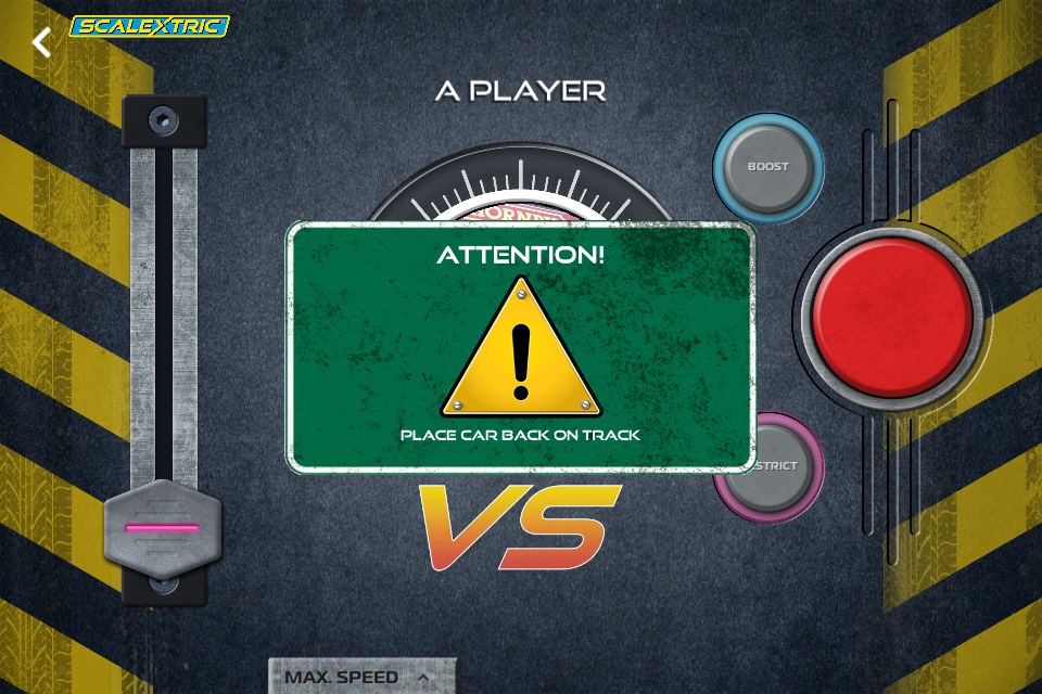

Speaking of fun, the two-player Versus mode provides some riotous enjoyment. Added to the race screen are Boost and Resistrict buttons. Each lasts ten seconds and then recharges more slowly (Restrict taking the longest). Boost increases your own speed significantly - quite alarmingly, in fact. Restrict reduces your opponent's speed to a crawl. Pushing Boost to counter-act Restrict does work, but you really must count down the ten seconds - otherwise the power surge after the Restrict ends will definitely put your car in the scenery!
If you car is off the track for a while (lost in the scenery) or you replace it on the wrong lane, Spark Plug will tell you...

My permanent layout is Ninco track so I had already formed a plan to connect the Scalextric power base in via the controller socket. I did that and ... I had control. Following Andy's above recommendation to set the config to left handed and setting the max-speed to about 50% I set off using a car that was handy - Team Slot Lancia Delta S4. I managed a couple of slow laps without de-slotting but realised that the quirky handling and powerful motor of the Delta was not a wise choice for this new venture. Scalextric Ford RS200 are quite forgiving and sure enough I was soon only de-slotting occasionally. The de-slotting was of course down to my unfamiliarity with the controls. After several more laps including some good ones I fired up the Race Coordinator computer for timing. 16 seconds is a fair lap target that I challenge visitors with so I hoped to match that. With a decent car I can get down to 13 seconds and about 11 if magnet assisted. After several laps I managed a 19.3 with the RS200 and called it a day.
I found that I was coasting in to the bends due to the lack of dynamic braking and the slowness of moving my thumb on the slider meant that I couldn't manage to pulse the power in the bends. I was using a Lenovo 110mm (diagonal) screen.
