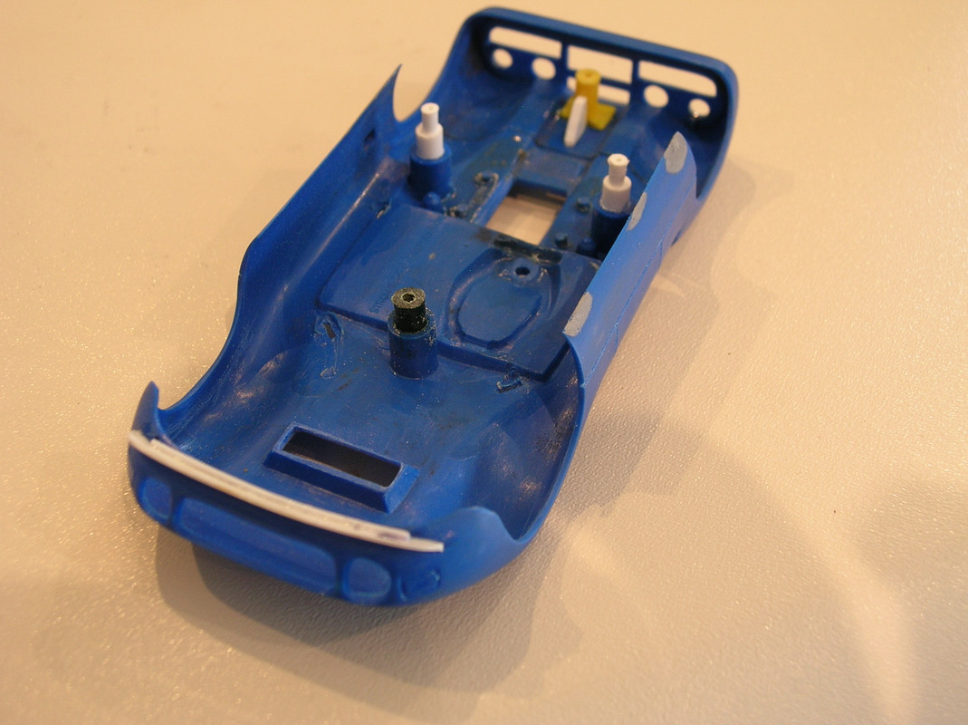

I got a tiny bit more done...........I am working on a few cars at the moment, so, progress is slow.
I installed the body posts............I used the stock front body post location, and only had to install a styrene post from the body post "collection". I did have to create a new position for the rear post, and again used a post from the "collection"
As luck would have it the stock side post locations aligned with the side pans on my chassis, so, by installing some telescoping tubing I can trim these to control body rock.
[Image: DSCN4581.jpg]
I did finish the wheels and inserts, and trimmed the body posts to achieve the ride height...........by scouring google "images" it appears to be correct.
