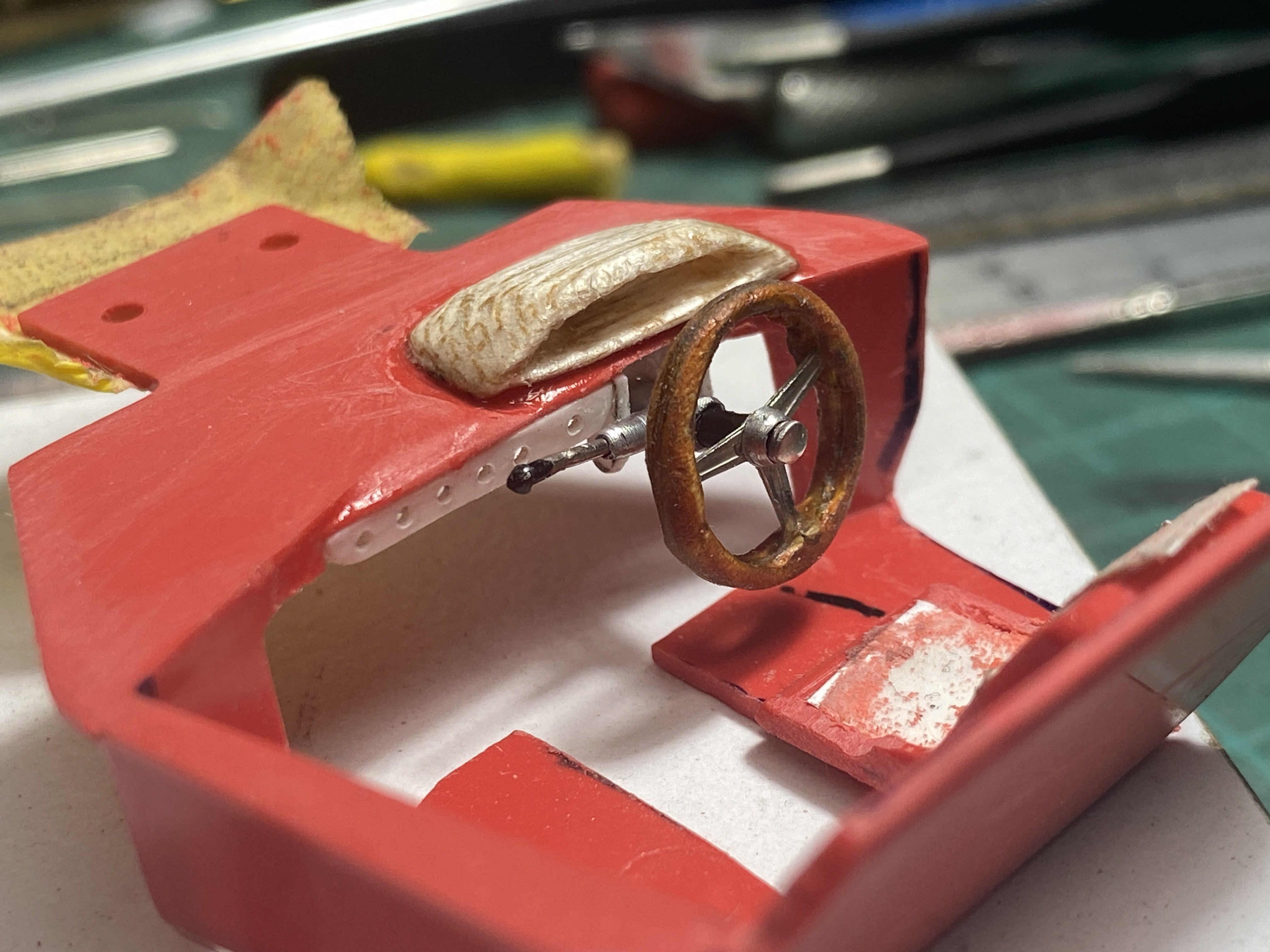

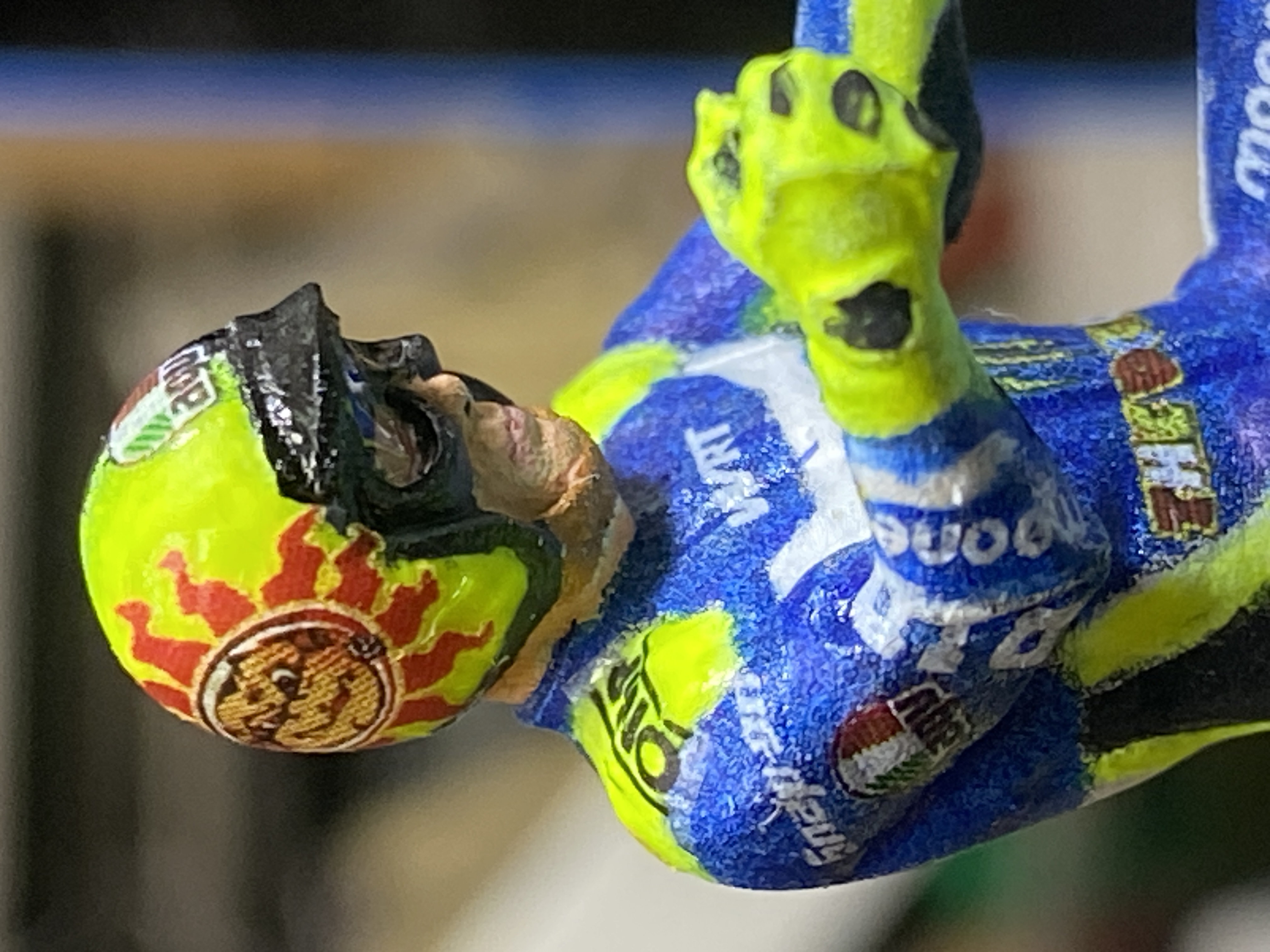

I've got the driver painted up and cut and moved his arm so he's sort of waving out the window, the dash is all scratch built and steering column and gear leaver.

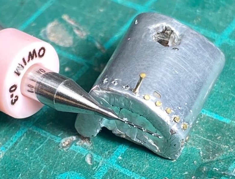

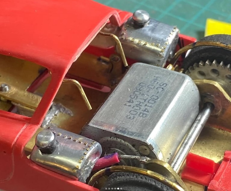

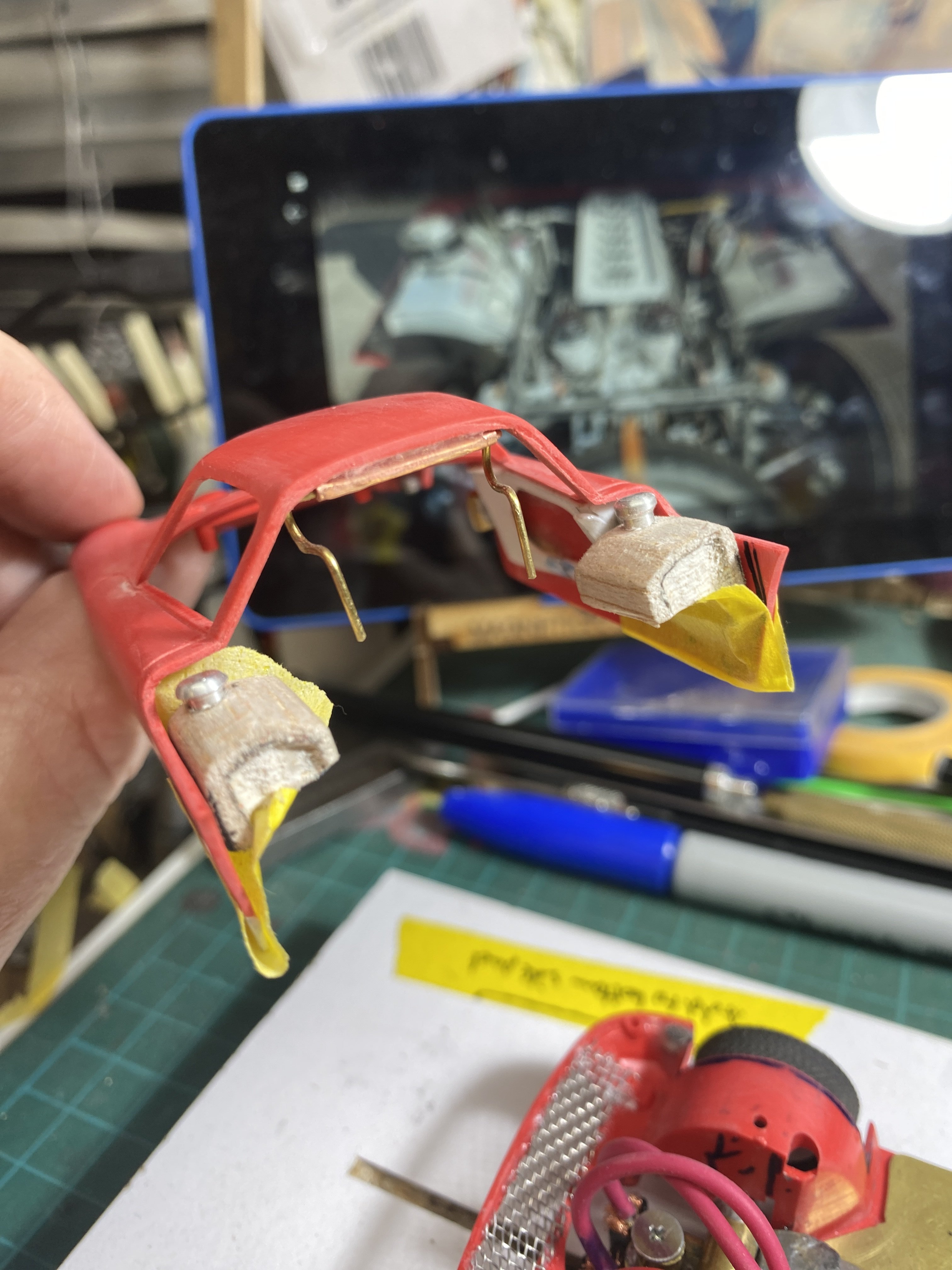

I made some petrol tanks from Balsa and had a go at ali foiling using kitchen tin foil.
It's pretty mad that you can get this stuff to conform like it has, then sand and polish it. Better ali finish than any paint can give in my opinion.
The tanks will get fixed in once the body is painted.

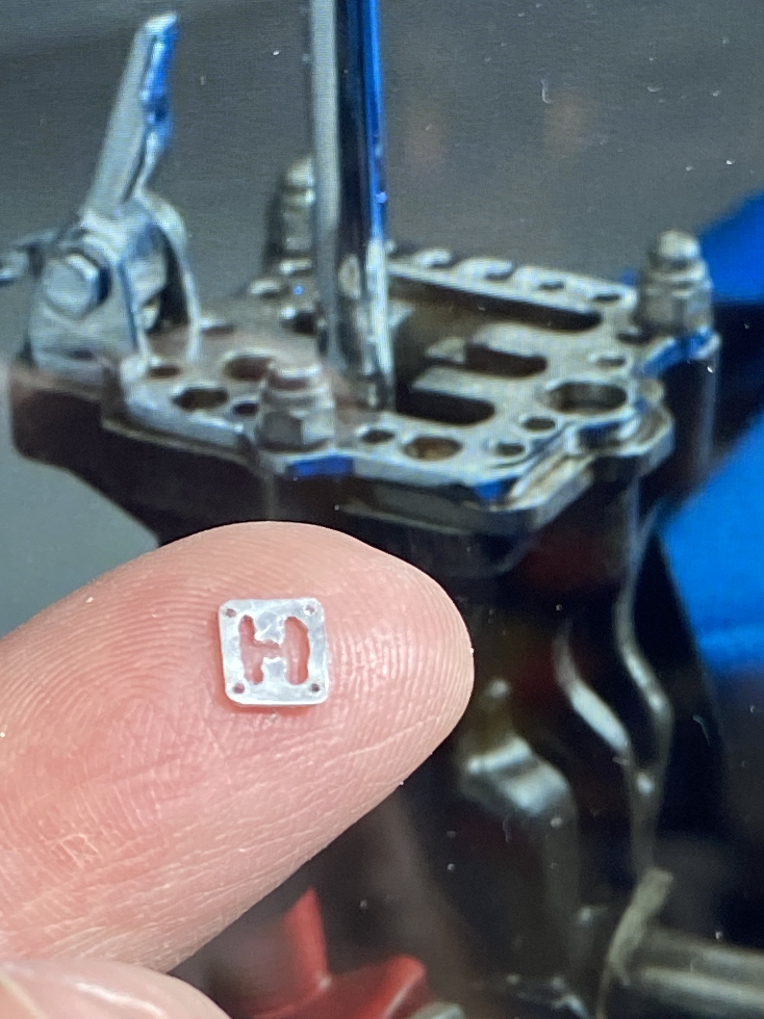

I can't remember if I post the mesh gills, I stole my wifes sieve and cut pieces to shape(I did buy her a new one Rofl )
    I've done one at the front but can't find the photo on my laptop.
