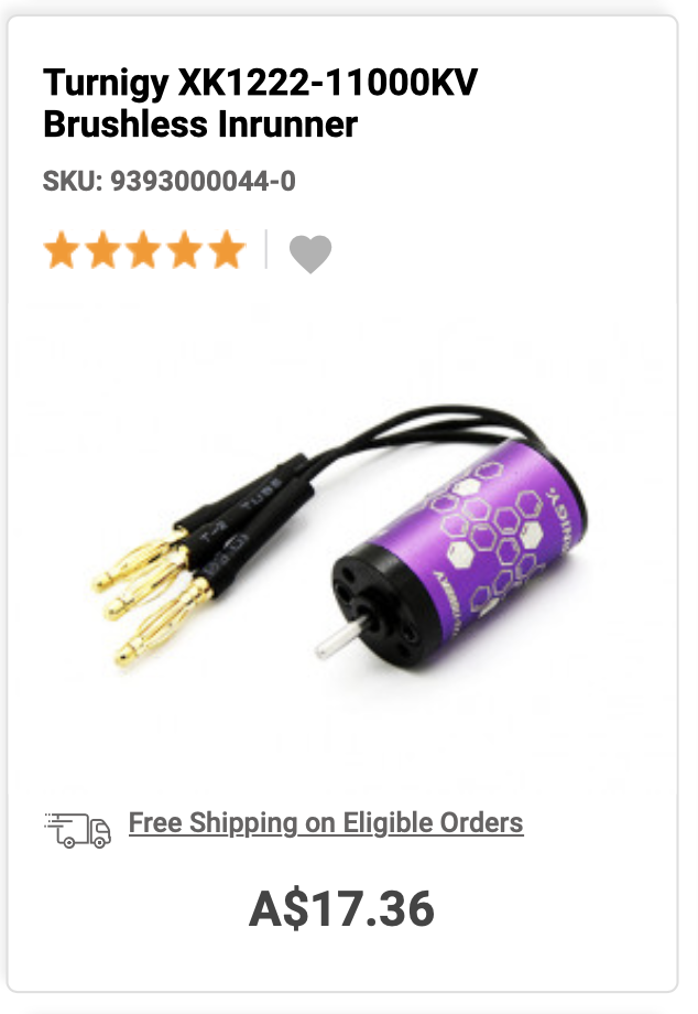

A reasonable quality brushed slot motor from Armchairracer is circa $28.  The brushless inrunner motor I have on my bench for a slot car cost $35au, but cheaper ones are available. Finding one with suitable kv is the challenge, or buy one and rewind it. e.g
