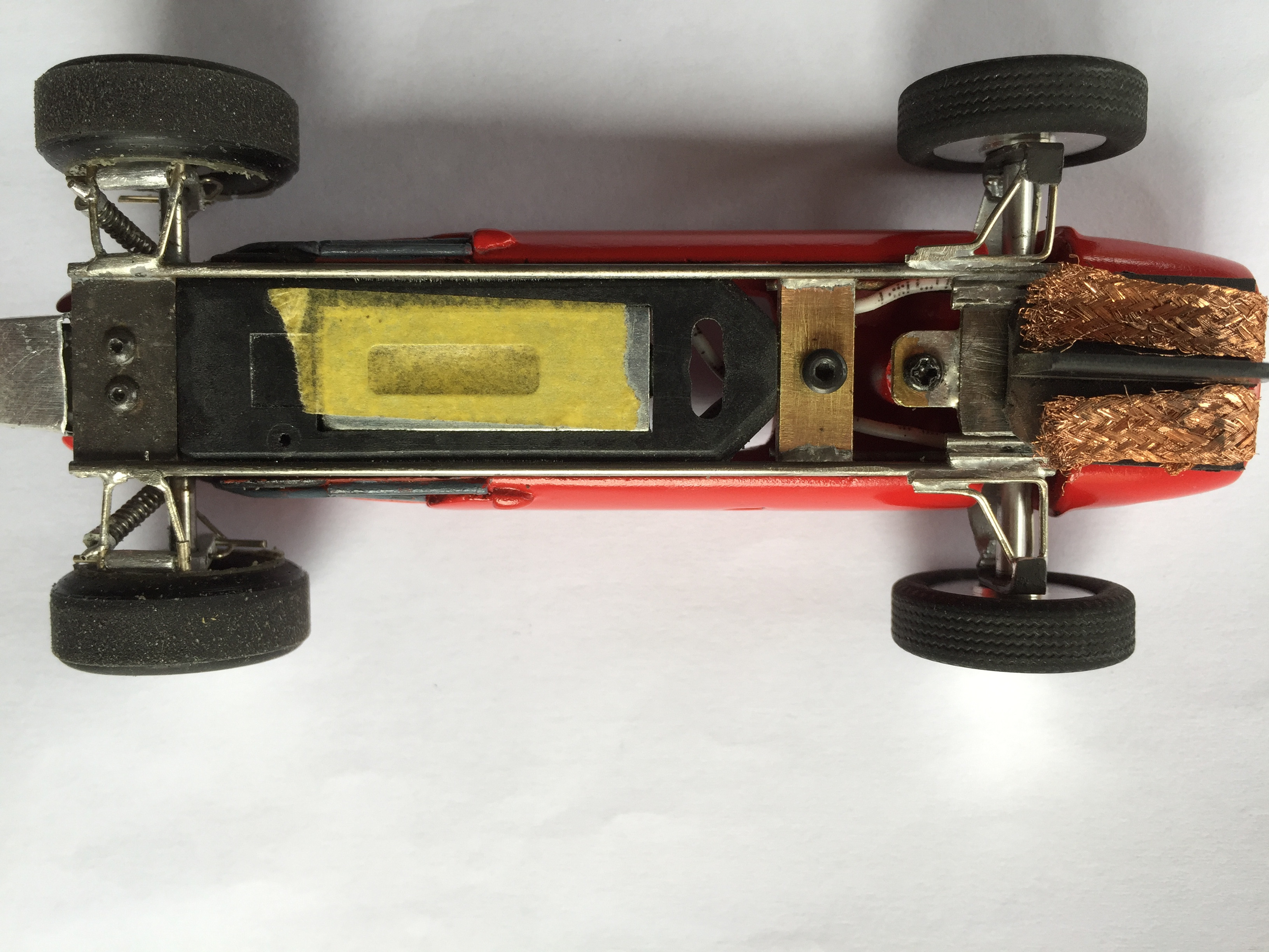

Ken,
Here is a photograph of the underside of the chassis.  The front is attached to the rear of the Policar pod by screws through a brass plate to which the side rails are soldered; the third mounting point uses one of the Policar pod front mounting points screwed to another brass plate.  The tape on the bottom of the motor is to stop anything getting in there during building.
Best Wishes
David
