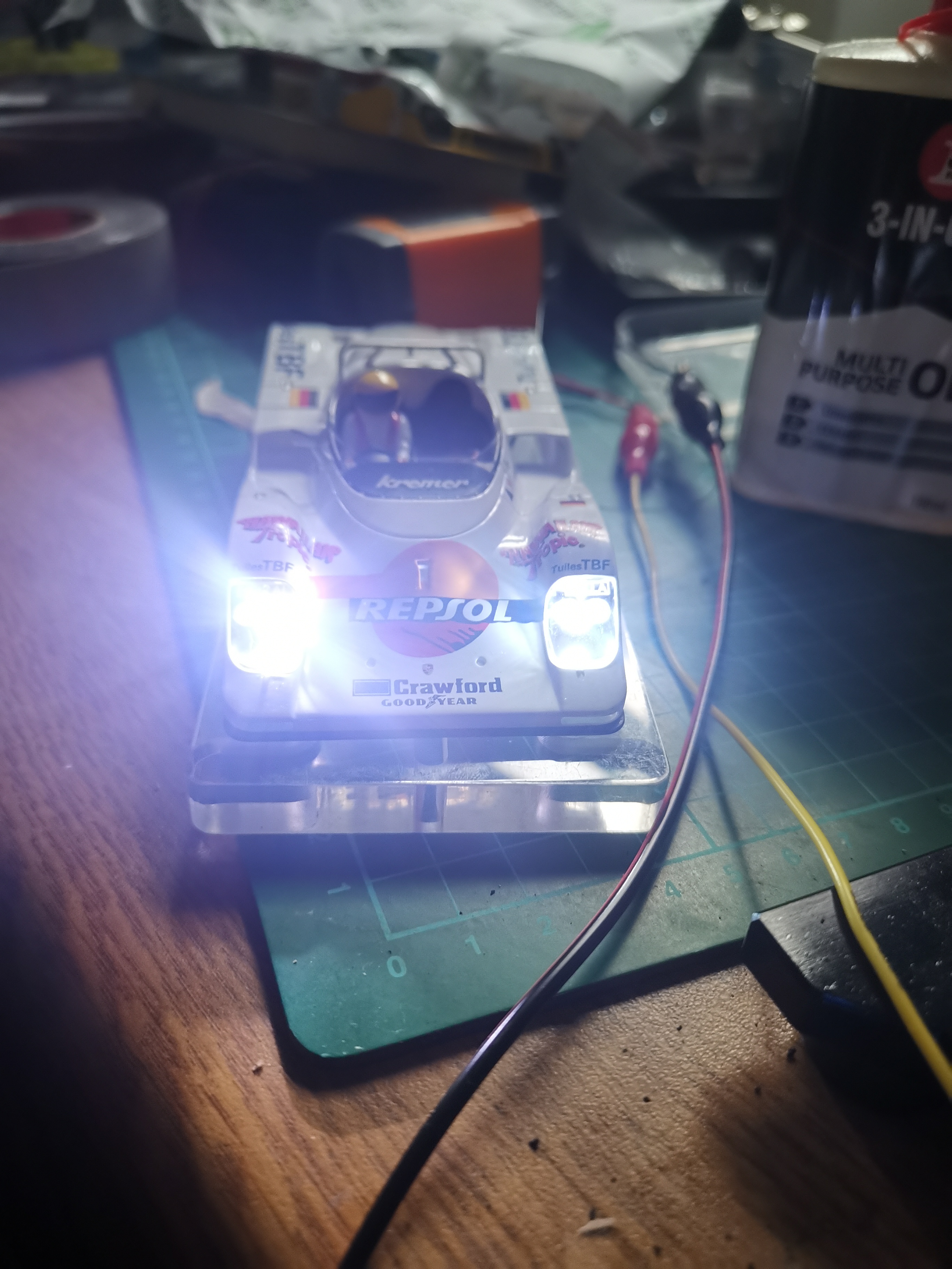

(14th-Jun-21, 06:32 PM)Graham Wrote:  All fitted with lights  Idea
Oreca has lights. A zmachine quad yellow set
The oreca is a a reworked survivor of a DiSCA event.
The other 2, i'll rig up something but probably not a  full set.
Alan

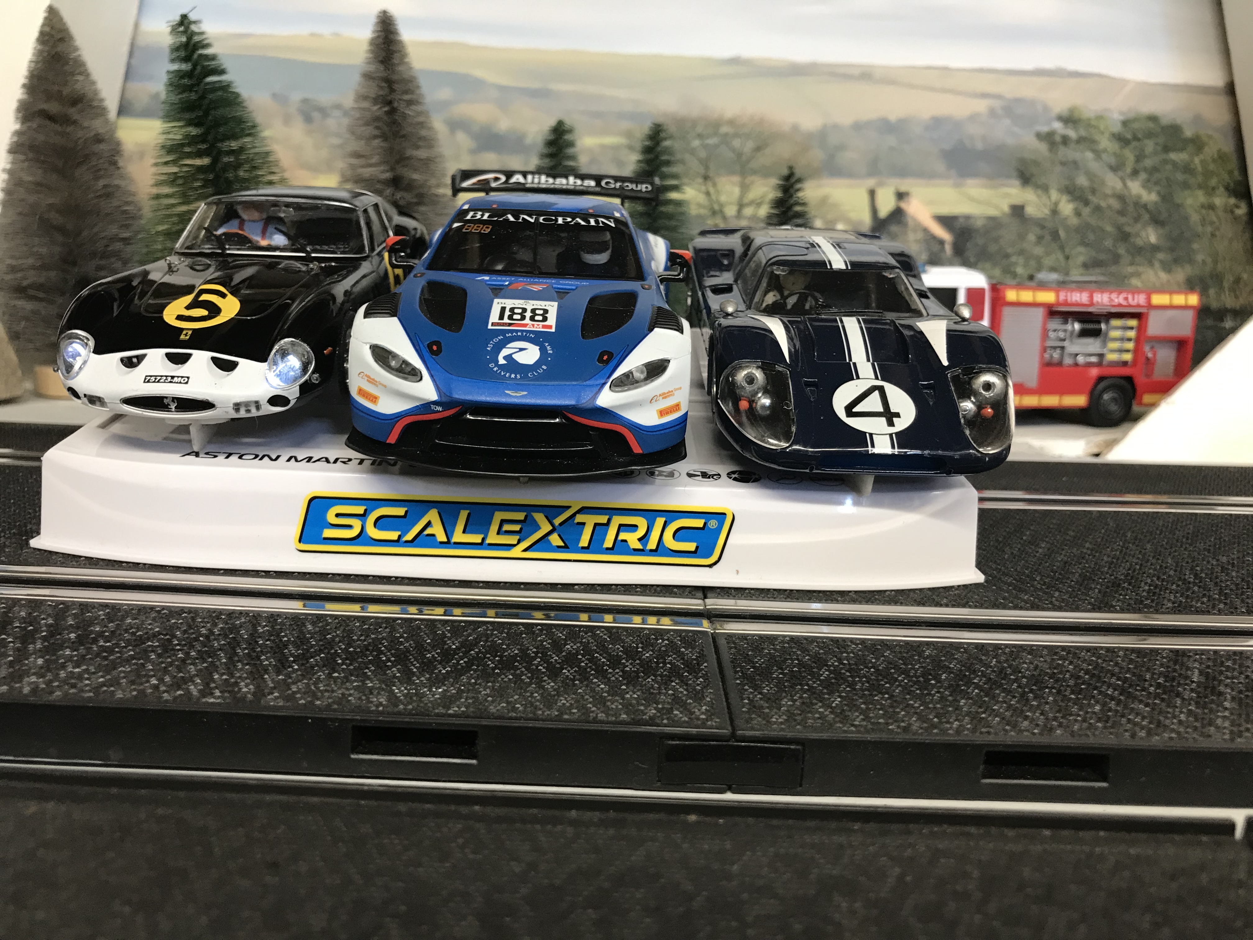

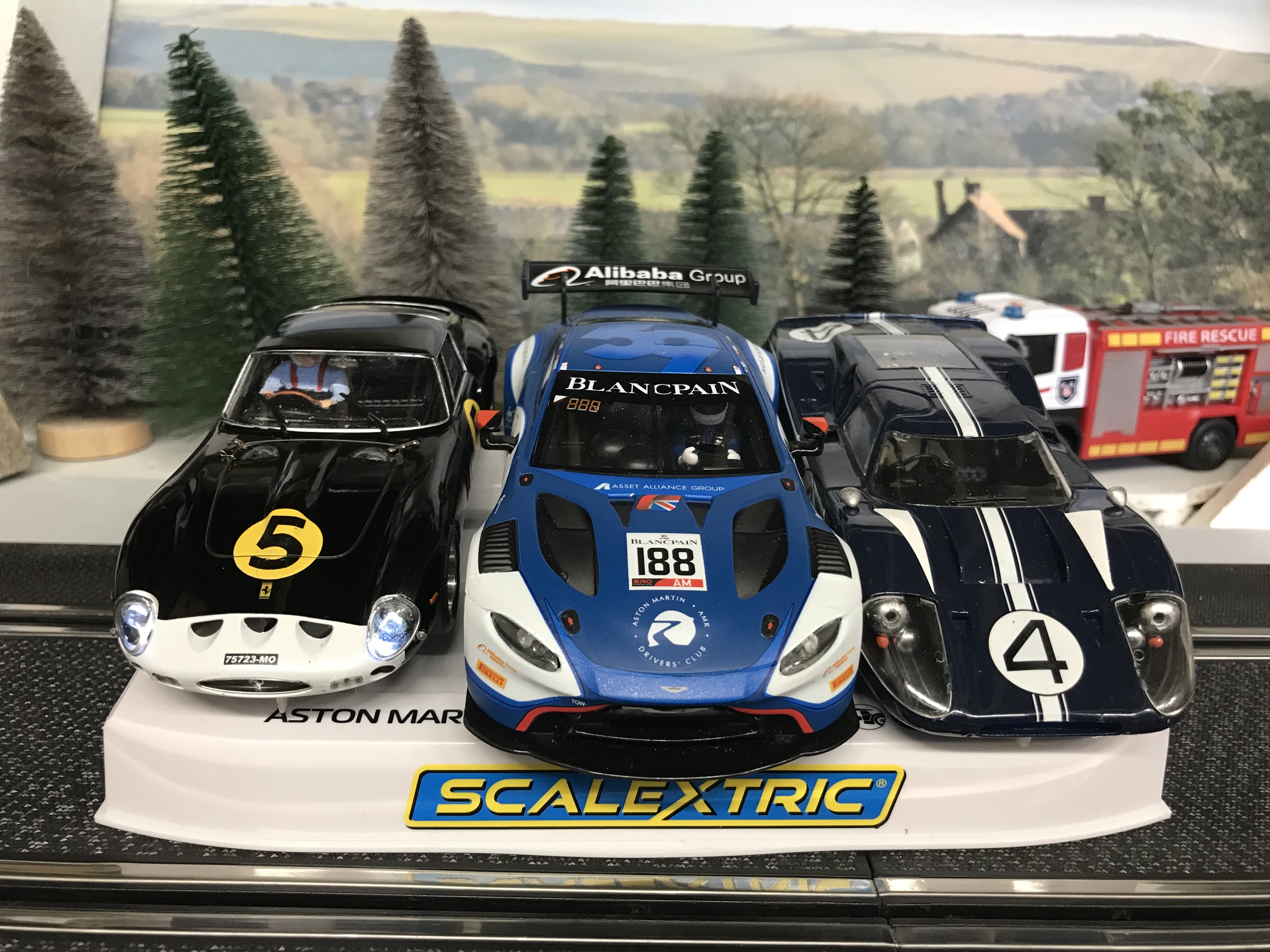

#24
        Hi all
Just a quick post to say I have built up my three for the event see attachments.
First time I fitted lights too, so was an interesting task. ??
I had the z sets on a old car which I fitted to the Ford, they were a doddle to fit the only issue I had was to drill a hole in the headlights to secure the led bulb.
The Ferrari I went with the slot it pack, oh boy was this challenging, first select the right soldering tip and connect . But the biggest issue was getting space under the arches and with the long trailing connectors I had to really think about the angle and when to cut down ( best after soldering ) but overall I am pleased with the results and the task has increased my understanding of fitting lights.

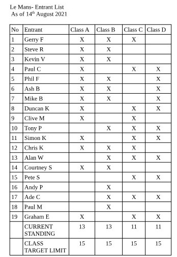

Wavegreen Hi Folks,
I am checking with the hosts that we are still on board for the October Proxy.
Here is the up to date list I have of current entrants, please check to make sure I have not left any of you off.
But as it stands we have now 19 entrants, which means that there is still room for one more

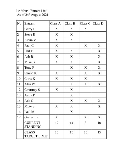

Wavegreen Hi Folks,
 minimum of front lights (or light as in the case of one of my cars at the moment) are OK to get full points.
Here is an update of the entrants list to date
