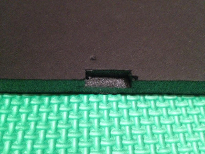

Standard Scalextric side clips were used to keep the track secure, these are normally pinned in place but instead I decided to screw the foam board borders down to keep the clips in place. A small notch was cut in the foam board so that the clip didn't pull the track down below the 10mm level.
