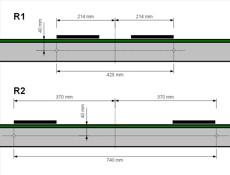

Bolting the frames together is simple and cheap.
Our suggested method is to use two bolts directly under the track exits, with centres 40mm below the table surface, level with the outside edges of the track.
So for an R1 exit, the centres would be 428mm apart, and for an R2 the centres would be 740mm apart, as shown above.
Where you put the bolts on the table frame, how far from each edge if you like, will depend on the position of the track exits, so decide on your track design first, and only drill the holes in the frame once you're sure your happy.
We'd suggest an M8 bolt with a wing nut, and washers. We'd also suggest drilling your holes not at 8mm diameter, but at 10mm or even 12mm. This will allow some degree of adjustment, to allow for any inaccuracy.

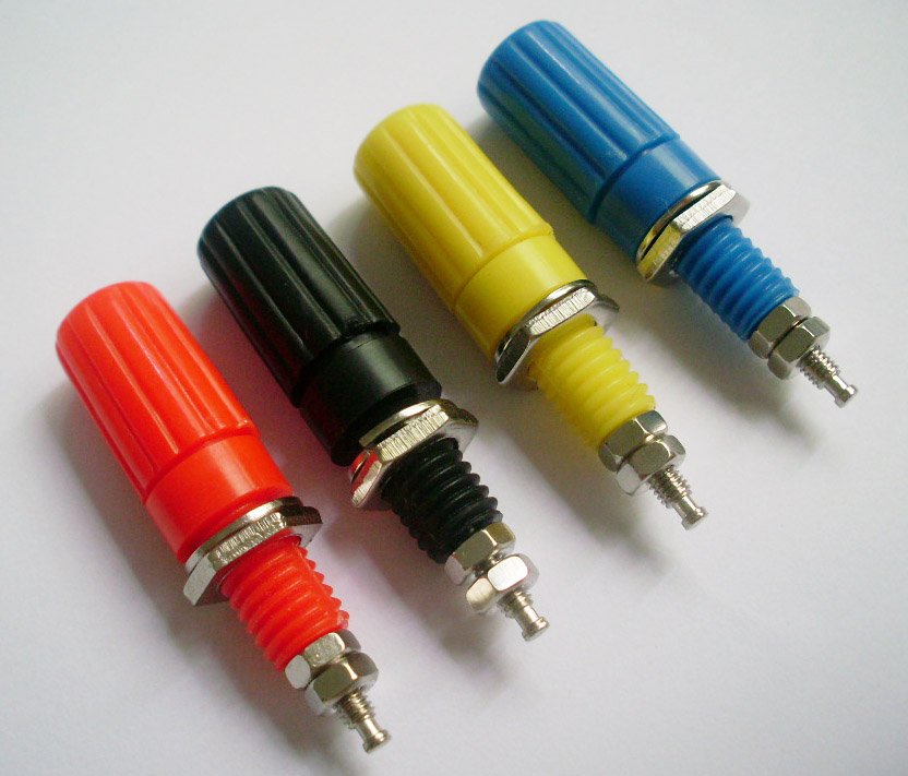

The type of sockets we recommend are speaker binding posts as shown below.
These have several advantages over most other types of socket.
They can accept 4mm banana plugs, spade terminals, or even bare ended wire, so they are quite flexible, and should allow connection even in emergency situations where you break or lose a cable.
They are also rated at 10A so they should be able to handle the power, they're available in a range of colours so you can colour code the sockets to make connecting them up simpler, and they're also capable of mounting on thicker materials than most sockets.

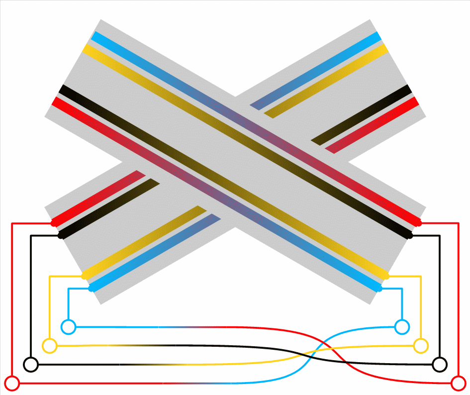

The wiring diagram shown above, for the straight module, is also applicable for a corner module, though obviously the sockets will be on adjacent sides rather than opposite each other. Loop modules are again similar, but only require one set of sockets.
However, the wiring for a bridge section is slightly different. Here, because of the crossed track, the outside power rails become the inside, and vice versa. So, a blue socket, representing an outside power rail, at one end of the module will need to be wired to a red socket at the other. The wiring, just like the power rails, must swap over, so that the connections to the next module is correct.
