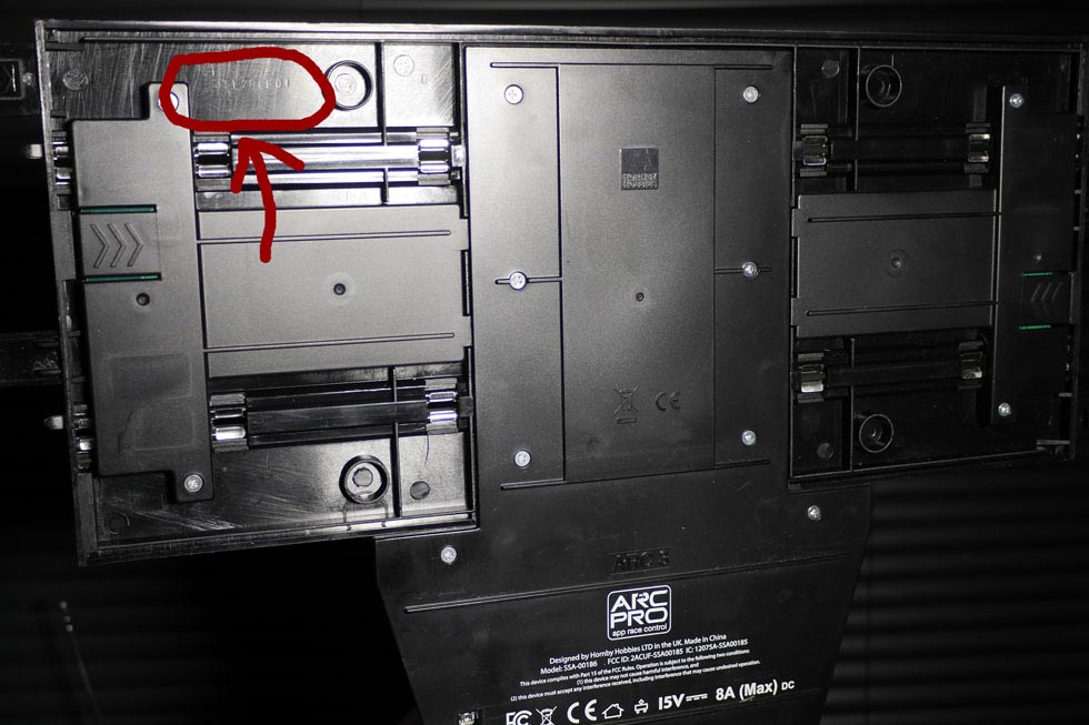

Batch Number

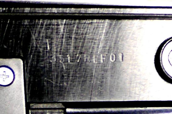

Each powerbase has a batch number punched into the underside of the track piece. This is the number on my original ARC Pro powerbase...
Batch Numbers
Not all batch numbers will be in that exact place. This is what the number means...
3517REF01 = week 35 / year (20)17
So my powerbase was manufactured in the 35th week of 2017, which was the end of August / beginning of September.

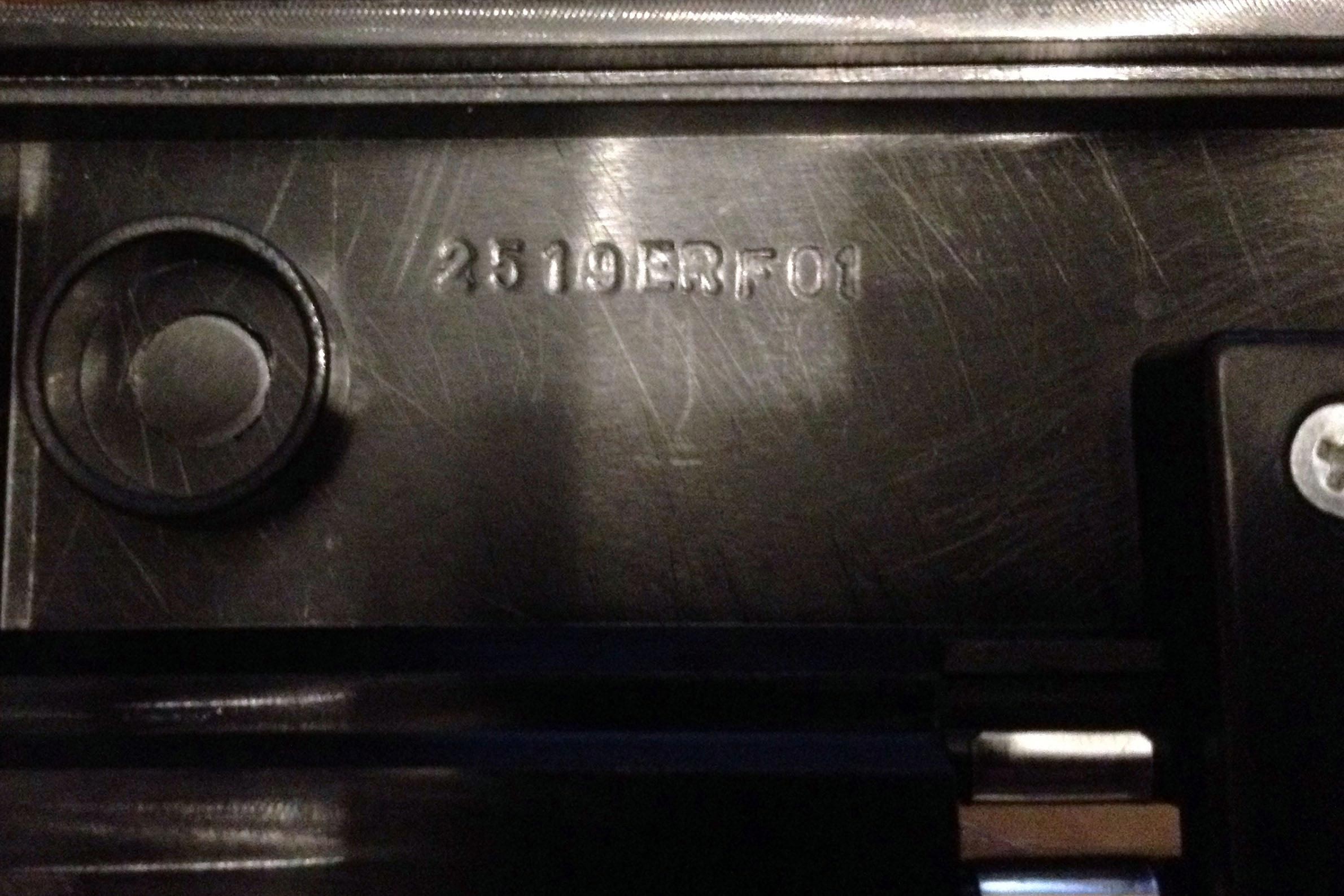

The second upgrade (lap counting) was also included in all powerbases from week 22 (beginning of June) 2018. This will include the ARC Pro Le Mans 24 hour set released in the summer of 2019. This is the batch code of the powerbase from an ARC Air Le Mans 24h set...
Batch Number
That's 2519ERF01 - mid-June 2019.

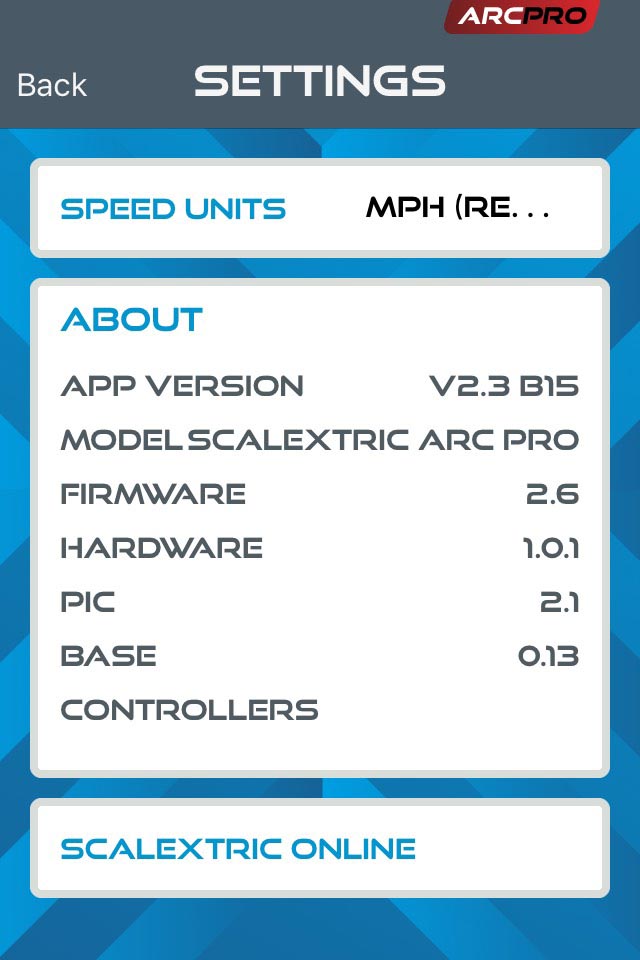

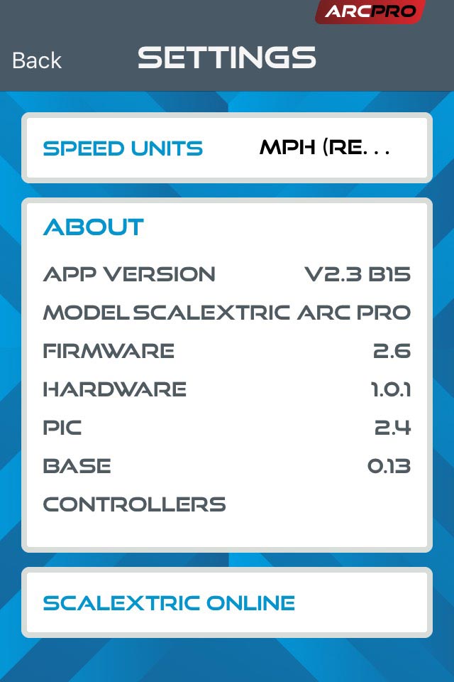

The ARC app shows the software versions in the Settings screen, which is accessed via the cog icon on the main screen...
Settings
The two screenshots show the software versions being used by an original, factory-release 2017 powerbase and the latest 2019 powerbase from the ARC Pro Le Mans 24h set. At the time of writing, there have been no upgrades to the Bluetooth (BLE) firmware - it is still v2.6. The only upgrade has been to the PIC chip firmware from 2.1 to 2.4 - which fixes a tiny voltage disparity between the two lanes in analogue mode.
