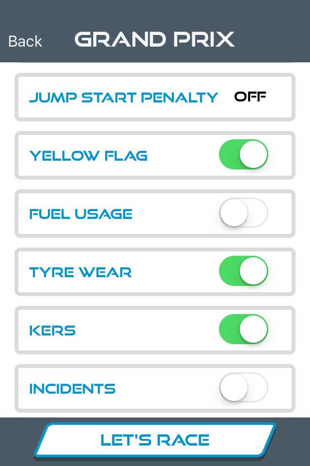

Setting up our Formula One event in the ARC Pro app, we're looking at a timed race for qualifying - or even two timed races to finish with a pole position shoot-out. Each could be two minutes long. Then for the main event we need a Grand Prix race of around 30 laps. With the Tyre Wear simulation turned on, that should make it a two-stop race. To increase the distance to 35 laps would mean stretching pit stops to 12 laps, or pitting three times. That could be fun!
Grand Prix Set Up & Race Screens

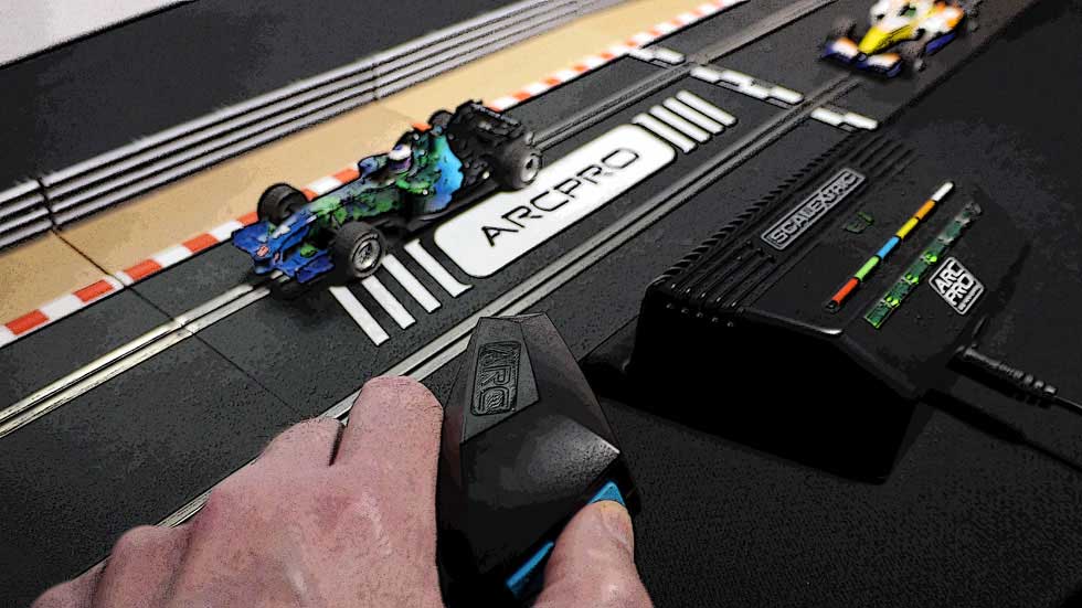

In ARC Pro, choosing the option drops the maximum power of the cars to 80%, with the extra available as the KERS boost. A three-second boost is activated by double-pressing the Lane Change button on the controller. This drops the energy available to zero. The KERS reservoir indicator sits just to the left of the timing data on the ARC app race screen. It does not have to be full (green) to be discharged, but the boost will be slightly shorter if it is less than full. Below you can see the double press of the Lane Change button...
Activating KERS

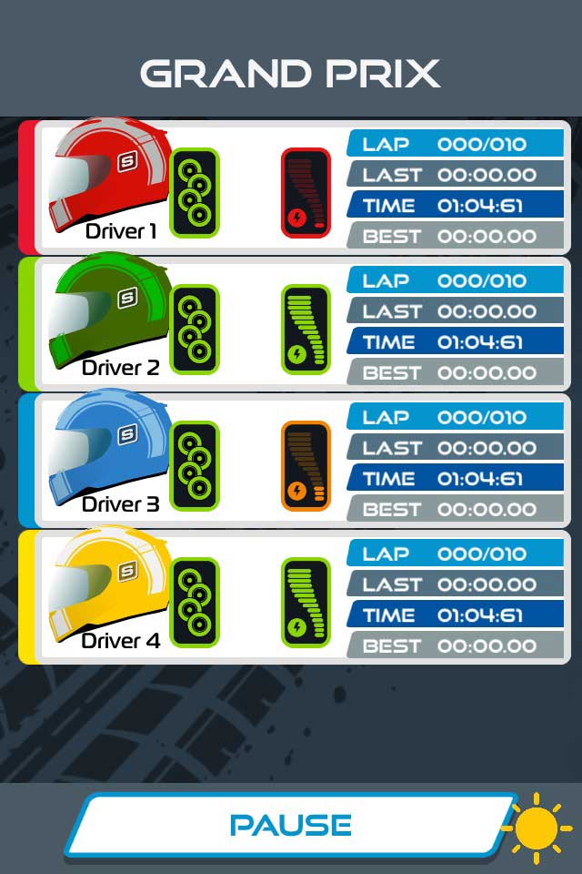

...and the KERS indicators on the ARC race screen. Driver 1 has only 5% KERS available, Driver 3 has 20%, whereas Drivers 2 and 4 have full KERS reservoirs.

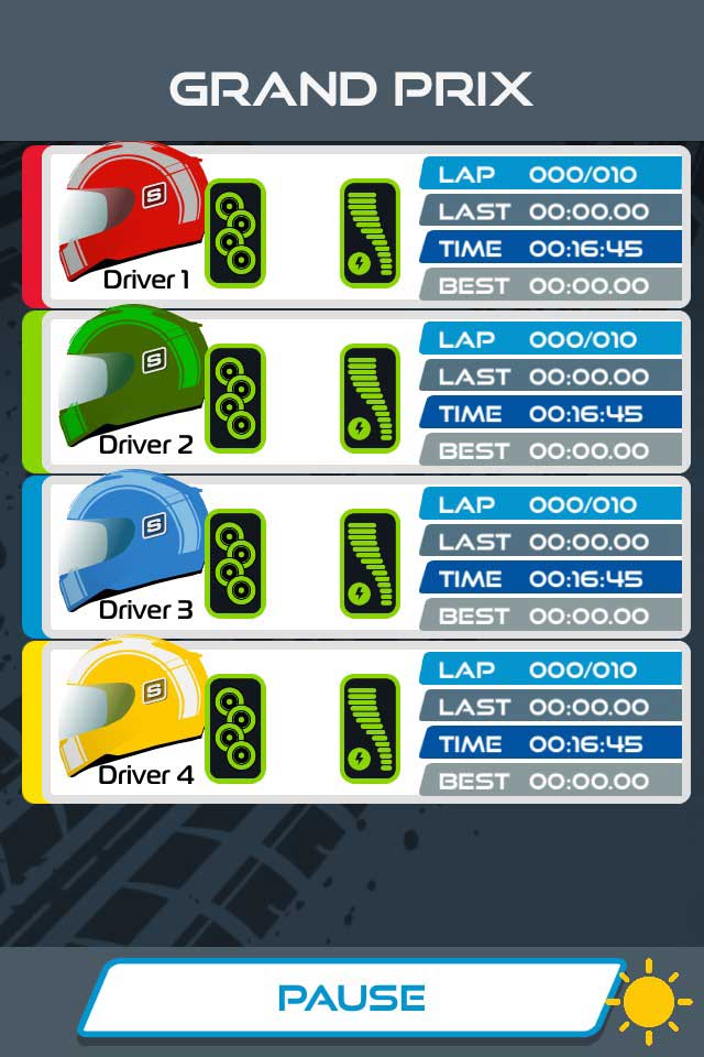

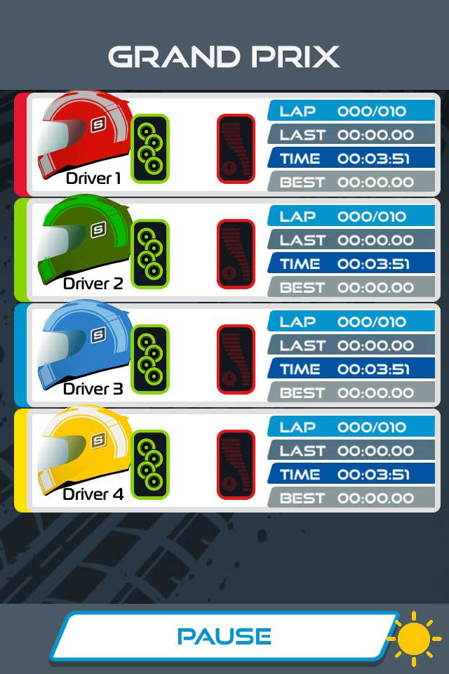

The KERS reservoir starts the race empty. From the start of the race - or after a KERS boost - the level is gradually topped up - to 5% (red) after five seconds, 20% (orange) after seven seconds, 50% (orange to green) at ten seconds and 75% (green) after 13 seconds. From empty to full takes 15 seconds. The top up continues during a yellow flag, and although KERS can be discharged under yellow, there will be no power boost. This is the same for other features that rely on the calibrated low speed.
KERS Minimum & Maximum

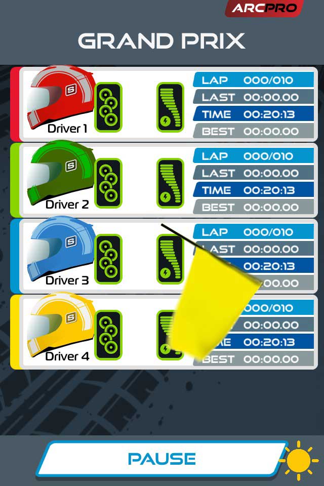

Another feature that should be included in a modern Formula One simulation is the ARC Pro Yellow Flag feature. This works more like a Virtual Safety Car, activated by tapping the race screen during the race and the cars are then limited to their calibrated low speed until the screen is tapped again. During the Yellow Flag period, a waving yellow flag appears on the screen while cars circulate at a safe speed. Crashed cars can be removed and re-slotted.
Yellow Flag
