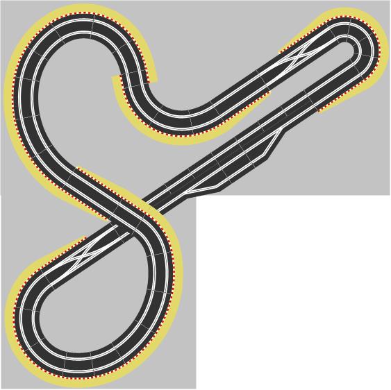

Last had a track 35yrs ago, we now have a space available for a track L shaped 8ft x8ft back edges  will be up against the wall and corner after some ideas of layouts and any advice appreciated. my wife as picked up some used sets all in working order 2 analogue and 1 digital, not going to get into racing just 2 lane hobby track and want it to be permanent as we will be doing scenery ect thanks

How wide are the L-shaped pieces? You said it's 8ft x 8ft on the back edges, but how wide, or deep is it on the sides of the L? It's difficult to make specific suggestions without all the measurements.
There are probably some basic bits of advice that are worth passing on...
Firstly, include borders and barriers around the track to avoid your cars getting smashed up.
Secondly, scenic tracks are great, but its worth driving your layout for a while before you get too heavily into the scenics, to make sure you're happy with it.
Finally, if you've bought Scalextric sets, that probably means you'll have mainly R2 corners, possibly with an R1 hairpin or two. It's definitely worth thinking about adding some R3 & R4 corners for variety.
Also, it may be worth looking at our Track Plans page for ideas.

(21st-Dec-25, 12:01 AM)JasonB. Thanks mate I’m using 8x4 ply sheet 8ft along back edges 4ft wide thst would leave 4ft on both front edges I’ve attached a screen shot of a YouTube track Wrote:  Welcome aboard, and welcome back to the hobby.  Wavegreen

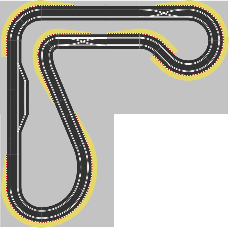

#10
Just a few ideas...
