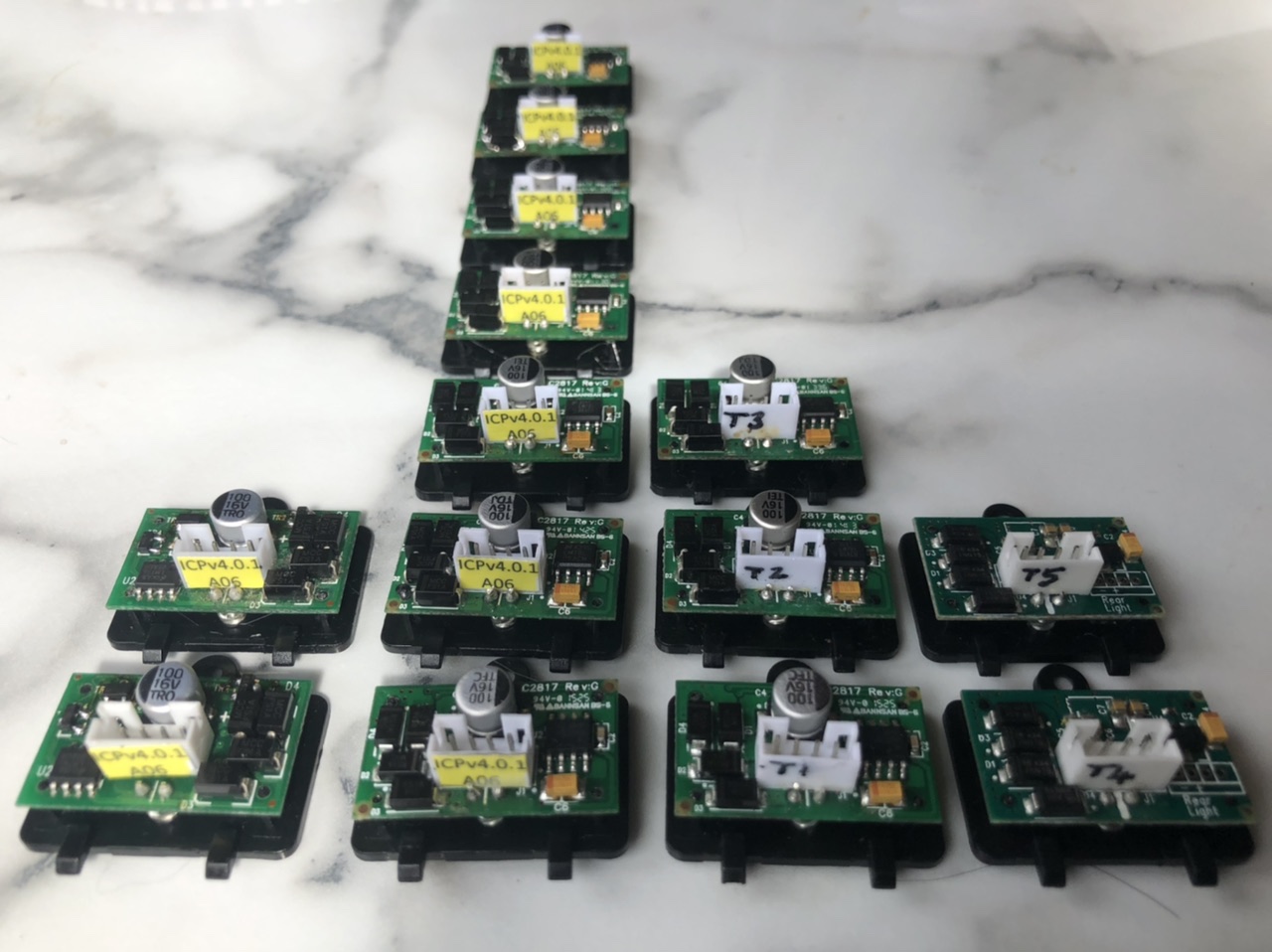

The next three posts provide a simple summary of repairs carried out to a bundle of fourteen faulty Scalextric C8515 digital decoders.
These were a mix of rev F, rev G and rev H decoders.
Some had previously been upgraded (i.e. MOSFETs) and in addition some had been re-flashed with ICP v3.3.
Faults are typically known to be diode failures, MOSFET failures, and occasionally npn transistor failures - all typically related to excess current and/or voltage spikes.
REPAIR PROCEDURE

REPAIR RESULTS
Repair results on the above 14 faulty decoders:
Step 1:
All diodes were found to function correctly - non required replacement.
Step 2:
On removing the two MOSFETs and replacing onIy the n-channel MOSFET, 11 decoders became controllable.
The 3 that didn’t function were investigated and corrected. One had a failed on-board ferrite bead inductor. One had a failed npn transistor (preventing motor turning on). The third had a damaged interconnect track.
Step 3:
On replacing the p-channel MOSFET again, 11 decoders became controllable in terms of both motor and brake. All three were found to have failed brake enable npn transistors. One failed open circuit so simply the brake would not function. Replacing the npn fixed this problem. The other two had failed as short circuits so the brakes were permanently applied - even when the throttle was applied too. In each the case the npn was replaced and a pair of replacement replacement MOSFETs were fitted (as this brake-on condition can further damage the MOSFETs).
OUTCOMES
14 fully functioning and upgraded C8515 decoders. No write-offs :)
[attachment=32364]
[+] 4 members Like Dr_C2's post
CONCLUSIONS
1/ In this sample of faulty C8515 decoders none had failed bridge rectifier diodes.
2/ At least 8 out of 14 (57%) only replacement of the two MOSFETs was necessary to achieve a full repair.
3/ The other main fault was damage to one or other of the two npn transistors that drive/control the MOSFETs
4/ There was one case of a failed on-board ferrite bead inductor and one case of a damaged interconnect track.
5/ The AO3434 and AO3401 as used in the rev H provide a good upgrade path for the earlier rev F and rev G decoder versions.
Hope the above was useful and enjoyable, at least for some ;)
