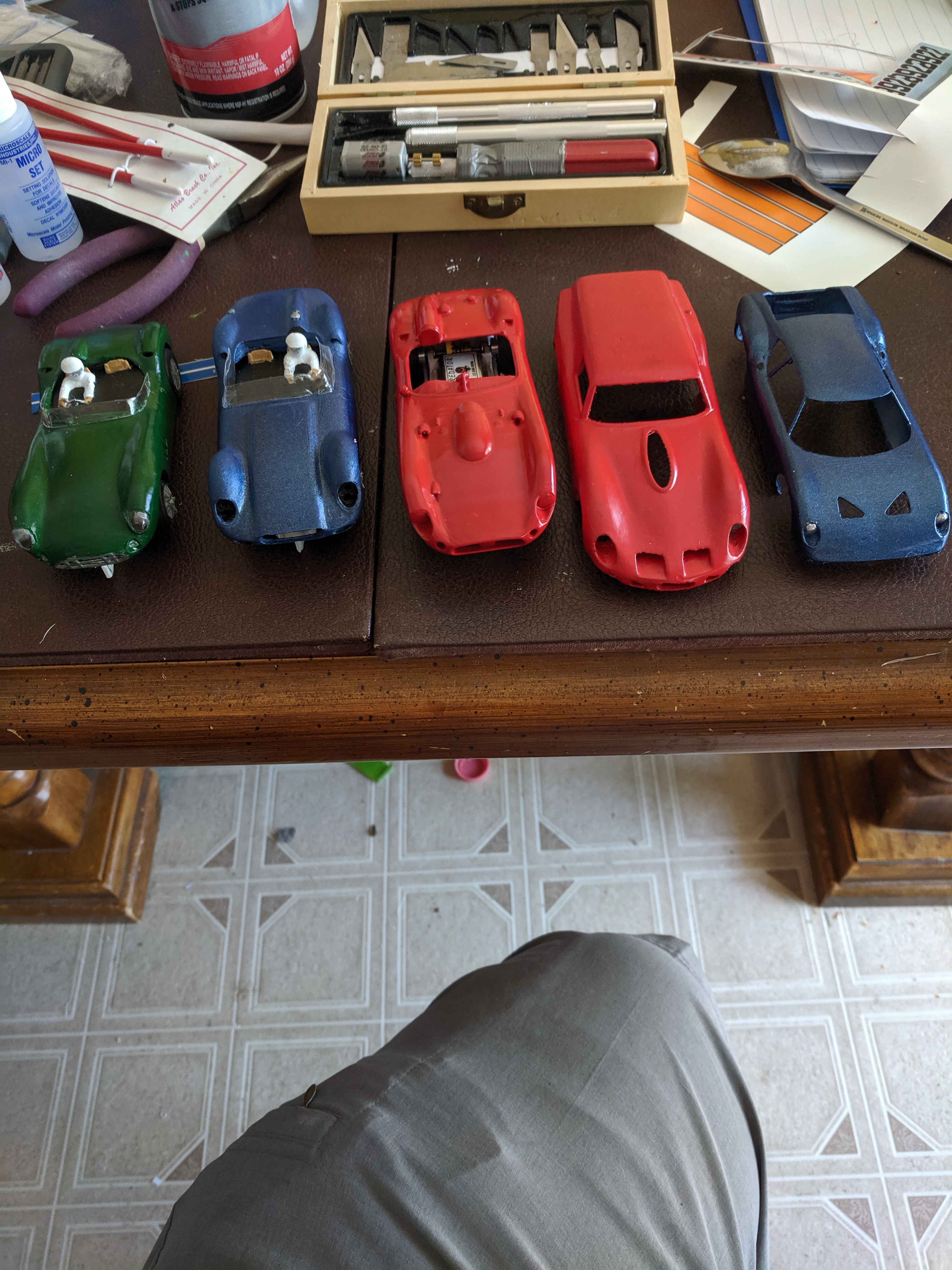

Using Klear (Future) acrylic also works to smooth filament printed bodies.
I normally use automotive filler/primer. Two coats then wet/dry and color coats.
I am not a fine scale modeler though.
Layer lines depend on lots of things but many resin printed bodies are basically paint ready once cured.
Show your work! ?
