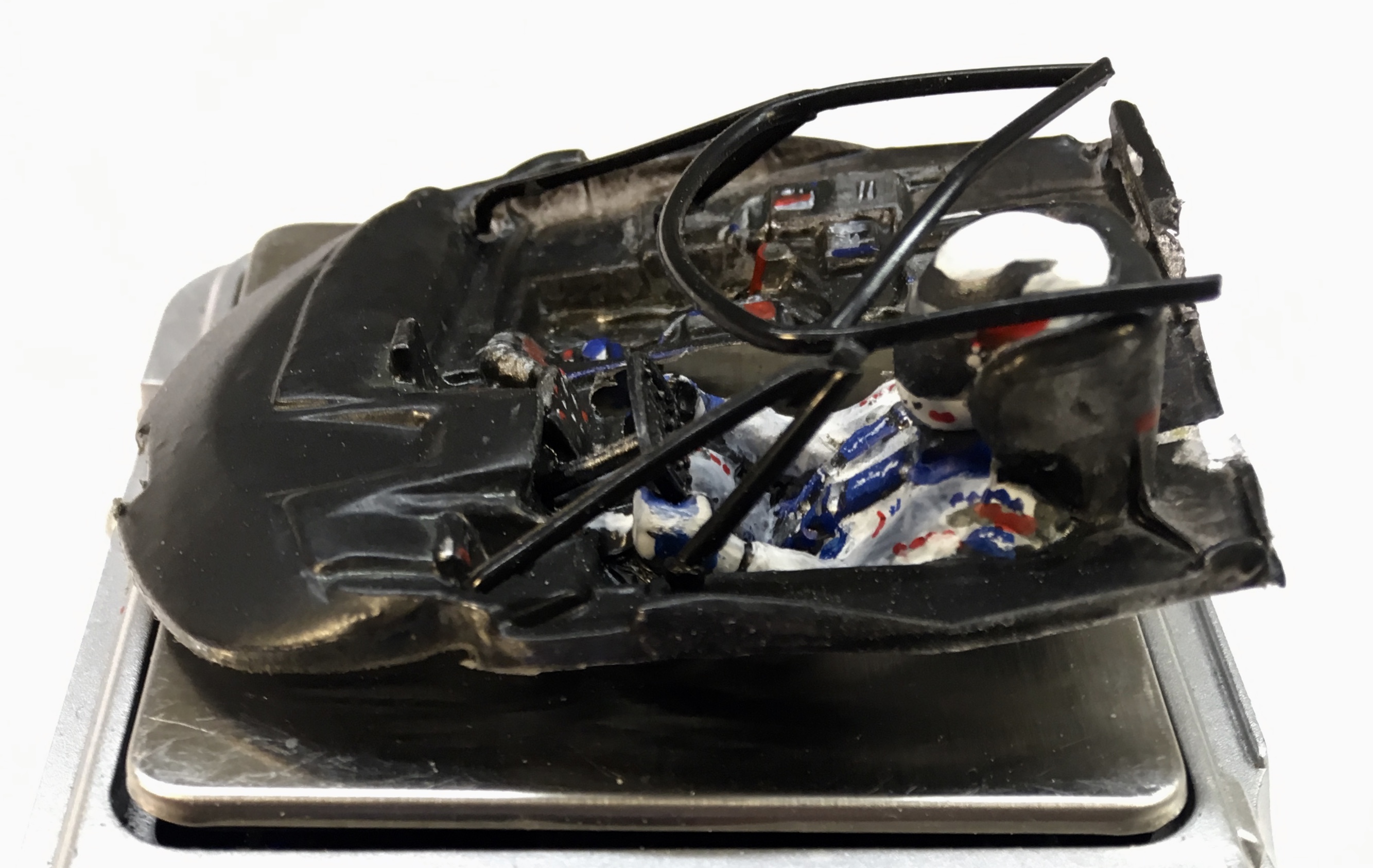

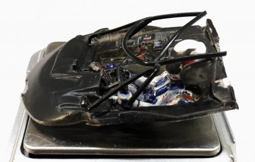

As you can see in the image above the first step was to highlight the bright color in basic black & white.
Below I added some minimal touches of color with paint and markers and then added washes of very diluted acrylics to create shadows and accentuate shapes.

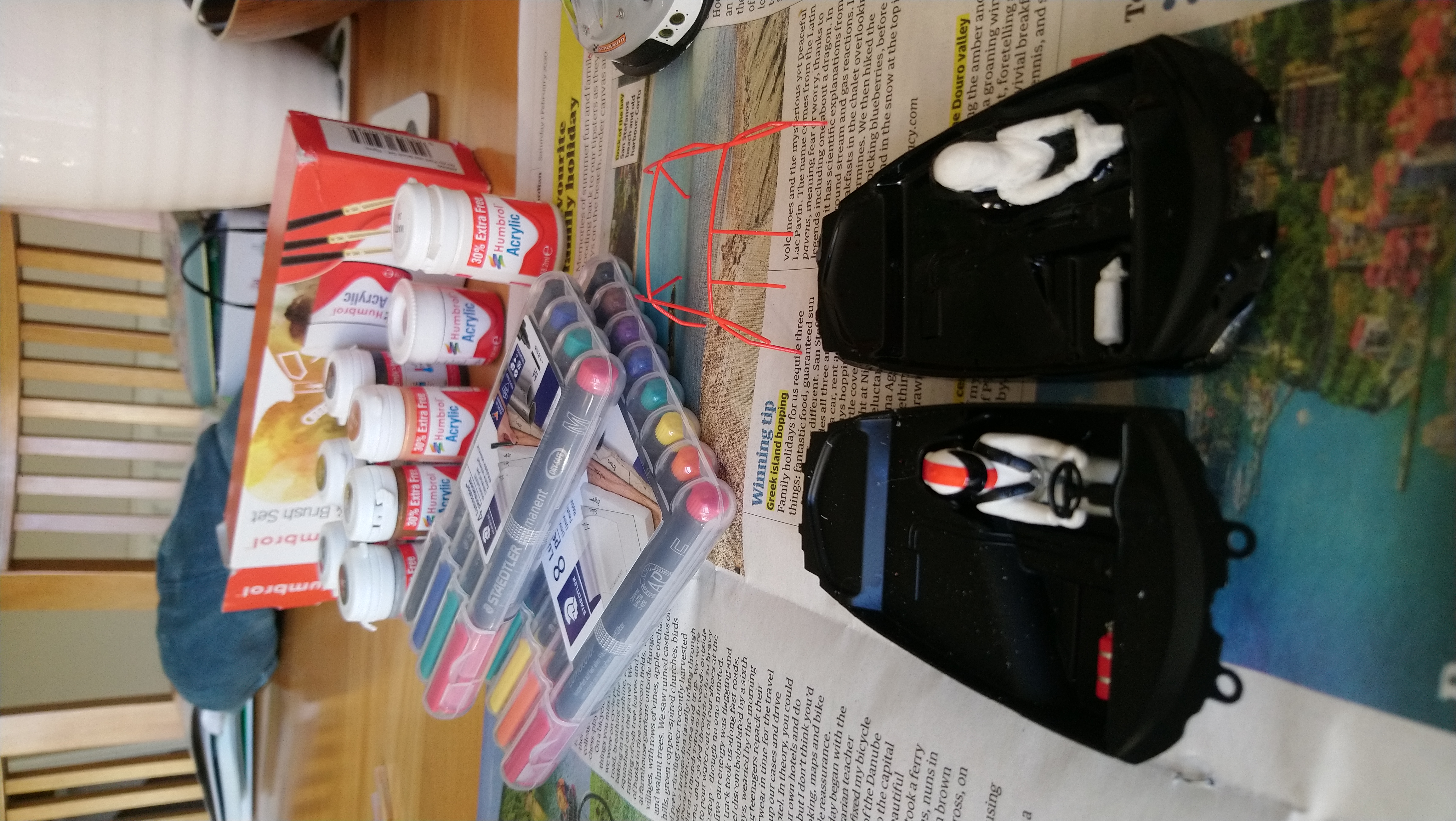

So Tamiya acrylic paints seem readily available, and you clean the brushes with soapy water. Think I probably need a basic set of around 6 colours to create detail and contrast. Will also get some Staedtler permanent markers for highlights
Forgot about full face helmets(!), so no fiddly facial details to worry about. And read elsewhere (Tamar I think) about transferring the roll cage over to the new interior to enhance the appearance.
And to be on the safe side, although I am only refitting two car interiors, I have bought 3 kits.
Feeling a lot more confident about the exercise now though.

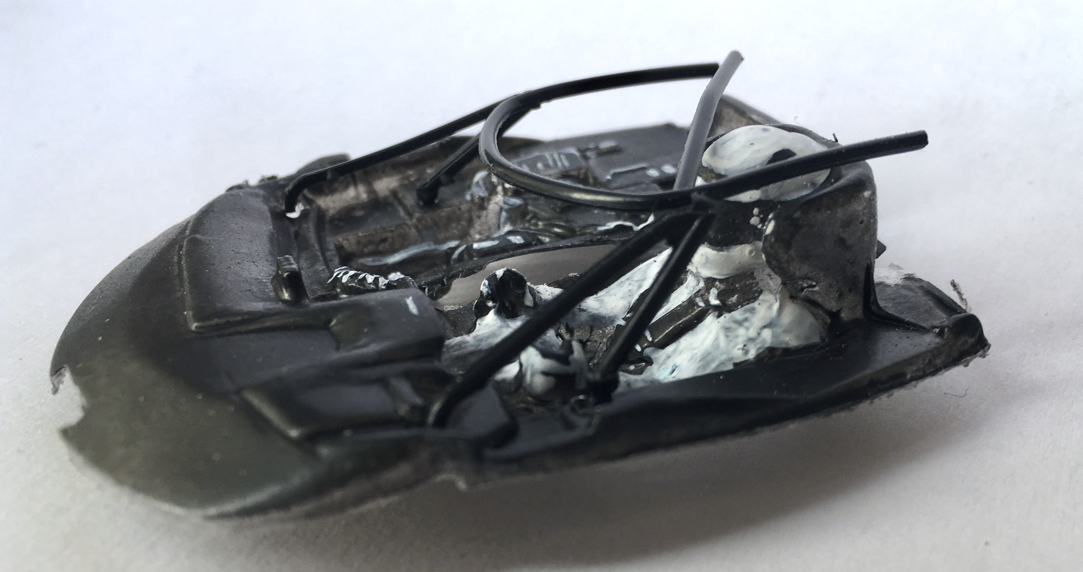

Work in progress on the right, copying the one on the left...
All the gear, sort of got the idea.
(but not about attachments!)
