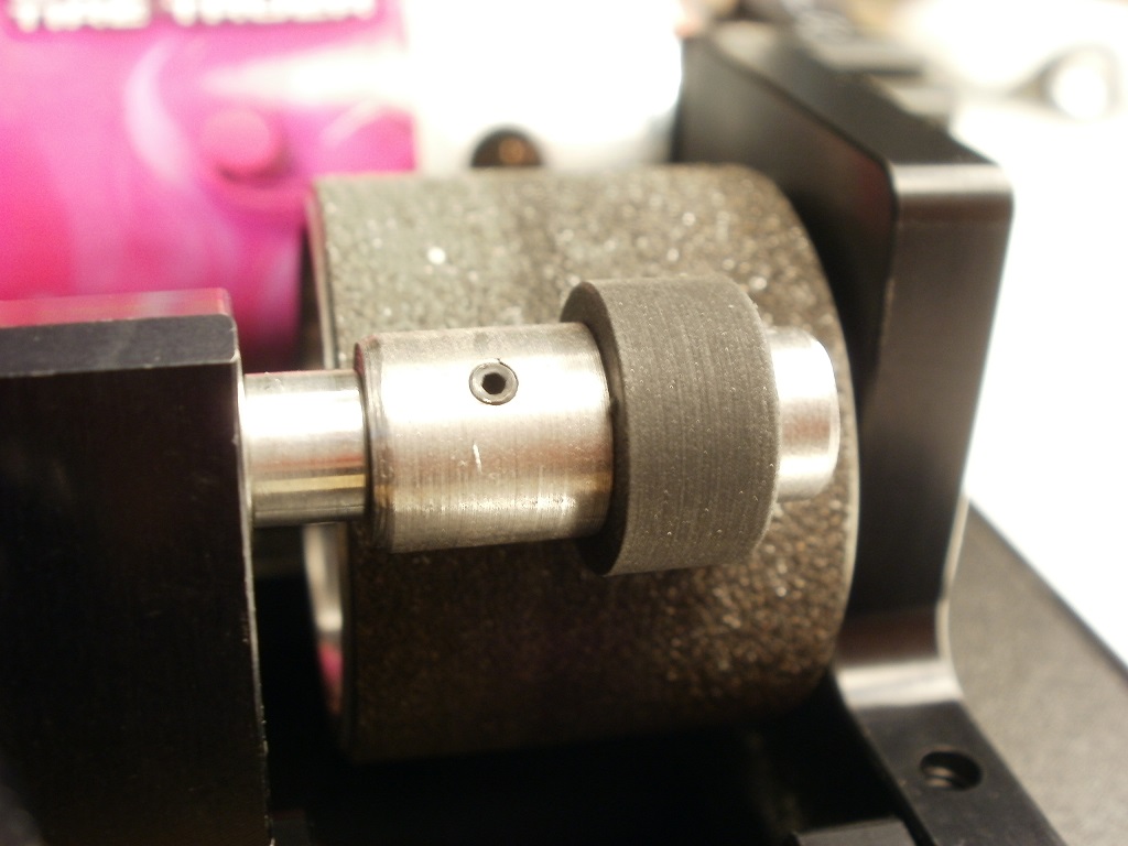

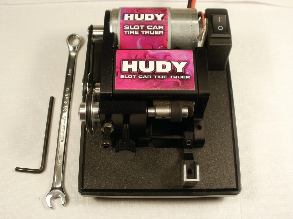

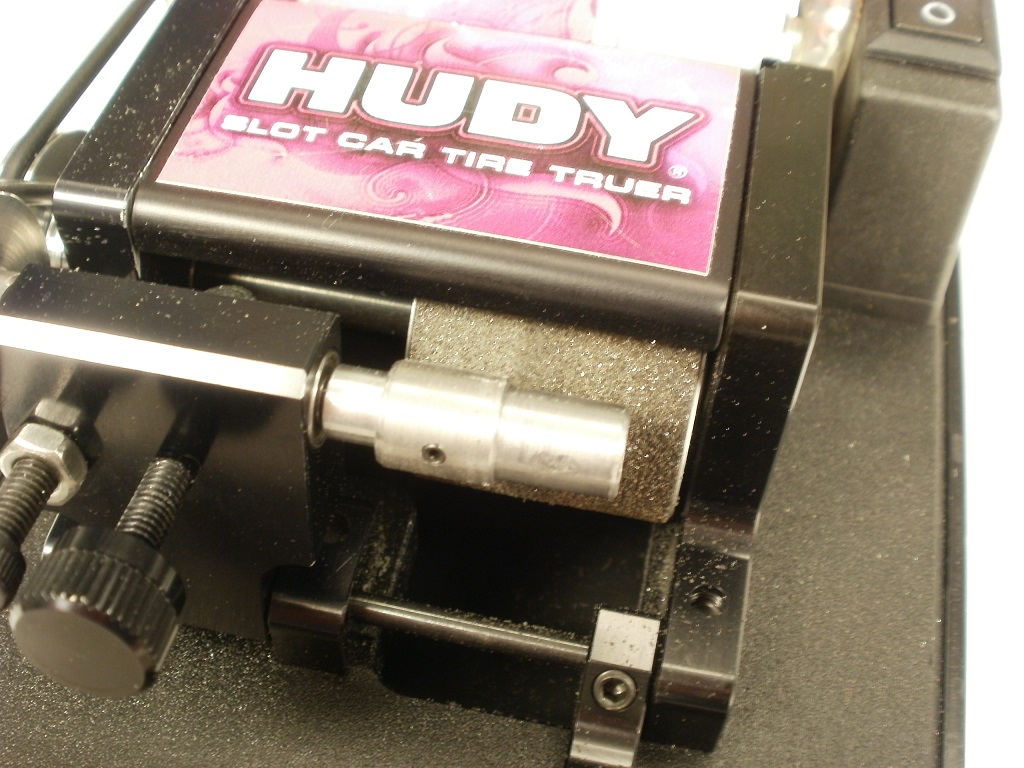

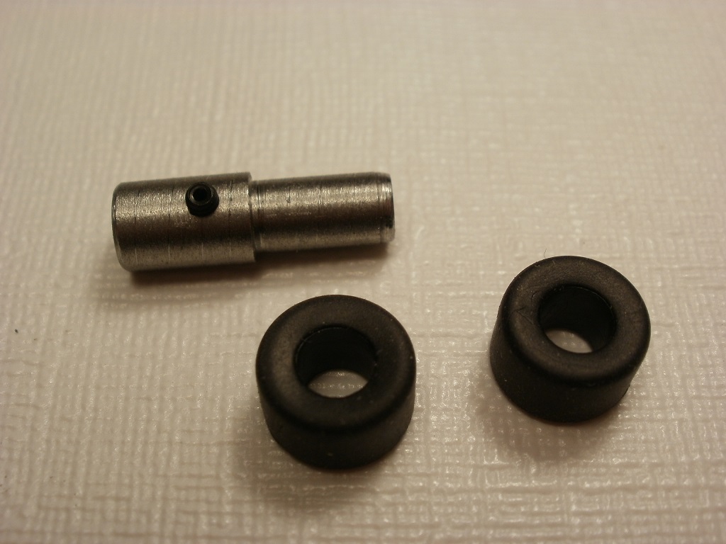

Here's a little more useless information. The Hudy can also true AFX and Tuff Ones HO tires. A mandrel needs to be made for both sizes of tires. A bit of aluminum needs to be filed off the inside of the slide arm to reach. It works like a charm on rubber and urethane tires.
(23rd-Mar-24, 10:56 PM)KensRedZed Wrote:  Greg,
Thank you very kindly for all the legwork. That's quite the amazing list.
Nice! Did you make that, or is there someone out there making/selling them?
[url=https://www.printables.com/@MrFlippant]https://www.printables.com/@MrFlippant[/url]
I went to a local machine shop with a pencil drawing of both mandrels. The guy sort of laughed, and told to come by the next day. Some of those serious businessman chuckle at what we do with our hobbies. It's grand to be retired.  Thumbup
