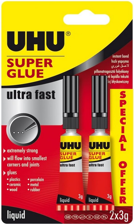

After trying various this is all I've used for the last 5 years or so...
I use it on tyres, bodyshells, threads etc....and sprinkle bicarb powder on when it's still wet to make a fantastic filler that sets like concrete
