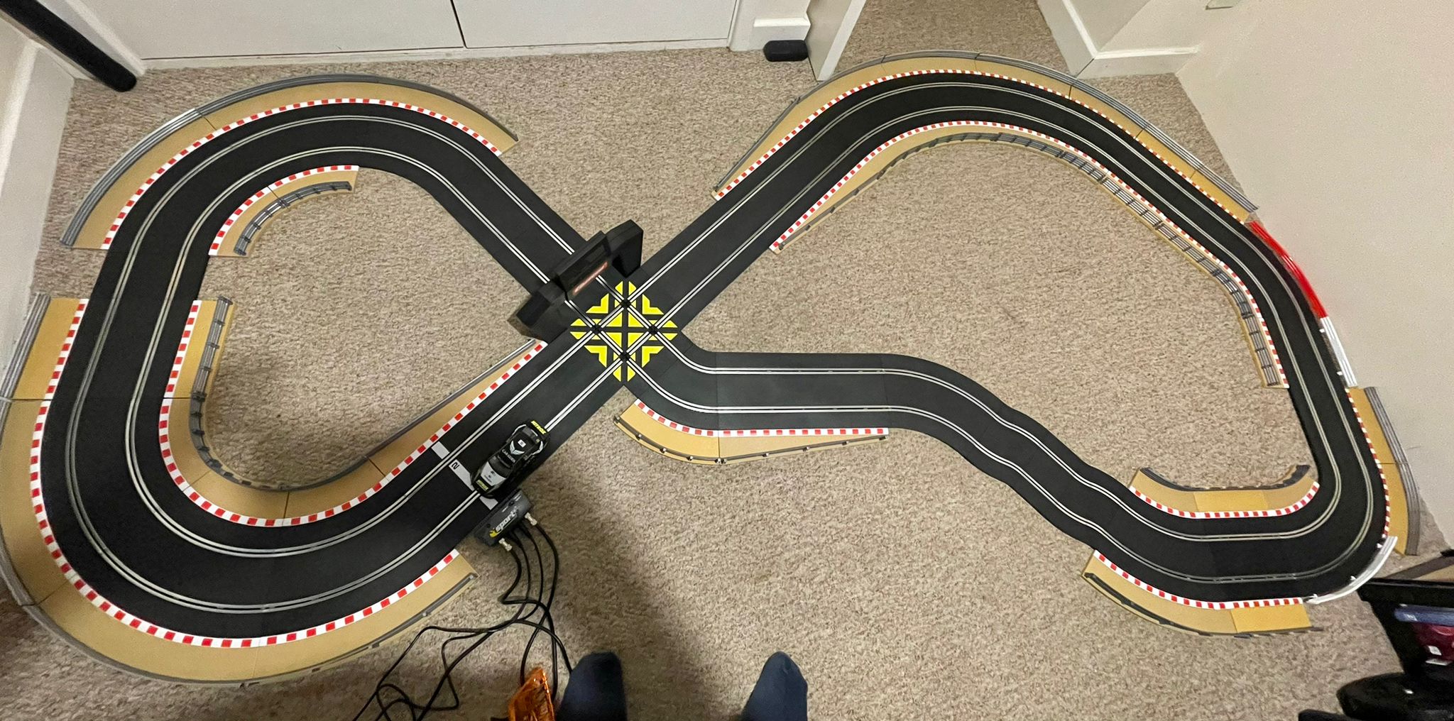

Great thanks a lot, I appreciate the link & advice! I should really dive into tuning the cars, it seems a little daunting but also exciting as I love modifying cars in real life to make them unique I'm sure it'll be relatively easy to make a few tweaks here & there thouigh knowing me i'll get obsessed haha
I have a fairly decent Scalextric setup in my space I'm really enjoying it tbh, only 2x R1 corners in the entire thing & it lets me push (and drift) the cars fairly fast
[Image: 2EqE15u]

#10
Here is my current Scalextric track in the limited space that I have, I feel it's about as good as I am going to get if I like long sweeping corners like this setup has
If anyone has any adjustments they would make please let me know! Thanks
