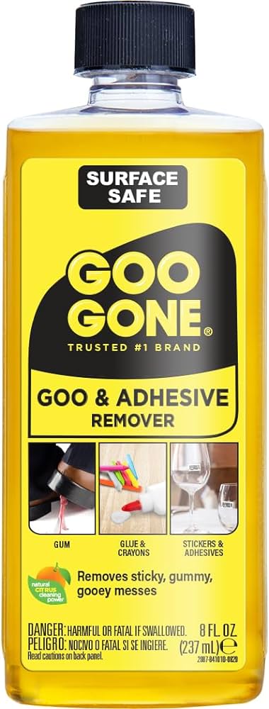

We have a tin of servisol sticky label remover at work, citrus based, it would probably work great.
Posts: 2,054
Threads: 131
Likes Given: 3,125
Joined: Sep 2020
This product is designed to remove adhesive residue. It is also citrus based.
