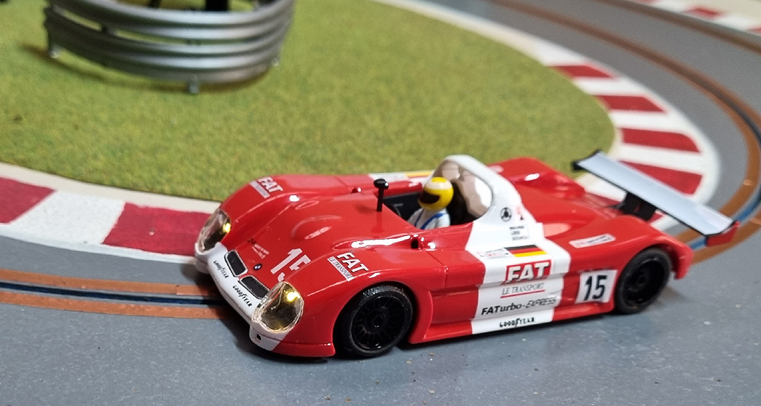

Anyways, Angelo kindly managed to fit in my request to produce this chassis so I could use it on one of my "Endurance 2022 proxy" entries.
Although the rules are Inline or Sidewinder for the class this car is in, I asked that the chassis be made compatible with AW/SW and IL.
The stock body needs no cutting to accommodate any of those configurations with Slot.it pods.

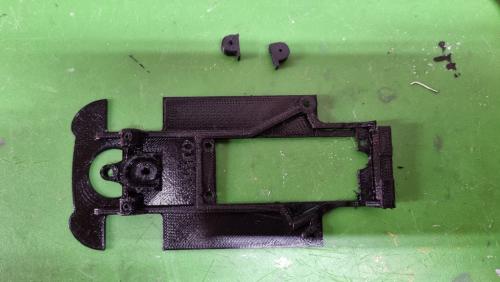

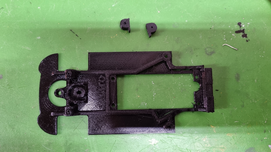

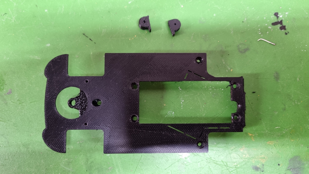

The stock chassis rear mounting was right in the way of where a Slot.it pod has it rear screws, and there is little room further back.
Angelo opted to provide 2 side fixing mounts with the chassis, to be fixed forward of the rear wheels.
You can see the original rear mounting posts in the  picture along with the epoxied in position replacement mountings.

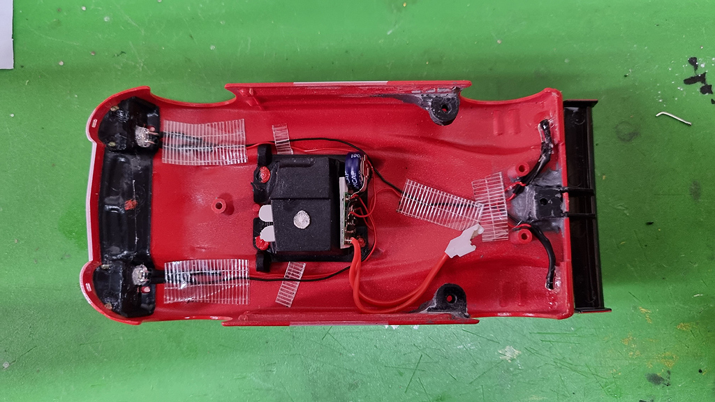

Excuse my messy wiring, in my years of building slot cars, I this was my first attempt at lighting one  Bigsmile

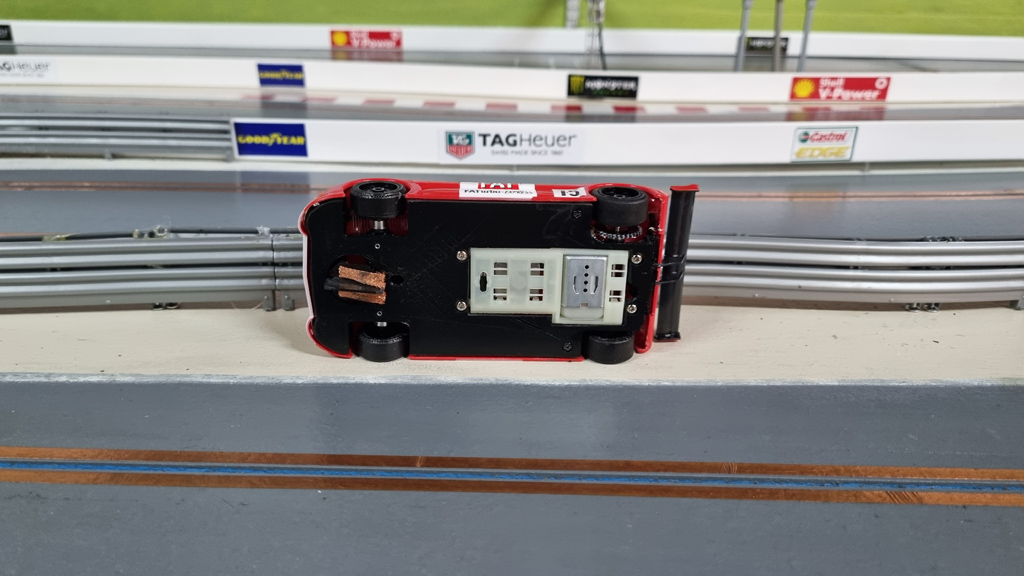

As usual, everything fitted perfectly with just a bit of trimming to obtain the pod and body float I desired.
And with some smooth shank screws I can obtain a nice degree of body rock.
