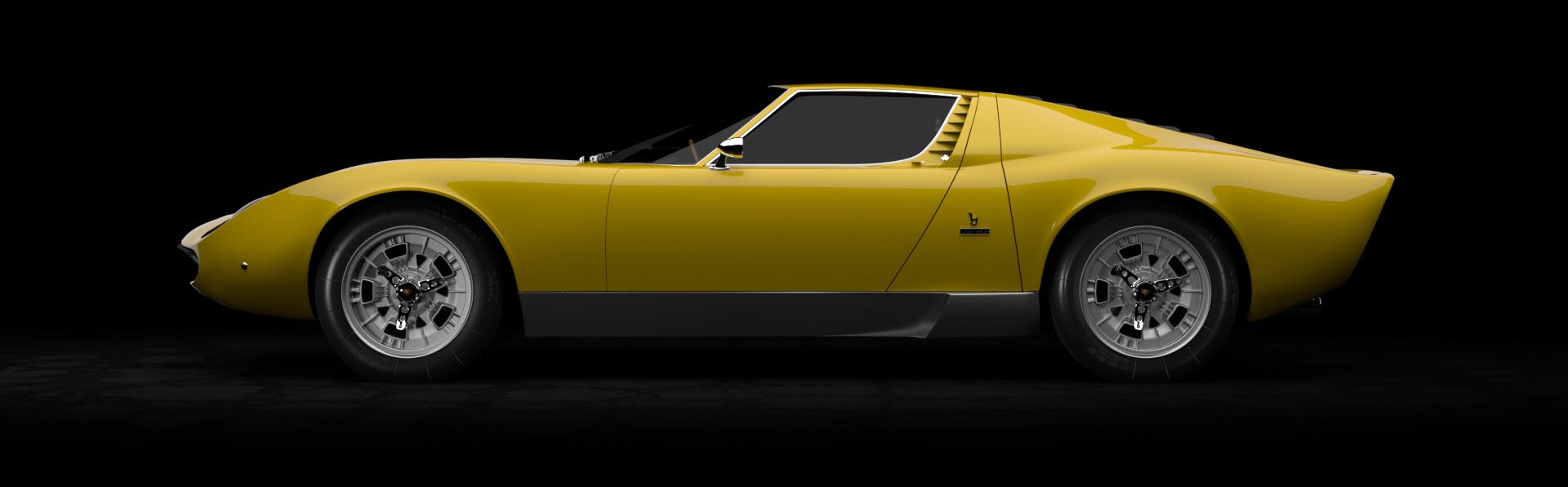

This Lamborghini Miura is an example of a 3D model created in Blender, so you can see that the software is quite capable of producing high quality models and renders, in the right hands. This isn't my work, I'm nowhere near this level of skill as yet, so I simply downloaded the free model from Blend Swap.

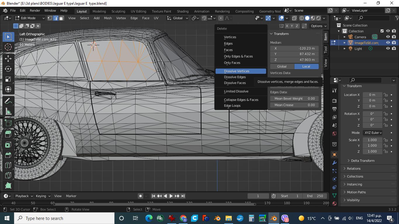

There are four possible viewport modes, wireframe, solid, material preview, and rendered which you'll no doubt switch between as you model.

There is a choice of render engines, with the best and at the same time slowest, being Cycles. It is excellent but the Lamborghini image above took several hours to render, though again that's not unusual.

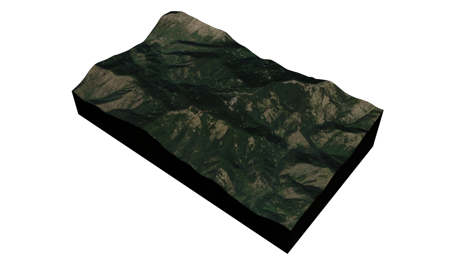

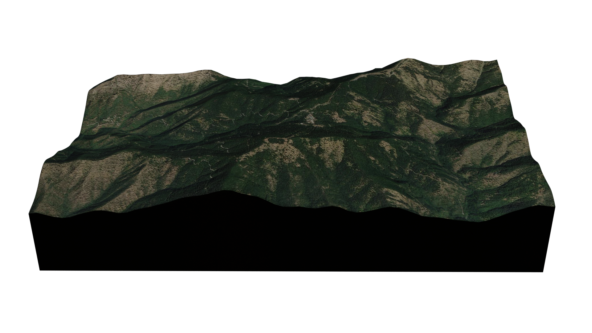

A non standard add on will also map terrain for you, using images from google maps and height maps from NASA. Let's be honest, who wouldn't want an accurate 3D map of the Col de Turini?

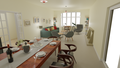

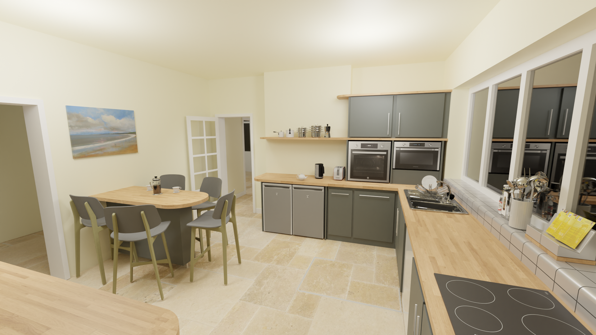

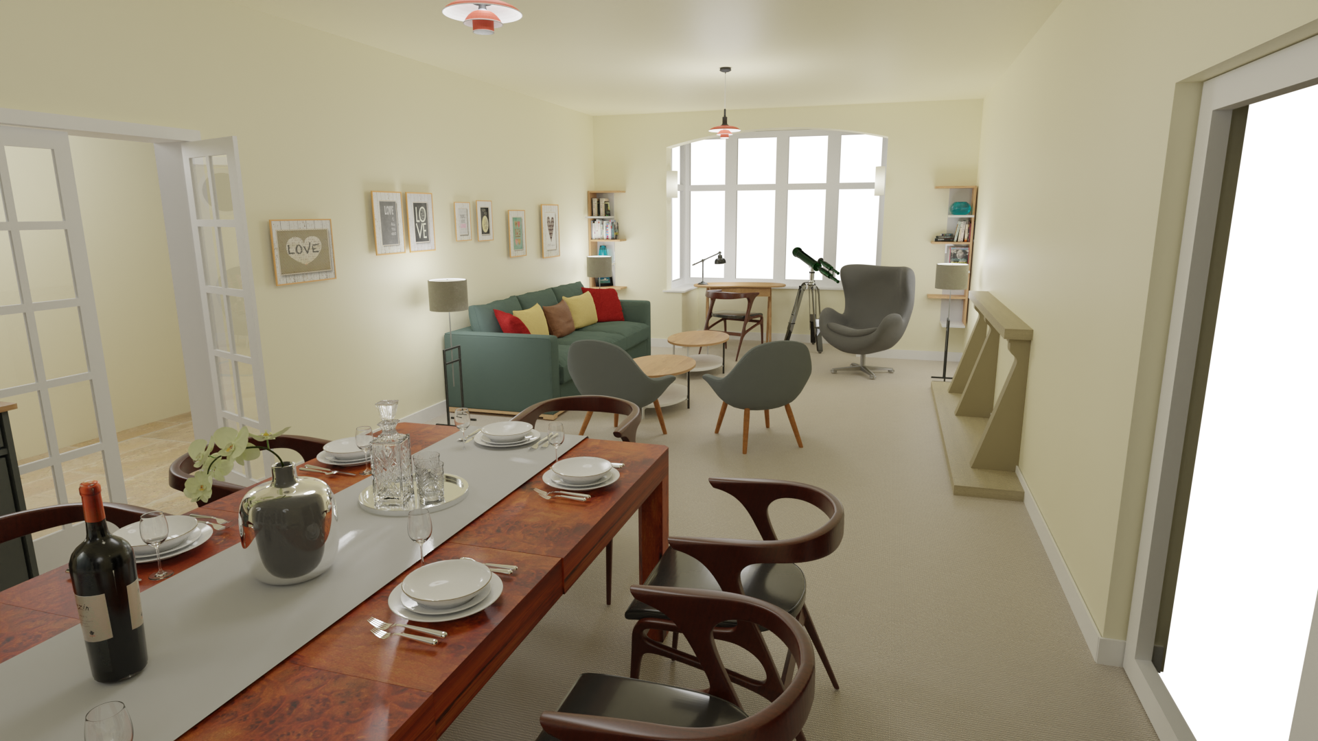

This is where I'm up to on my journey. These are just some models I did of some alterations we want to make at home. Fairly simple shapes to create, with the addition various imported models.
