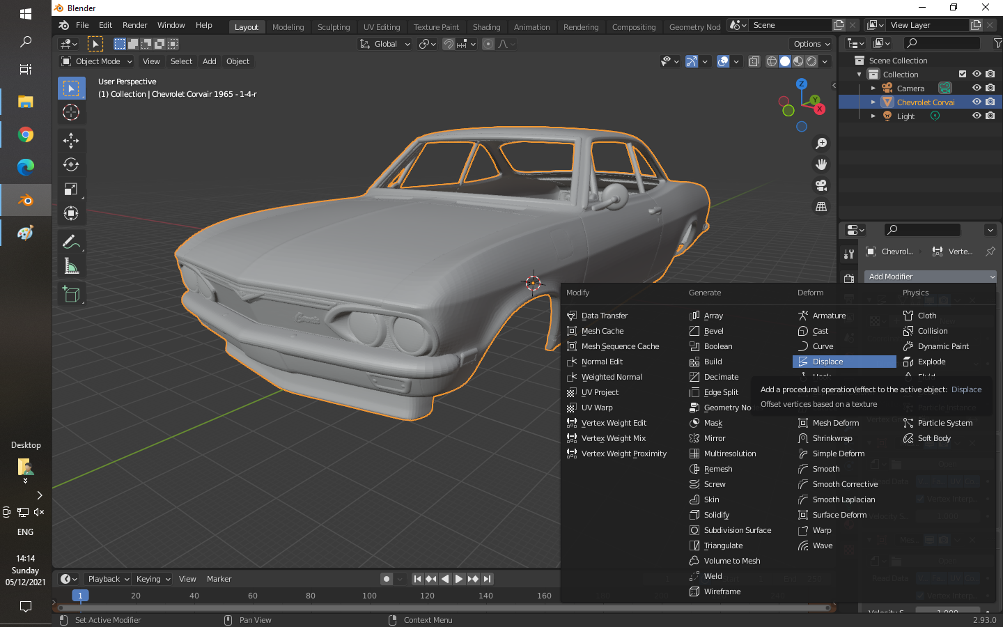

This tutorial is very useful, when you have a 3D file that's too thin...or too thick you can modify it with the 'Displace' tool.
'Displace' adds or subtracts thickness, the default 'strength' is 1.000 which is 100% increase in thickness.
0.000 'strength' would be no change, -0.100 would be 10% thinner and 0.100 would be 10% thicker.

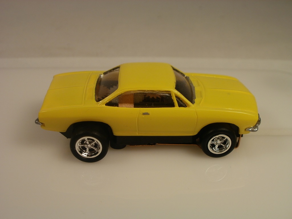

You sure picked a rare bird for a demo. I had to scower the planet for these Corvairs. It gives hope to rare slot car bodies.
1/32

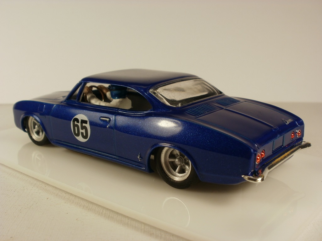

Me too Kev. I have seen several pics of the blue one on Google Images. It looks like someone stuck F1 rear tires on a Corvair. Sweet!

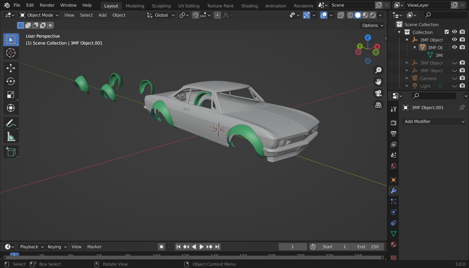

My plan is to modify the 3D file to add arches like the blue one.

When I can suss out Blender Boolean I'll be ok...
