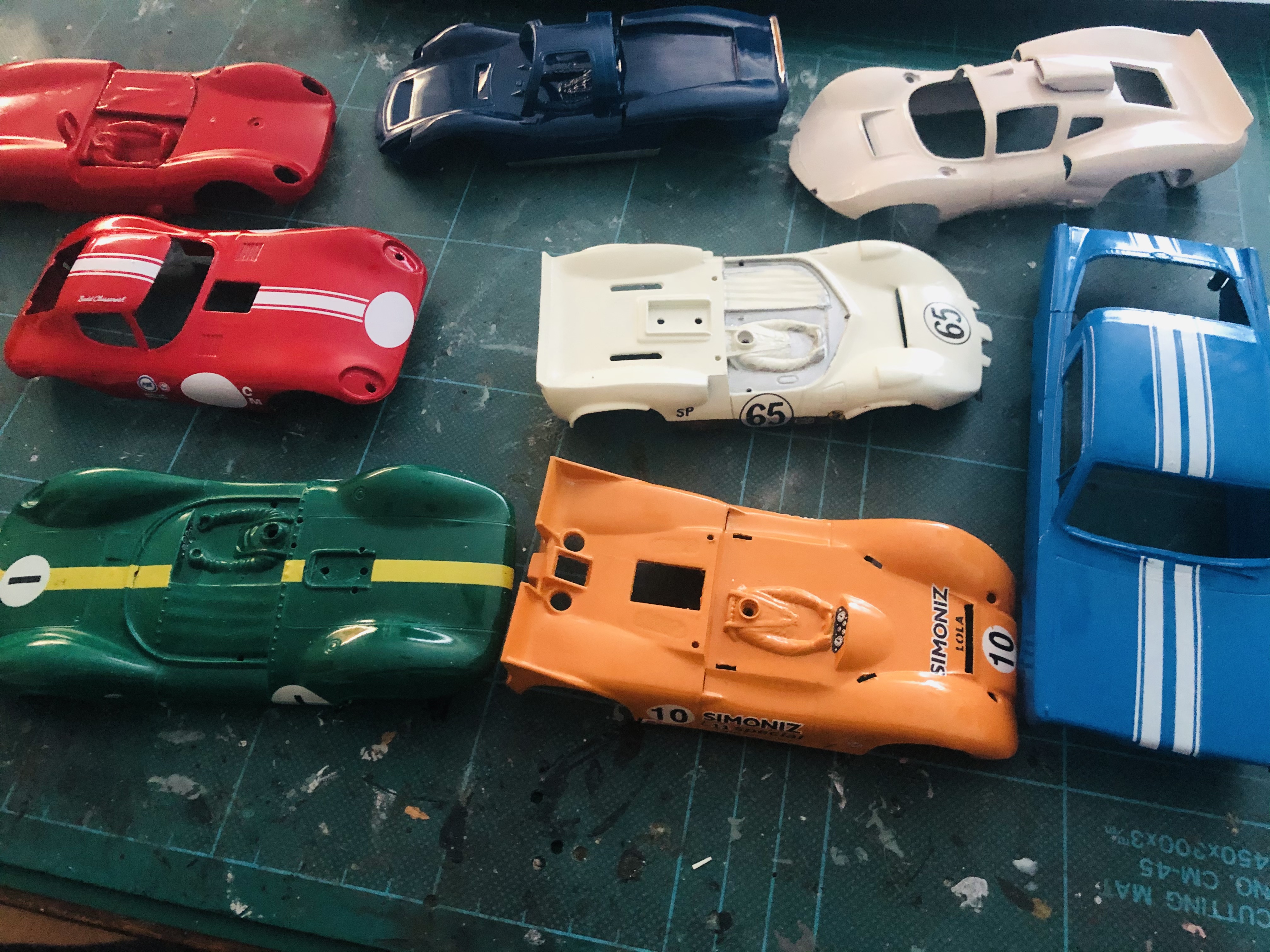

Showing 3 of the various - and there were many - chassis types.
4 Of the bodies in this pic - Plymouth Barracuda, Lotus 30, Lotus 19 and Lola T 160.

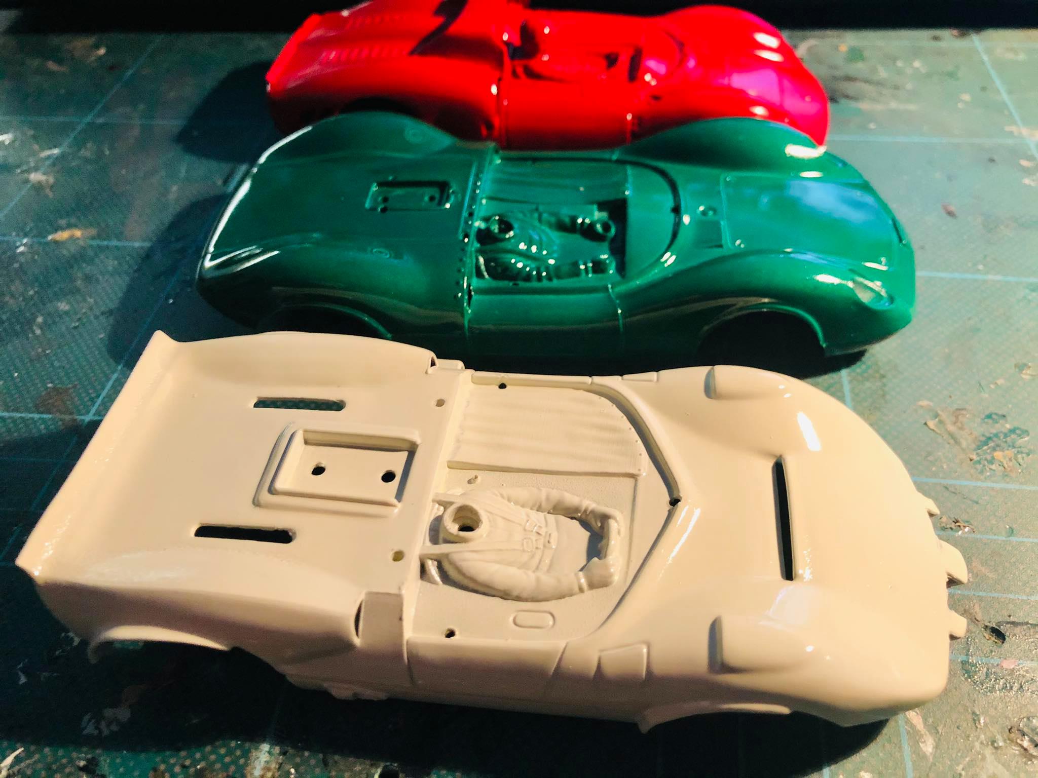

I cleaned the bodies, and primered.
I have painted 4 so far.

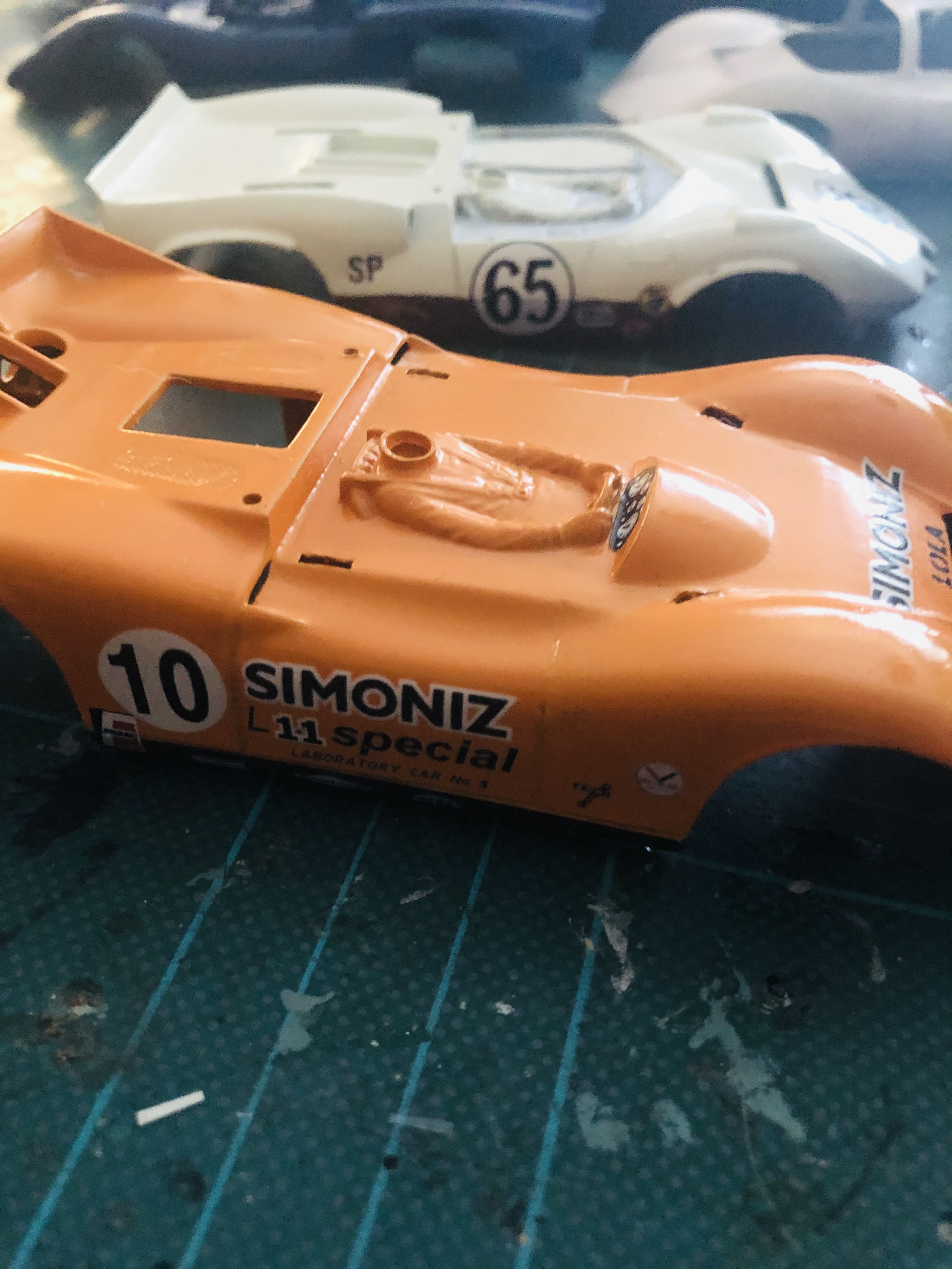

The 4th is in the pic below with some of the other cars that need to be done as well.
