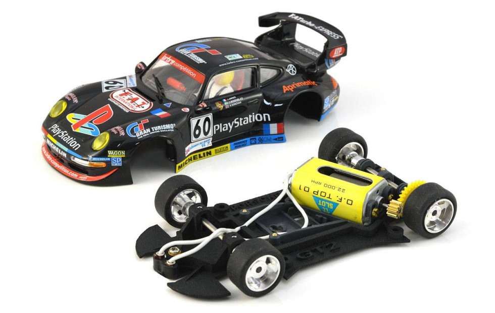

The folks at Pendle Slot Racing have been busy over the past few months. Not only have slot cars and parts been flying off the shelves during lockdown, the Pendle team have been making huge progress with a number of exciting in-house projects. Probably the biggest of these is the development of a plastic chassis alternative for the RevoSlot cars...
Pendles are the UK distributor for RevoSlot. Although the new range of 1990s GT and prototype sports cars has impressed enthusiasts, the metal chassis and 3mm axles seem to have been off-putting to many potential customers. To try and bridge that gap, Pendles have developed their own 3D printed plastic chassis for the RevoSlot bodies - chassis that take the same motor pods and components as other high-performance 1/32 scale brands...
The chassis are printed by TA71 Modelcars, using state-of-the-art Multi Jet Fusion (MJF) printing with carbon composite compound treatment. This gives a very robust and lightweight chassis, ideal for racing.

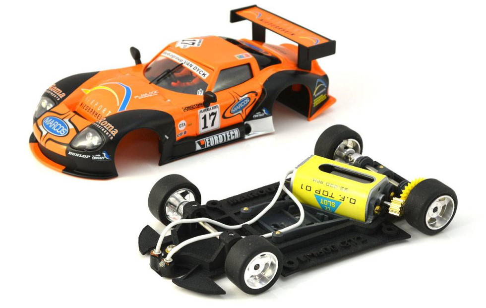

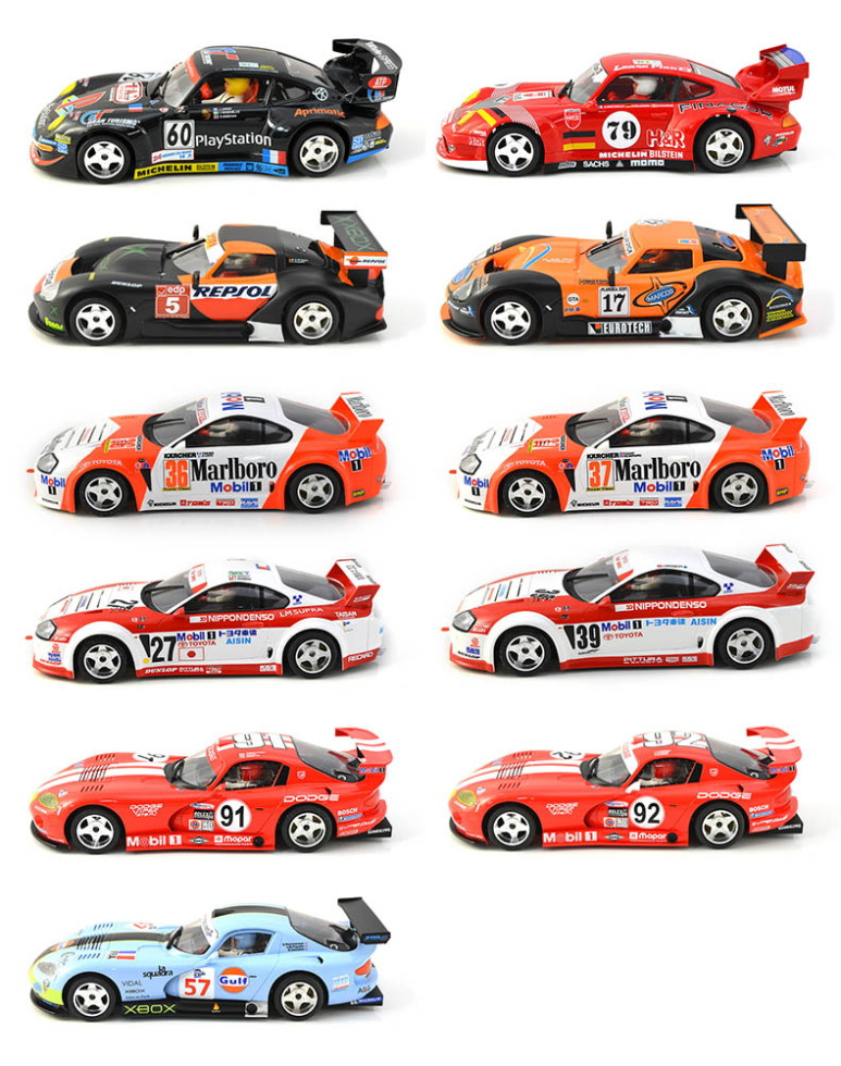

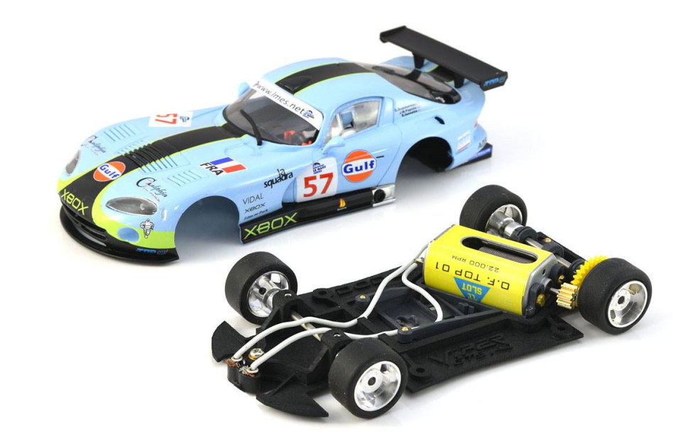

The first four models available in the PSR 3D Print Shop are the Dodge Viper, Marcos LM600, Porsche 911 GT2 and Toyota Supra - each with a different chassis - and  available in a total of eleven different liveries...
Each model can be purchased in two kit versions or a ready-to-run (RTR) car...
Option 1 Basic Kit - (Body & Chassis) Price: £45.00
Fully decorated RevoSlot Bodyshell and 3D printed chassis.
1x RevoSlot Bodyshell
1x PSR MJF 3D Printed Chassis

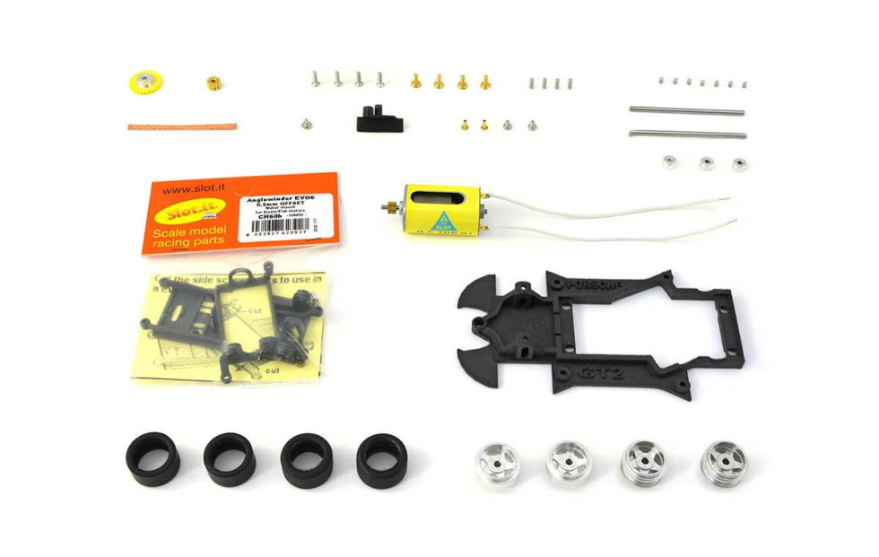

Option 2 Complete Kit - (Body & Complete Chassis) Price: £85.00
Body Kit and all the parts supplied so you can assemble into a complete slot car.
2x STAFFS01 15.8x10mm 5 Spoke Air Wheels (Rear)
2x STAFFS12 15.8x8mm 5 Spoke Solid Wheels (Front)
2x SIPA01-54 54mm Axles
3x SIPA25 Axle Stoppers
1x SIGA1828pl Nylon AW Contrate Gear
1x SIPS11 11t 6.5mm Brass Pinion
2x BRM102sr 18x10mm Rear Tyres
2x SIPT1159-C1 17.2x9.5mm Front Tyres
1x SICH60b 0.5mm Offset AW Motor Mount
1x SICH85 Screw in Guide
1x PSR E17a Braid
2x W8111 Eyelets
1x AS001 22k Long-Can Motor
2x PSR E25 Motor Screws
4x SICH54b Motor Mount Screws
4x PSR Body Screws
4x PSR E19a M2x6mm Grub Screws for Front Axle
Option 3 RTR - (Body & Complete Chassis) Price: £125.00
Tuned in house by our experts - supplied race prepared and ready to run with trued tyres.
2x STAFFS01 15.8x10mm 5 Spoke Air wheels (Rear)
1x SICH60b 0.5mm off Set AW Motor Mount
1x PSR E17a Braid
2x W8111 Eyelets
4x PSR Body Screws

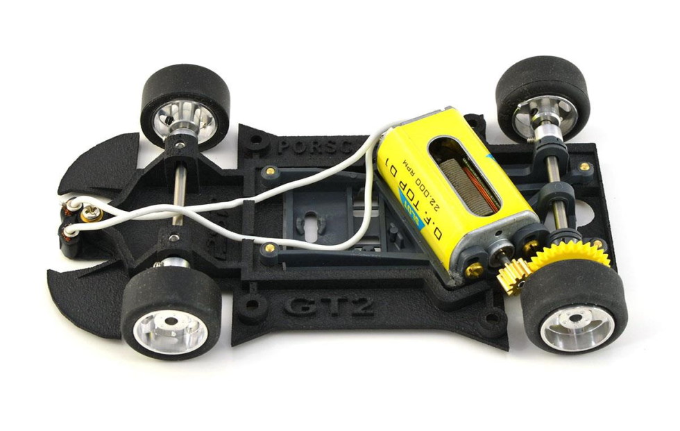

Anyone who has dipped into builds with quality 3D printed chassis will know those prices are par for the course. The RevoSlot bodies retail for £25 and £20 for a printed chassis is pretty standard. For most racers, that 'Option 1' will be exactly what is needed. The rest of the parts will be a personal choice - or dictated by club rules - and may already be sitting in the parts box. However, the full 'Option 2' kit may appeal to home racers and those building a car for the first time - the kit includes everything you need.
One observation is that the chassis could have been designed to take a digital chip, such as the tiny Slot.it Type-C decoder - which is cross-compatible with the Scalextric, Carrera and Slot.it oXigen digital systems. Sadly, the chassis does not make fitting a digital chip easy at all. I suspect the plastic chassis option will be particularly interesting for digital racers, so this is a shame. However, the joy of 3D printing is that revisions can be made for future print runs.
This is a bold and exciting venture into new territory for Pendles. Along with the RevoSlot compatible chassis, the PSR 3D Print Shop will be producing chassis for resin body kits and some useful parts for using the Policar F1 gearbox with Penelope Pitlane bodies.

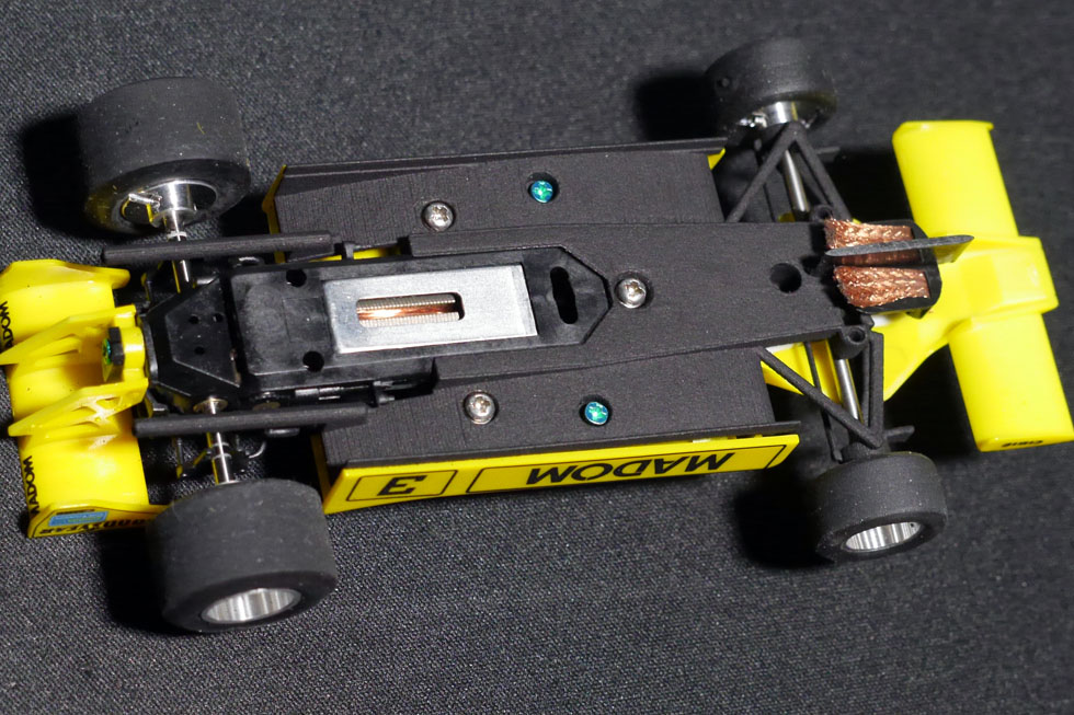

Another avenue of 3D printing I've used is Andi Rowland's 'ARCO' chassis to convert Scalextric, SRC, Fly and scratch-built classic F1s to use the Policar drivetrain. These small chassis attach to the Policar motor pod. They are produced via Shapeways and cost £16 (plus shipping) or £13 for the unfinished white plastic. Not cheap, but a fabulous option to produce a grid of F1 cars that will race against each other with the same Policar drive train. Again, a Lotus 78 I built to race did cost more than a RTR Policar F1 - and that was including a budget £15 Fly donor car. I did it because I really wanted to, not because it was a cheap option. Great fun to drive and it is competitive...

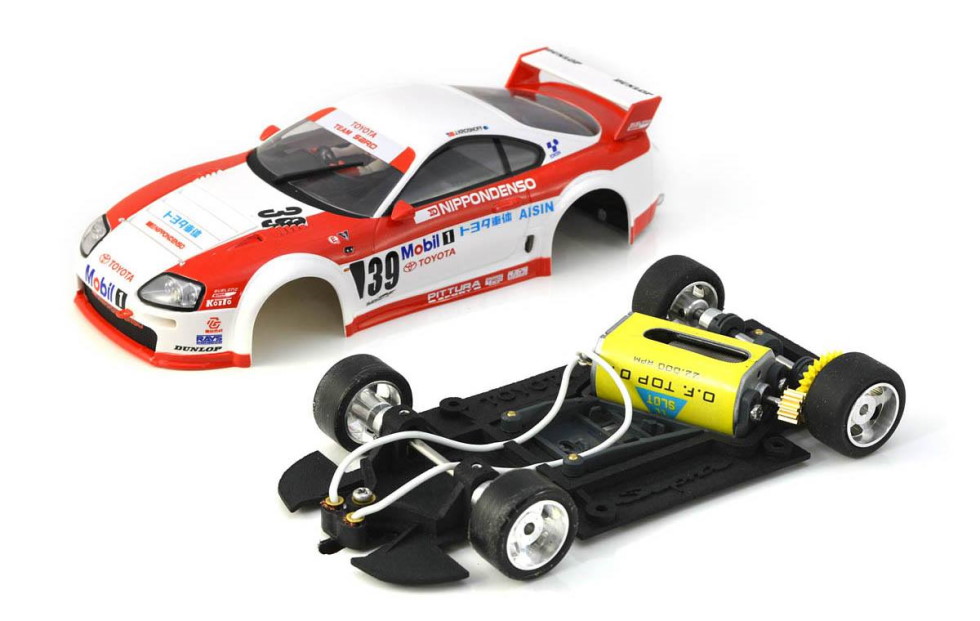

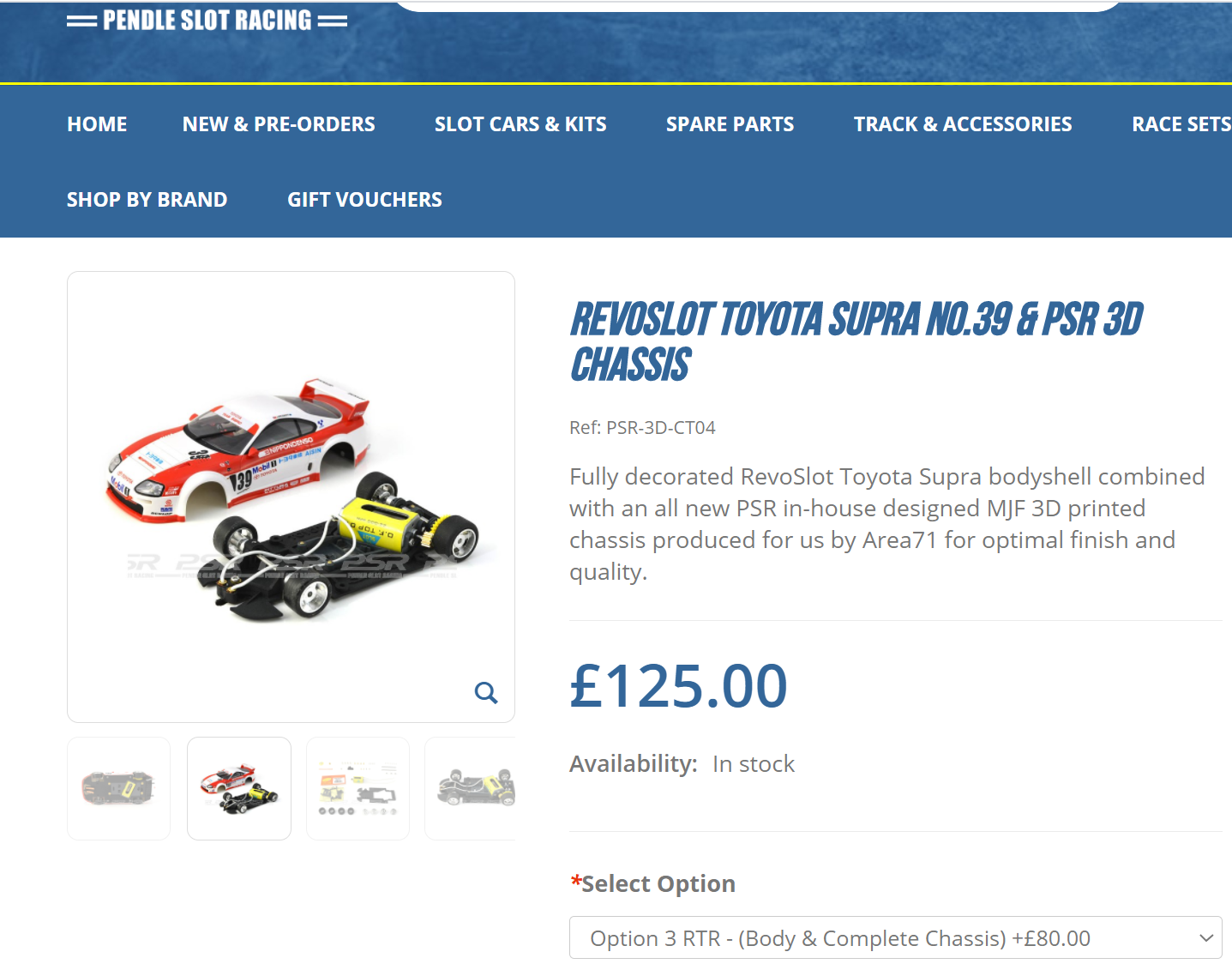

Ref# PSR-3D-CT04 - RevoSlot Toyota Supra No.39 & PSR 3D Chassis
Recently I've bought four Revo metal chassis cars for a new class in our group racing and out of the box the Dodge Viper has so far been the absolute best, requiring only front and rear tyre truing.
One other required front and rear tyre truing, chassis isolation (using Gorilla Tape) and adjustment of the motor, the others required motor adjustment and front and rear tyre truing. All fairly easy to do and at a reasonable cost.
As mentioned for $225 AUD I'd be expecting and demanding these are perfect out of the box.

I have also used Andi Rowlands chassis for Policar F1 conversions and have been pleased with those as well. A Policar conversion for a Fly F1 is expensive mainly because you have to buy a complete Fly car and I have been happy to put my hand in my pocket when I have wanted a particular car.
