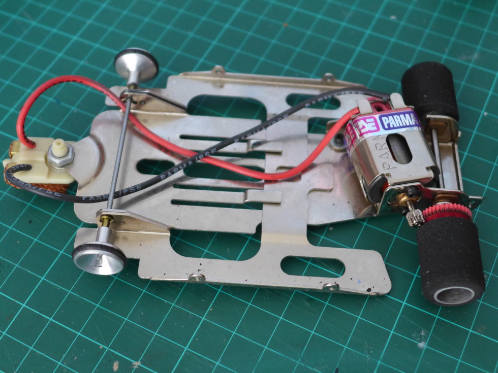

There are dozens of other 1/24 scale metal chassis options too (eg Parma, Champion, Scaleauto etc) - most of which can be supplied ready-to-run. However, depending on the amp-rating of the wiring on your layout and the controllers you have, you'll need to carefully choose what motors you use - nothing massively powerful. And you are likely to be limited to the bigger Pattos bodies with some of these chassis that have no adjustable width or wheelbase. To show what I mean, here's my very ancient and very entry-level Parma Flex-2...

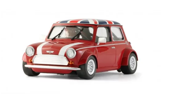

Another option to think about is the BRM mini saloons - they do NSU, Simca, Mini, Escorts, Opel Cadet and Alfa GTA - these are great little cars that offer close racing and are an easy way to get a group into 1/24 racing. Minimal setup required they work out of the box with some basic tuning. We love running them They are a hoot to drive.

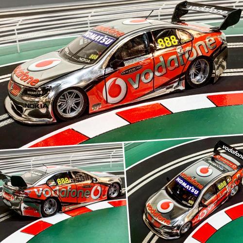

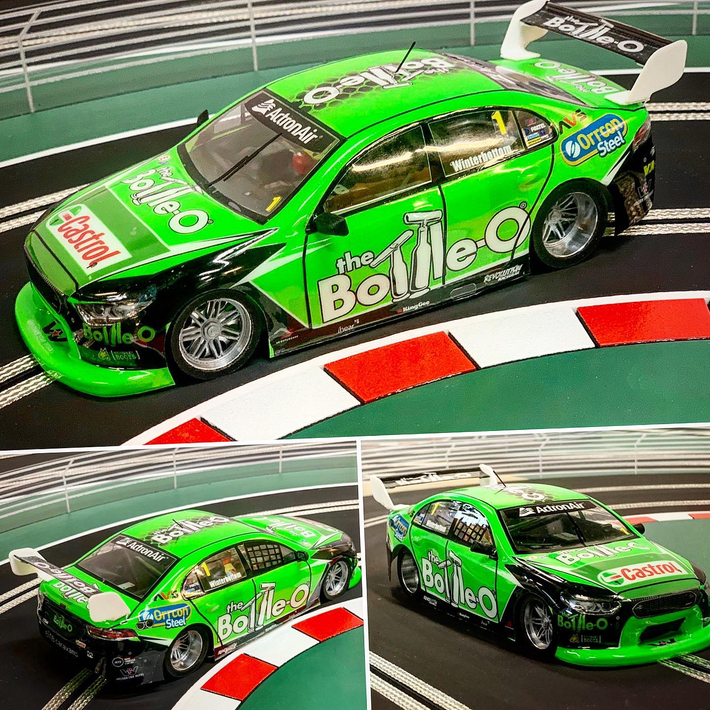

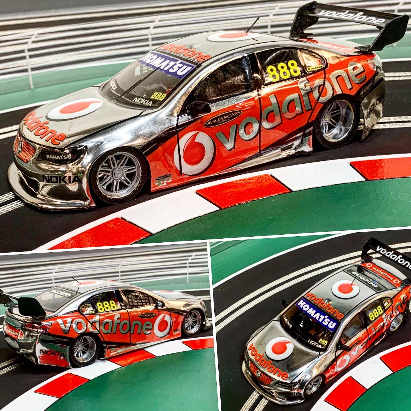

Well after procrastinating for several days, I decided to jump on these from MrSlotCar, Melbourne.
Slotworx V8 Supercar 1/24 cars, hand painted by Peter Dimmers
- Ford FGX Bottle-O #1 Winterbottom, and
- Holden  VF Vodafone 888 Whincup/Lowndes

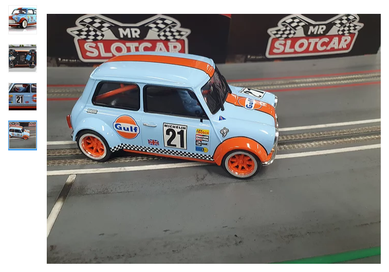

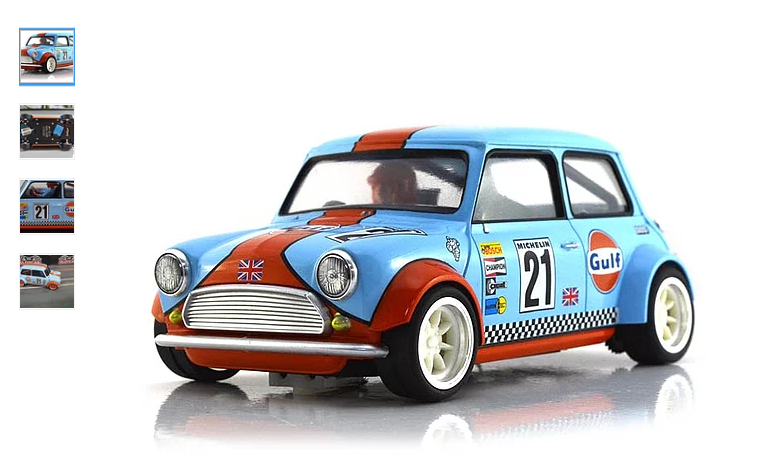

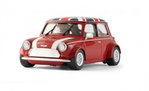

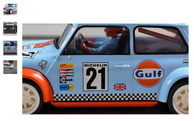

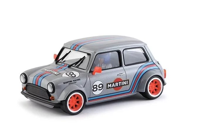

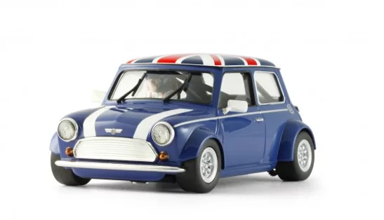

I've jumped into the 1:24 scale BRM Mini Coopers for a Host Class at Shenanigans Raceway. I hope the guys in the group like them.

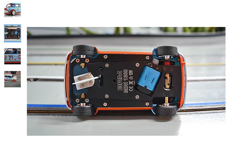

These little cars actually handle extremely well and are very fast with the 19,000 RPM motors and grip, oh my gawd do they grip, when they do deslot there can be some very OMG moments, the most recent we had one deslot and my car drove clean underneath the other car while it rolled in the air, wish I had the webcam recording, at least I've got a witness to this rare event and other spectacular deslots have been end over end, these deslots looked great.
Thanks to Peter H and Peter D from MrSlotcar, Hallam, Victoria for supply and basic setup of the cars, thankfully I requested the cars be checked before shipping as one of the rear axles was completely locked tight, BRM where is your QC guys?? for $200 AUD there should be no issues of any kind, yet here those QC issues exist still.
Another issue I've noticed after running is the front tyres rubbing against the front bumper on all four of the Coopers, this was easily fixed with some sanding down of the problem area, still... QC?? BRM
BRM-TTS 089 Mini Cooper Gulf No.21 a
BRM-TTS 096B Mini Cooper (Blue Union Jack)
BRM-TTS 096G Mini Cooper Martini #89 (Grey)
BRM-TTS 096R Mini Cooper (Red Union Jack)
