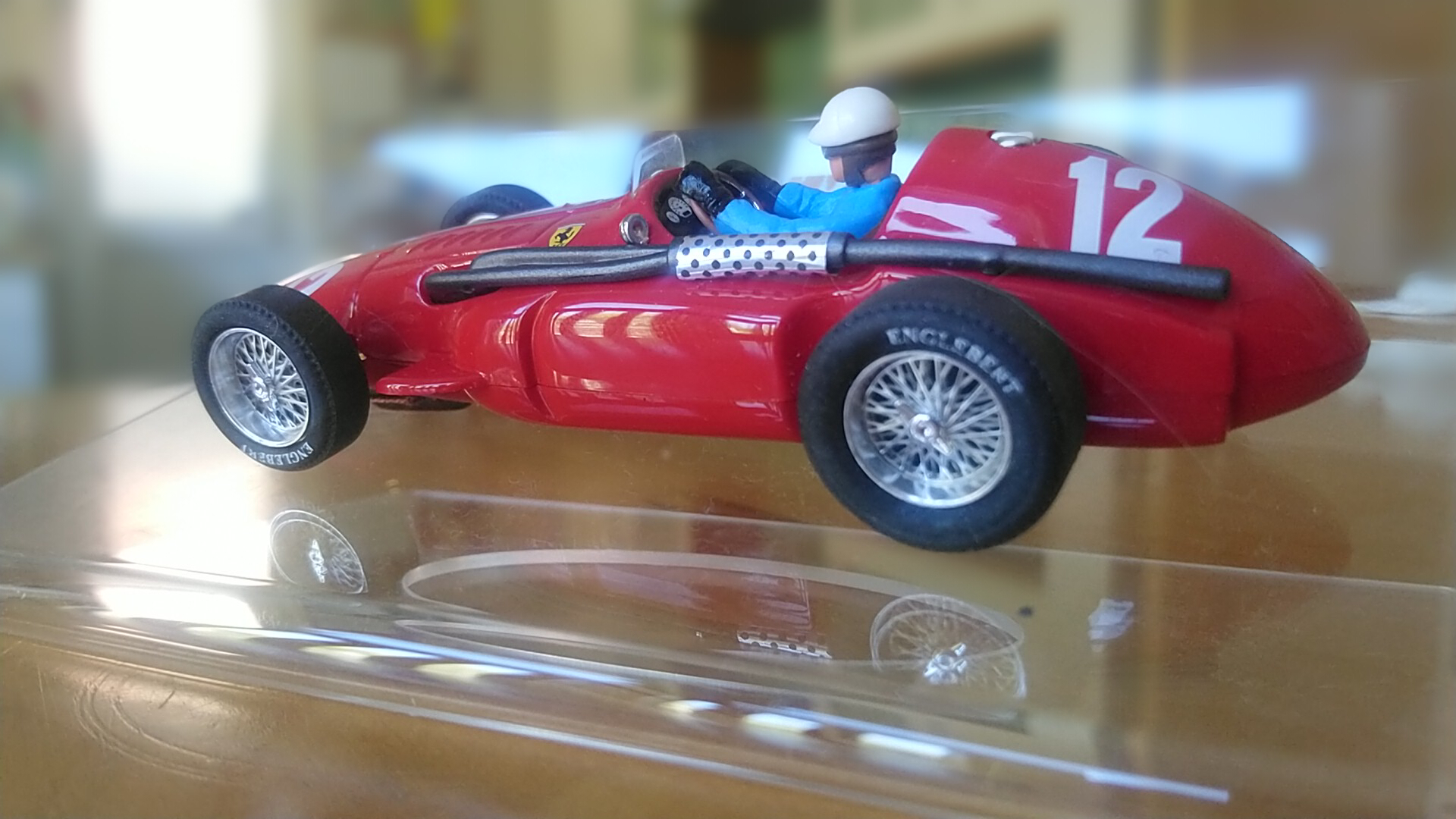

And onto the Richmond Trophy race, here is my Cartrix Ferrari with aluminum Mitoos wheels fitted.
Still got the original tyres fitted...not certain they are circular, or made out a material that supports friction.
Does anybody know what the options are with regards to sources for replacement tyres?
Thanks

Mike has made - or is making - some urethane tyres to fit the Cartrix hubs.
Posts: 2,488
Threads: 117
Likes Received: 2,808 in 1,442 posts
Likes Given: 7,390
Joined: Jan 2020
Location Eastbourne UK
Hi Andy. I thought I remember you say that, that's good to hear...although to be fair to those Engleberts, with a bit of sanding, they have started to do what they are meant to do.

Both Paul Gage and Dart Hobbies make urethane tyres (OEM sizing) for the Cartrix GP car range.
I am sure Colin Spark (RSSlotracing) also has urethanes to fit....and likely I have missed a few other folks,
Chris Walker
