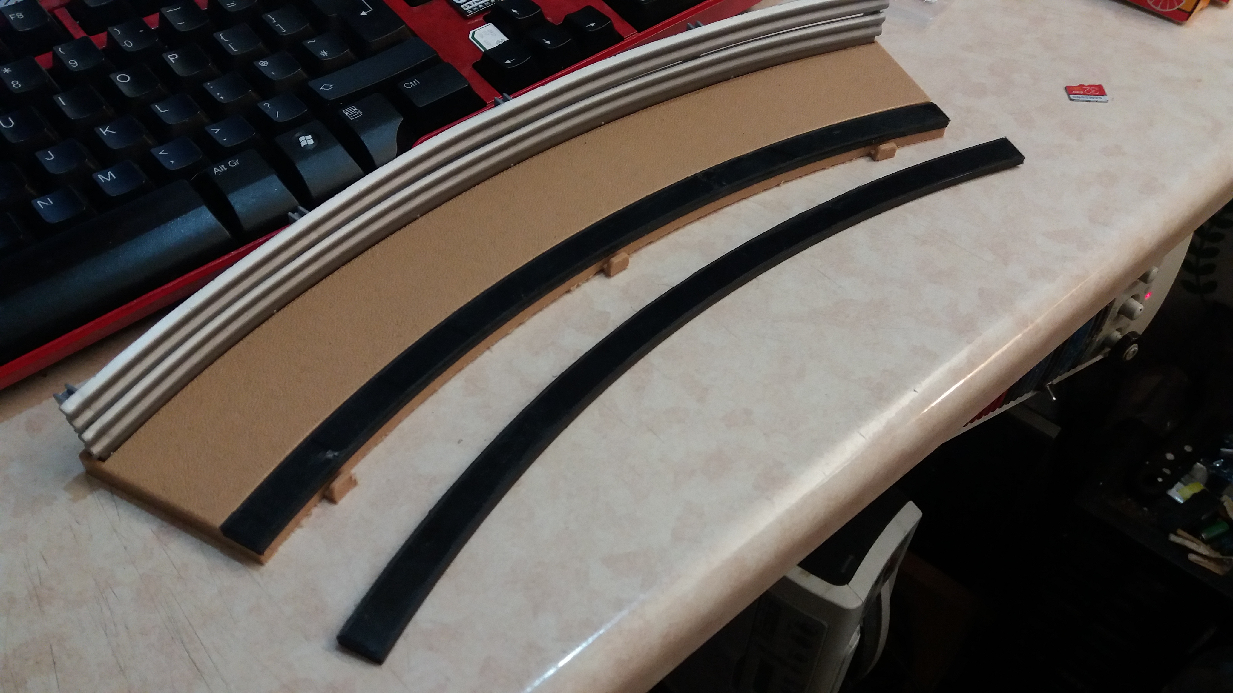

Hello Greg,
Huge thanks for your efforts on and for sharing your Scalextric border inserts. I hae long been annoyed with the red and white hump-back inserts and have attacked many of them with a Stanley knife to shave/scrape them flat. That works and doesn't take too long but it does create quite a mess of plastic shavings which are difficult to dispose of due to the electrostatic charge on them - also not good for the environment. Have printed 4 of your R2 Outer Border Inserts and will probably do some more. They fit perfectly and I glued them in Bostik as the Hornby borders will not take Cyano/Super Glue. Am printing them black because that is what PLA I have but tempted to find beige to blend in better.
Many thanks, Leo
Linky to Thingiverse
Excellent! I'm glad they are serving you well.
Unless you're in a hurry, hold off on printing more for a bit. I'm getting close to uploading a new set of inserts WITH CLIPS so that you don't need glue of any kind.
printables.com/@MrFlippant
[+] 1 member Likes MrFlippant's post
Cheers Greg,
I had noticed the comment about the "tabs" at the old place but appreciated your comment about the thin-ness of the tabs. Yes I'm interested in the new version so will hold off until then.  The Thingiverse notification doesn't work for me so would appreciate a nudge via this thread...
Again, thank you for your contributions to the hobby. (Slot-Cars and 3D Printing!)
I've updated my thing you linked to include the tabs needed so that glue is not necessary. Pay close attention to my description on the best way to install them.
Hello Greg,
Have got the files, thank you very much. Will do a print run tomorrow (26-Dec).
The "Images" folder has files all of type STL so I had to rename them to JPG. They include unrelated images for stuff (eg Name Tag).
I print onto blue masking tape so already got the textured finish Wrench (had not realised why).
Huge thanks, Leo
(26th-Dec-19, 12:12 AM)Scuderia_Turini Wrote:  The "Images" folder has files all of type STL so I had to rename them to JPG. They include unrelated images for stuff (eg Name Tag).
I'm not sure what that is in reference to, but I look forward to your results with the border inserts. :)
Hello Greg,
I am very impressed ! Thank you for this contribution to the Scalextric Community.
Have printed two R2 Outer inserts. Perhaps predictably, despite your note, I broke one of the tabs (centre lower) on the first one but was successful second time. I think easing out the slot a bit before fitting helps.
The inserts fit really well. In fact it feels like your inserts will actually be a better fit and stay in place more than the red and white standard "sausage kerbs" Yes
I guess that I was fortunate enough that I broke a centre tab so not having it is not a problem and that insert is still well retained by the other 5 tabs. Of course I could have still used glue if I had broken more tabs.
As I was fiddling with fitting the first one I was beginning to wonder if gluing in the tab-less inserts was a better arrangement but as is usual, the first attempt was a learning experience and now I am a confident insert inserter!
I am not a Scalextric Sport fan but my interest in these deepened when I recently discovered that Scalextric/Hornby have now made the "Scalextric Start" curve sections to the same dimensions so these borders will fit that.
Many thanks, Leo
