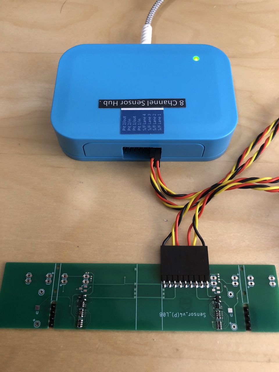

1/ IR signalling for lap counting and lane changing using the Mark/Space timing method with signal inversion for lane change. This is designed for up to 36 cars.
2/ Enhanced track sensors for reading the IR signals which use 4 phototransistors in a row for increased performance on high speed tracks.
3/ Wireless communications from throttles to a central wireless hub which onward broadcasts the throttle data to the cars in a single multi-car packet refreshed every 10ms.

Thanks for reading this overview post about the digital slot car racing configuration I am calling ‘System-D’.
