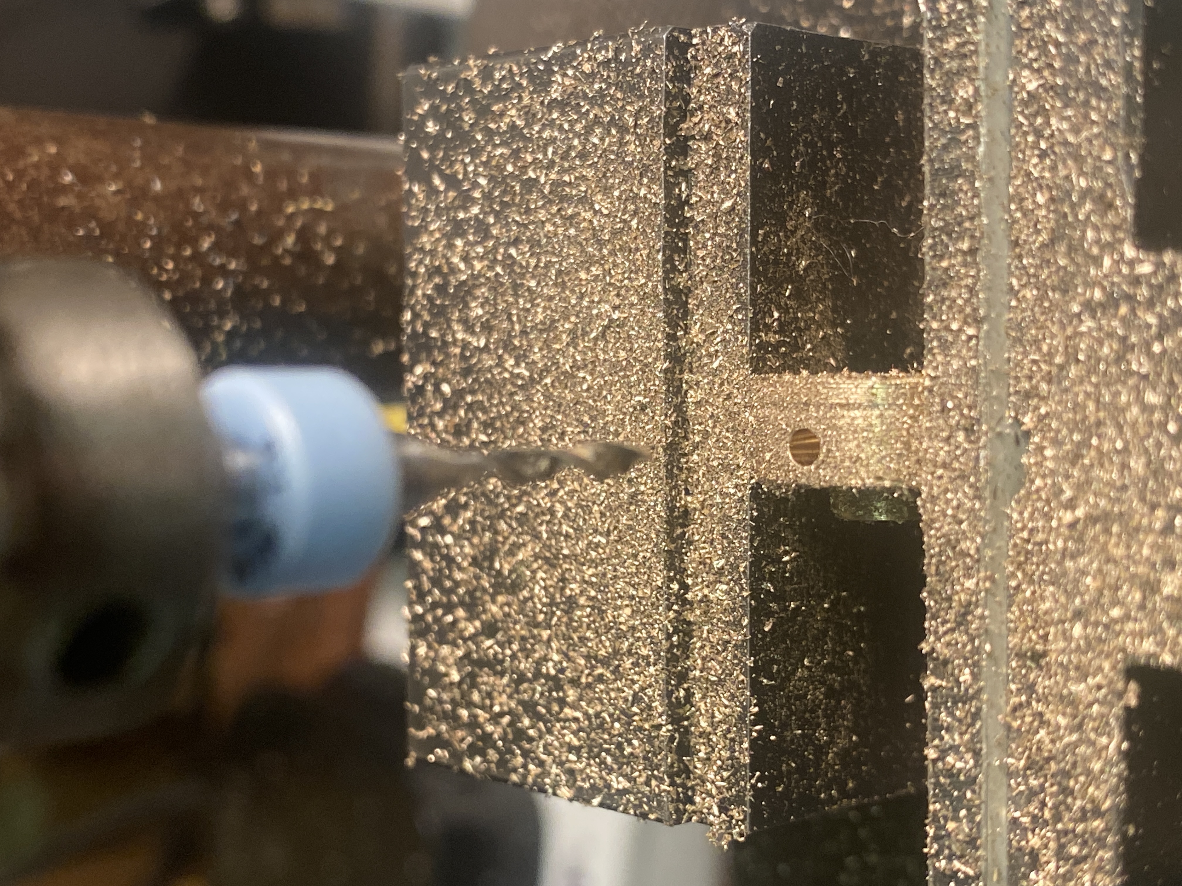

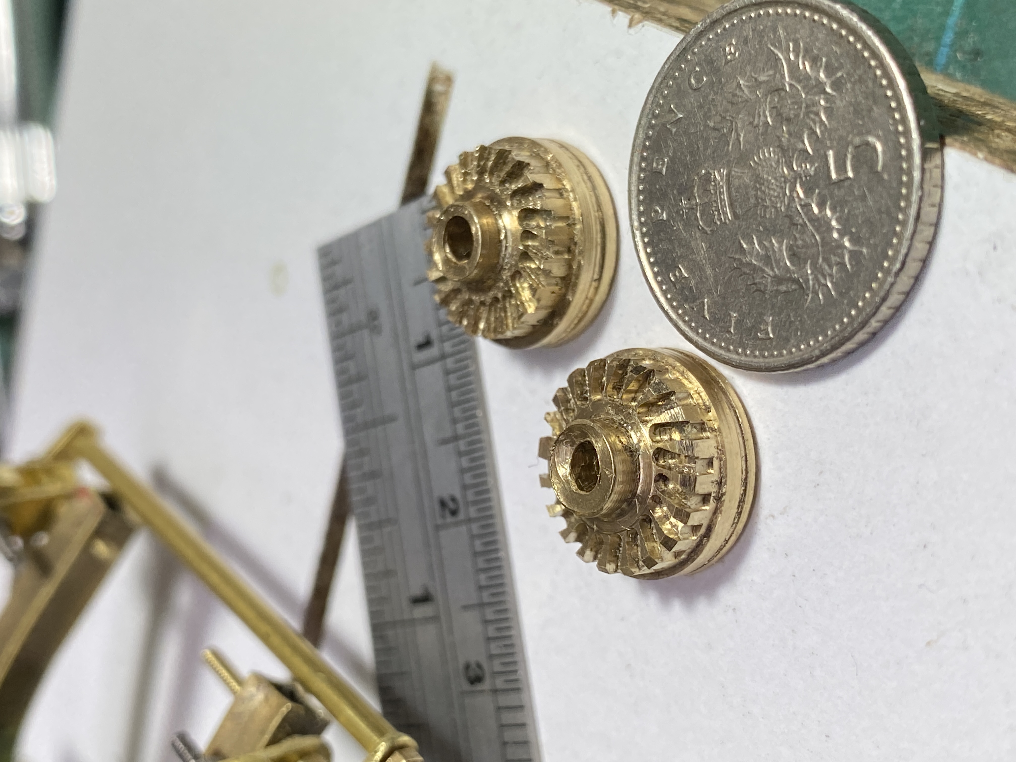

Hi all,
sorry I've not posted in a bit, I've been battling the cold in the garage and waiting on some tools etc to help me make certain things.
I could buy more nuts and bolts but I'd rather get more experience on the little lathe and mill I've brought.
Tonight I've just finished making the fake drum brakes which I'm pretty happy with considering I'd never used a Milling machine before, boy these little Proxxon's are lovely machines. I got mine really cheap as a lady brought it thinking it was more a pillar drill. Wrench
For the drums, I turned some brass and drilled the 3/32 axle hole, machined the little groove and then decided I wanted to try and machine some fins.
This was done with a dividing head made for the Proxxon Mill.
I then bored out the George Turner wheels for my brass drum to push fit in, I will glue these eventually.
Oh and drilling and tapping the little grub screw was really rewarding, harder than it looks. Well it was for me.
