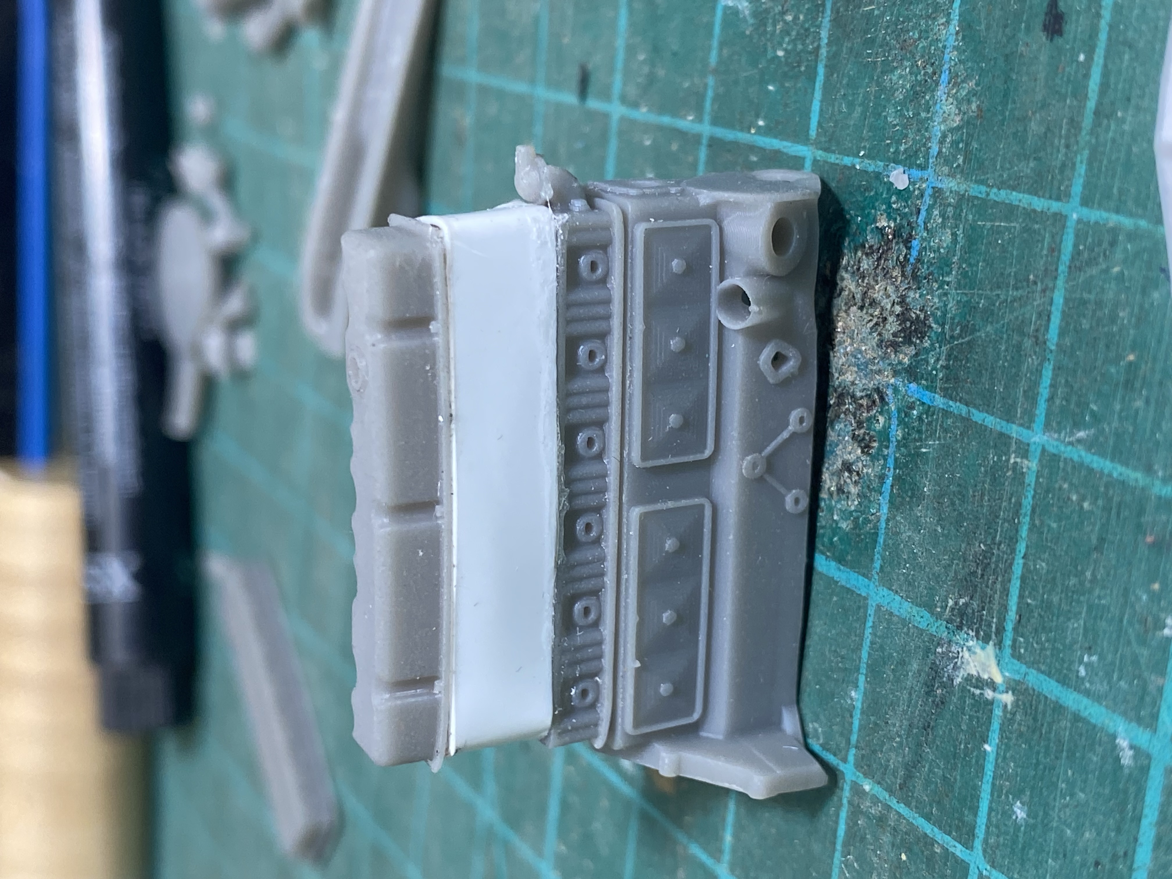

I've just started a new scratch build which is going to take some time as I want to try and make the detail like a model, but it will be used because after all that's the point.
I've followed Magnus on instagram for some time watching him build this awesome car, I contacted him and asked if he's ok with me doing so and he has thankfully sent me loads of photos.

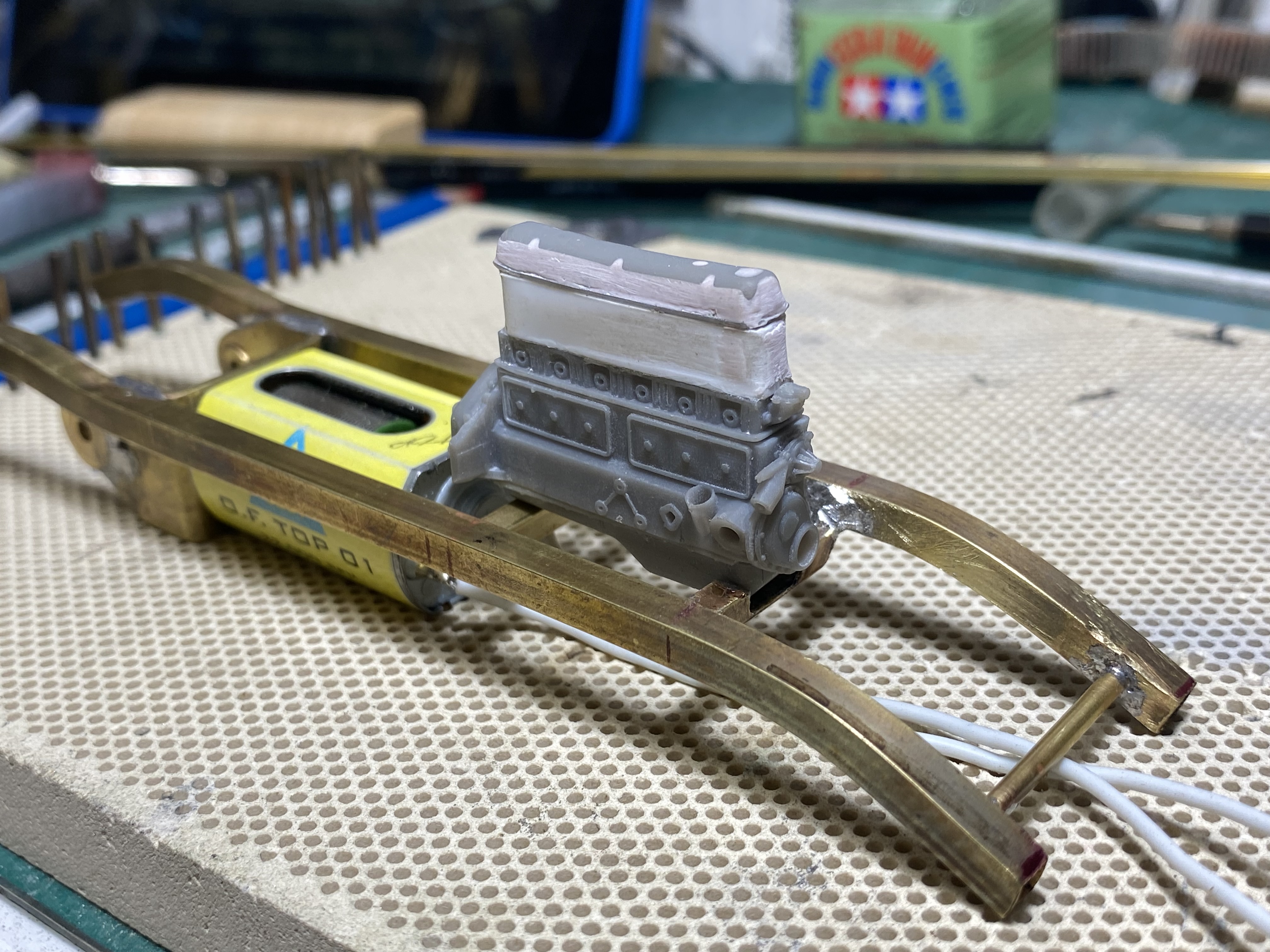

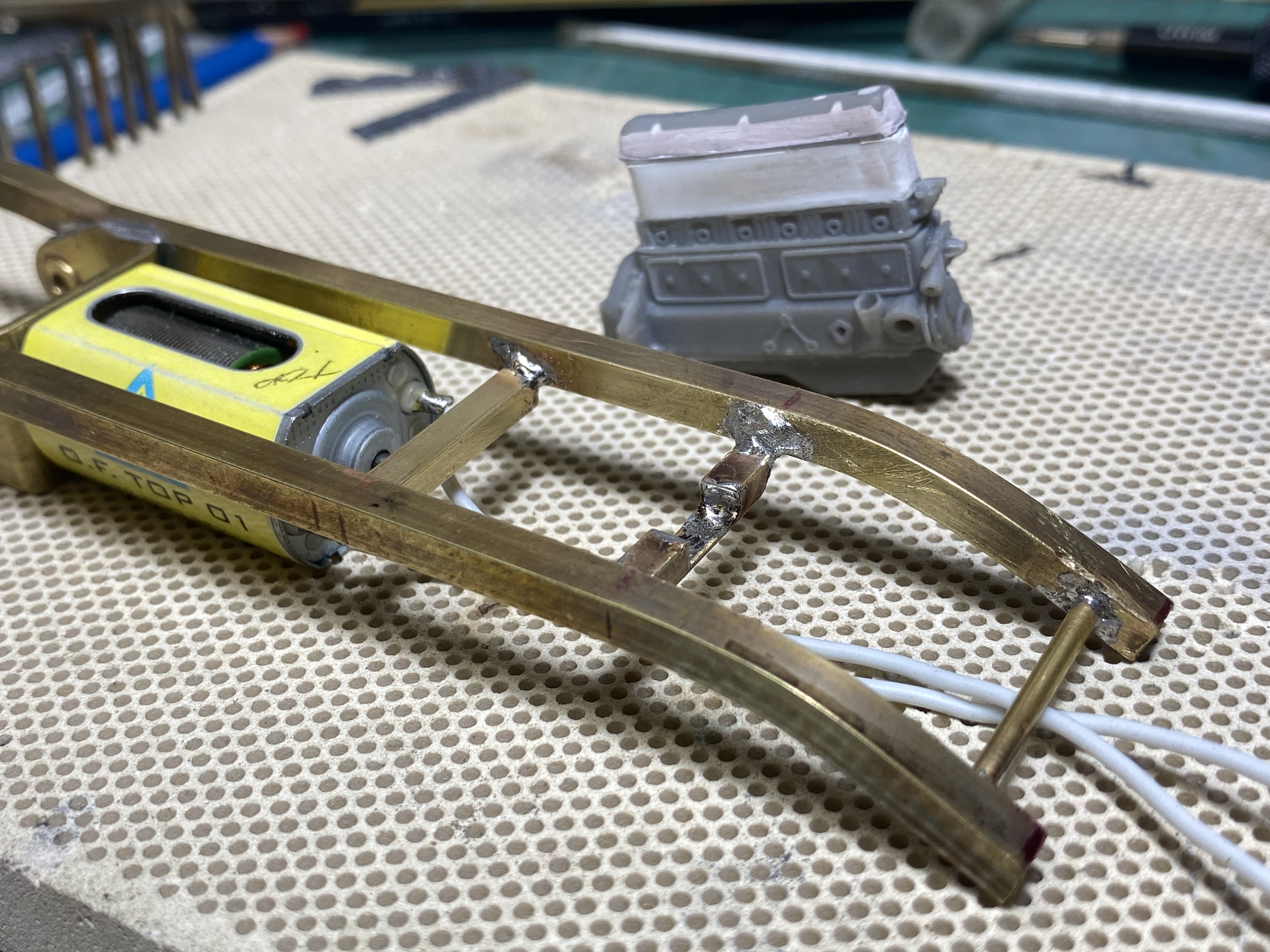

The chassis work has been a little challenge trying to figure how to bend the brass more than one way.
I've managed to get it where I'm happy.

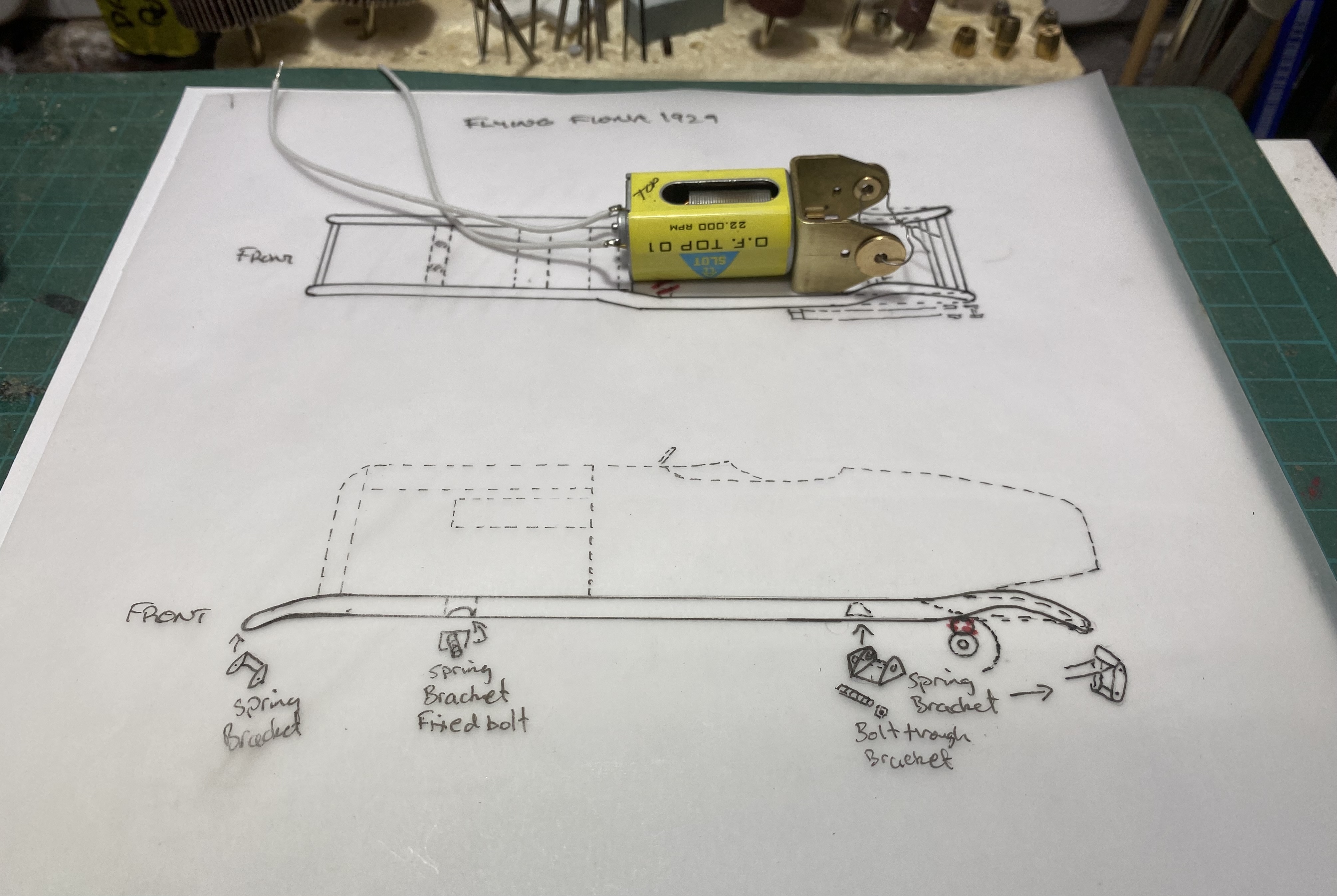

I drew up a plan for scale, I've changed the shape of the back part of the chassis as I got some new pics.

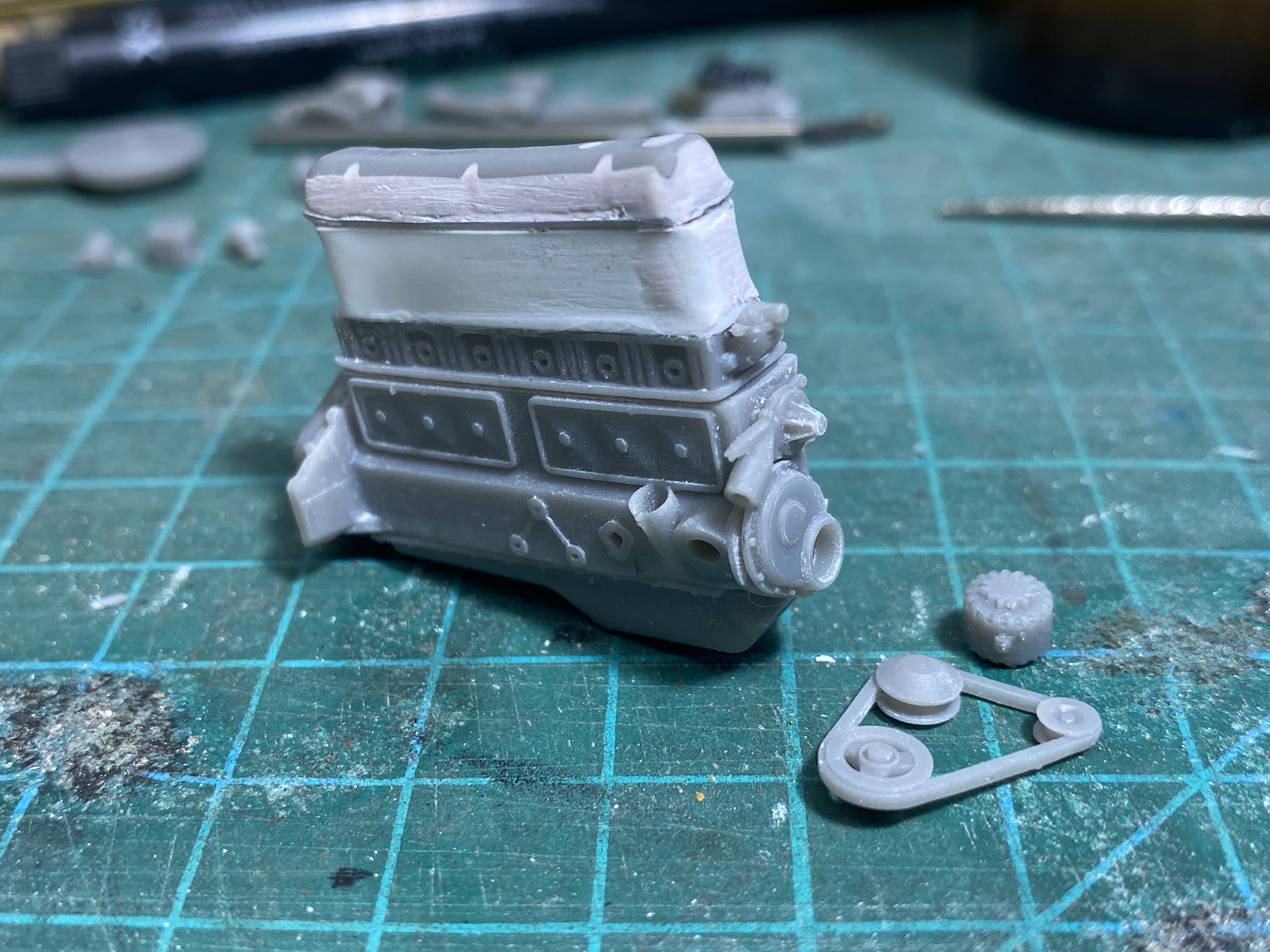

The motor, I found a stl file on thingyverse and had my friend Paul print it for me plus a gear box.
The motor has be customised with something done to the top section above the head.

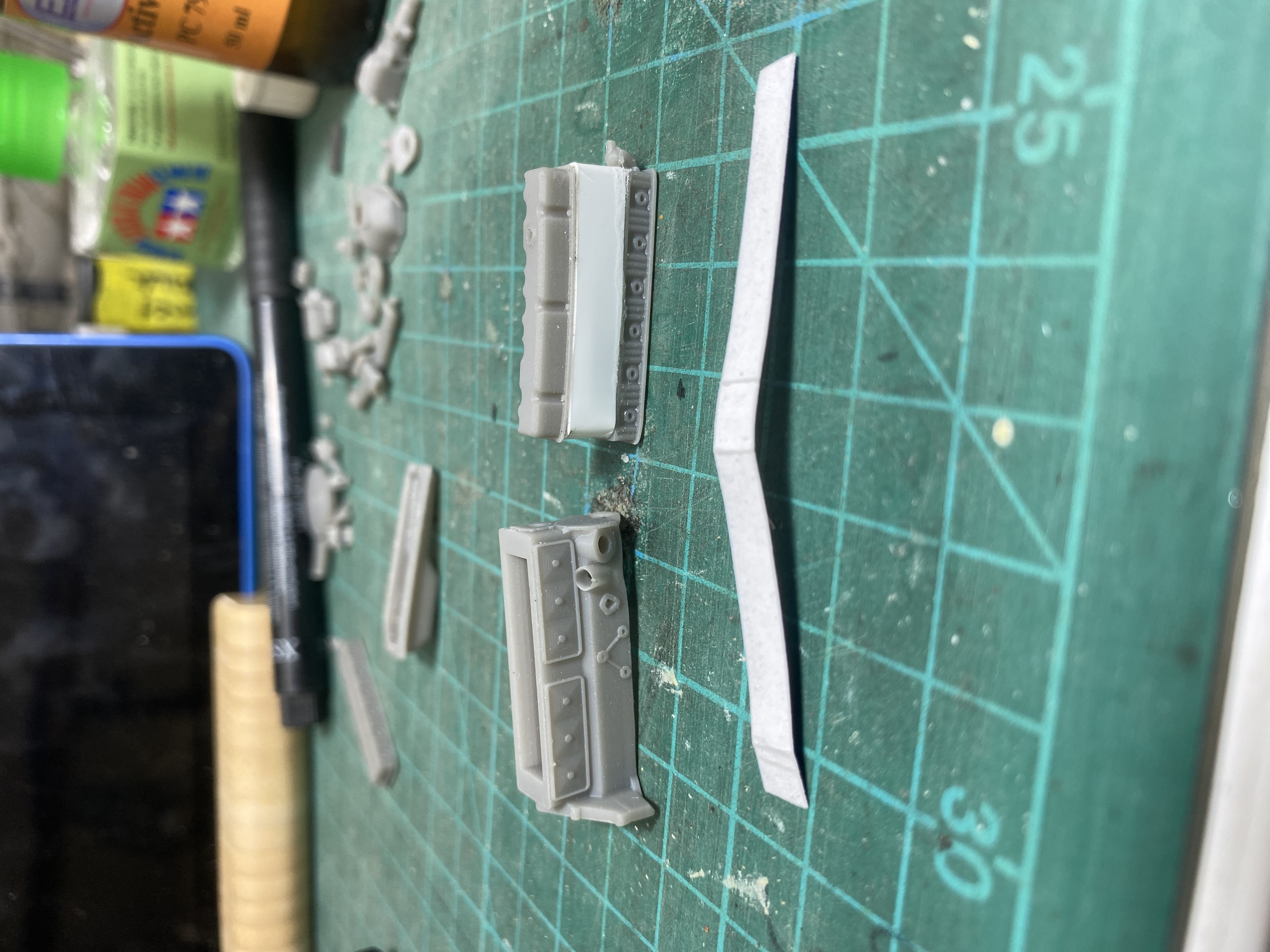

I made a template from paper and then used styrene(I think that's what you call it).
A bit of filler and sanded to shape.

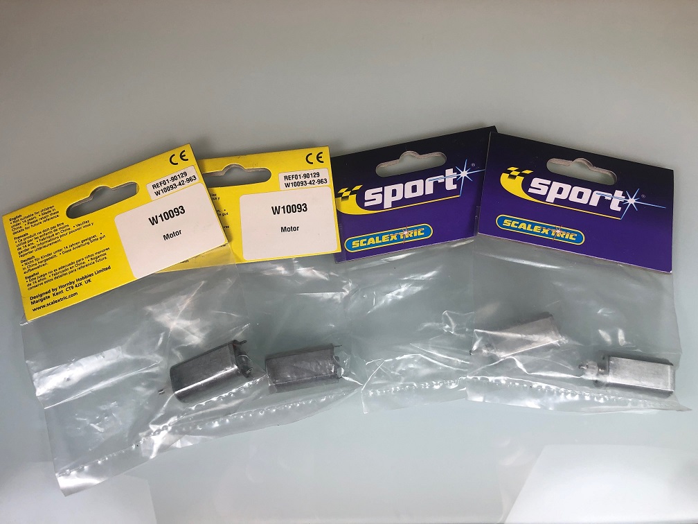

This motor might be a bit poky for it so I might change to a thin 18K one if I can find one.
Like I said it's going to be a long build, thanks for looking and I hope you enjoy it as much as I will.

Scalex makes a reasonable 18k slim line 050. I install them in a lot of cars. A replacement motor for a Scalex Mini, or Beetle will do.

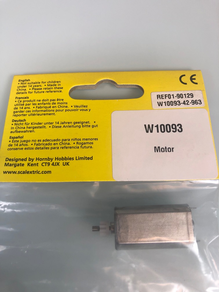

Thanks Ken,
are the scalextric motors any good? I read so much about their quality in their products.
I don't buy stock cars as such so have to rely on what I read.
Tony

Scalex is not known for amazing quality cars. The 18k S-can sucks in my opinion. But the 18k slim-line 050 is a scratch builders diamond in the rough. I dare you to try one. Not expensive either.
(6th-Oct-23, 12:29 PM)KensRedZed Wrote:  Hi Tony,
Thanks for that Ken, what brand is the 18K Slim-line 050 then? Sounds interesting.
