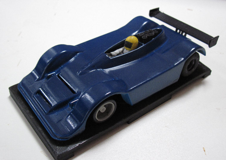

Wolf Dallara.
Designed this shell some time ago and its associated chassis for wood track racing, so needing a plastic track version I dusted off the body file gave it a few tweaks and a new chassis specifically for plastic track racing for inline boxer.
Body, wing, trumpets, chassis, pod, suspension plates & guide 3d printed the driver is a resin cast by a mate. Pod has a 1mm offset axle held in Slot It spherical bearings and rear wheel & tyres borrowed off an NSR F1.
             John

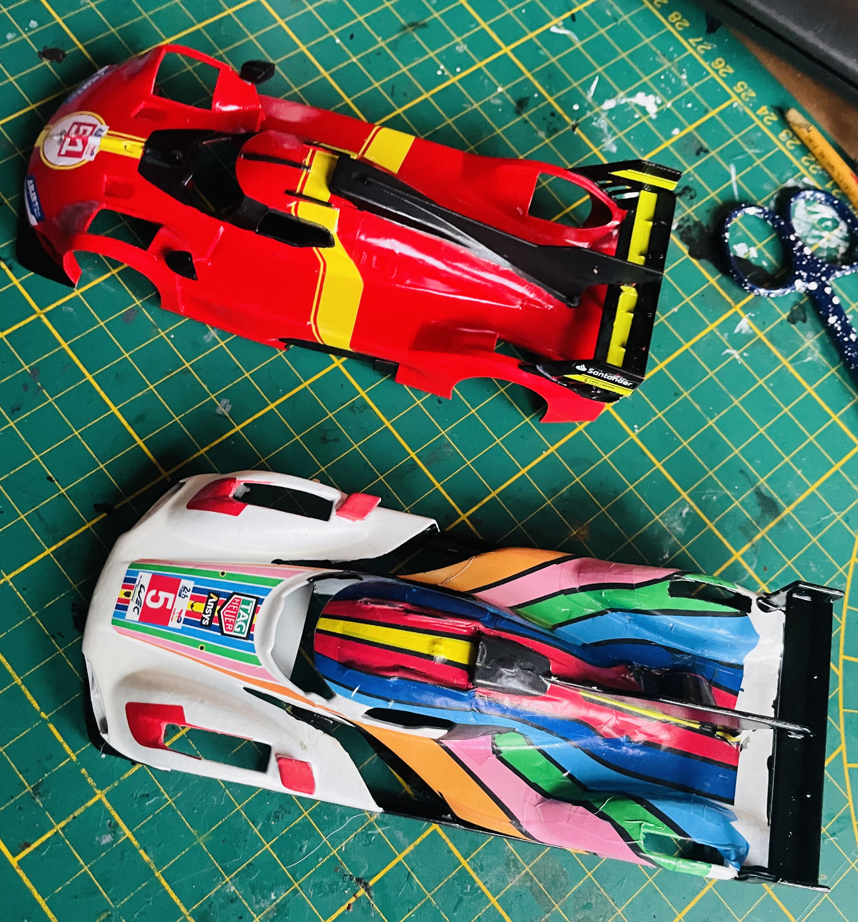

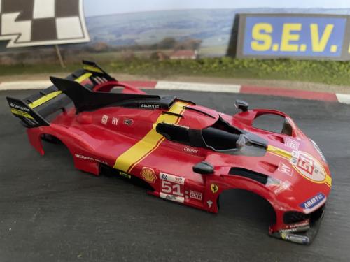

My ongoing builds of the latest Le Mans Hypercars - to say the porsche has been difficult is an understatement.

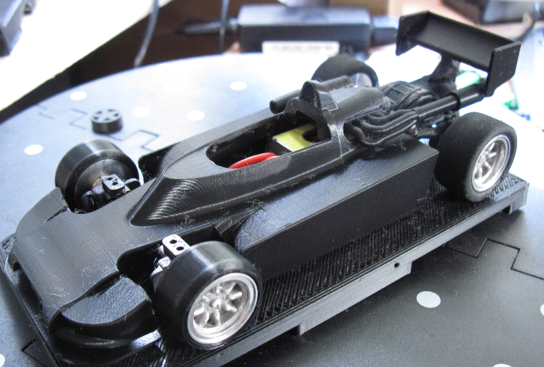

1/24 F3 1980s…
A while ago had a dabble creating a 1/24 F3 shell and chassis from the 1980s period, several iterations led to the shell shown below. The idea was that F3 cars are narrow track i.e. sub 70mm (smaller than the 1/24 Escort etc) so could race on plastic club tracks. The original chassis was too complex/ stiff for plastic club tracks so the performance didn’t inspire and I shelved the project. Fast forward I thought I would have another go and printed a slightly revised shell as below to fit on a new soft flex chassis.
The chassis, shell, wing, exhaust, intake, front tyres (TPU) and driver (hiding) are all FDM printed, running gear is BRM from the 1/24 Escort with the BRM large IL cog and a Allslot motor at 9:34 gearing. Car shown below with the parts fitted straight from the printer (supports removed).
Performance now on the club track i.e. cornering is greatly improved, and the chassis will clearly take a lot more grunt than the yellow Allslot boxer, so a transplant is in order.

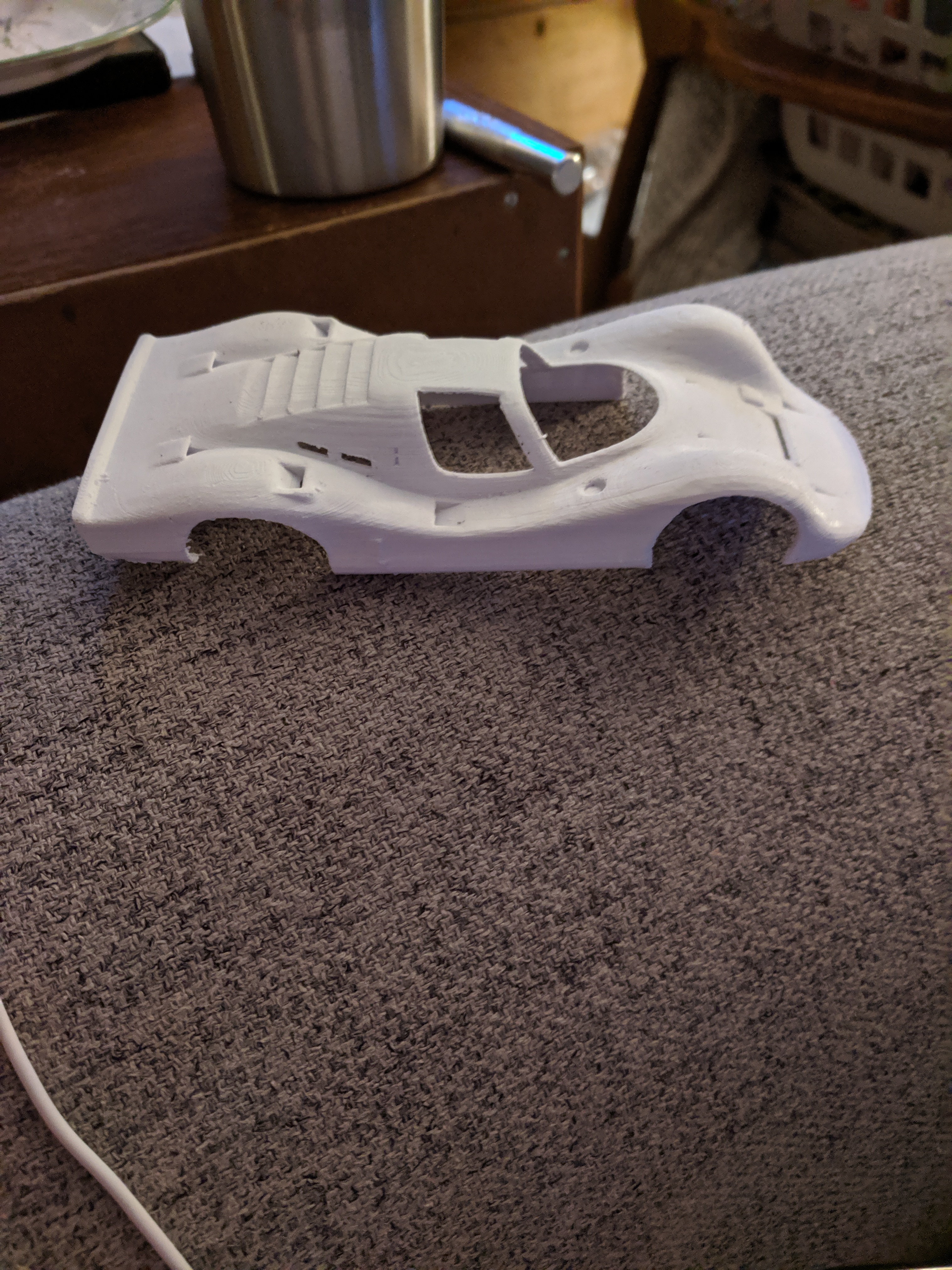

Fresh off the bed, a Japanese sports car:
