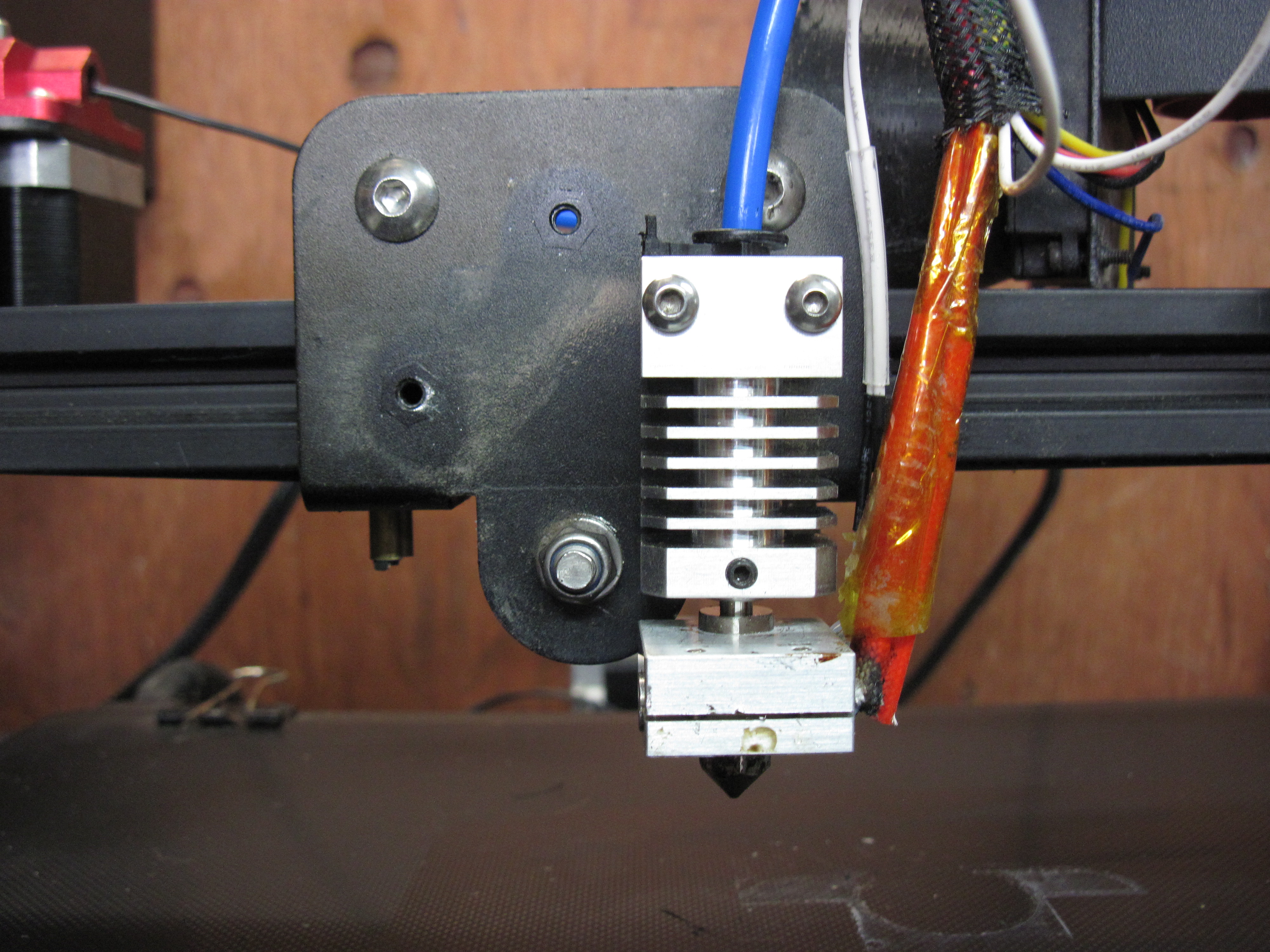

No new machinery this year, but several upgrades a Micro Swiss hot end for my CR10s and some hardened steel nozzles so I can squirt carbon fibre without tearing the nozzle inside out.

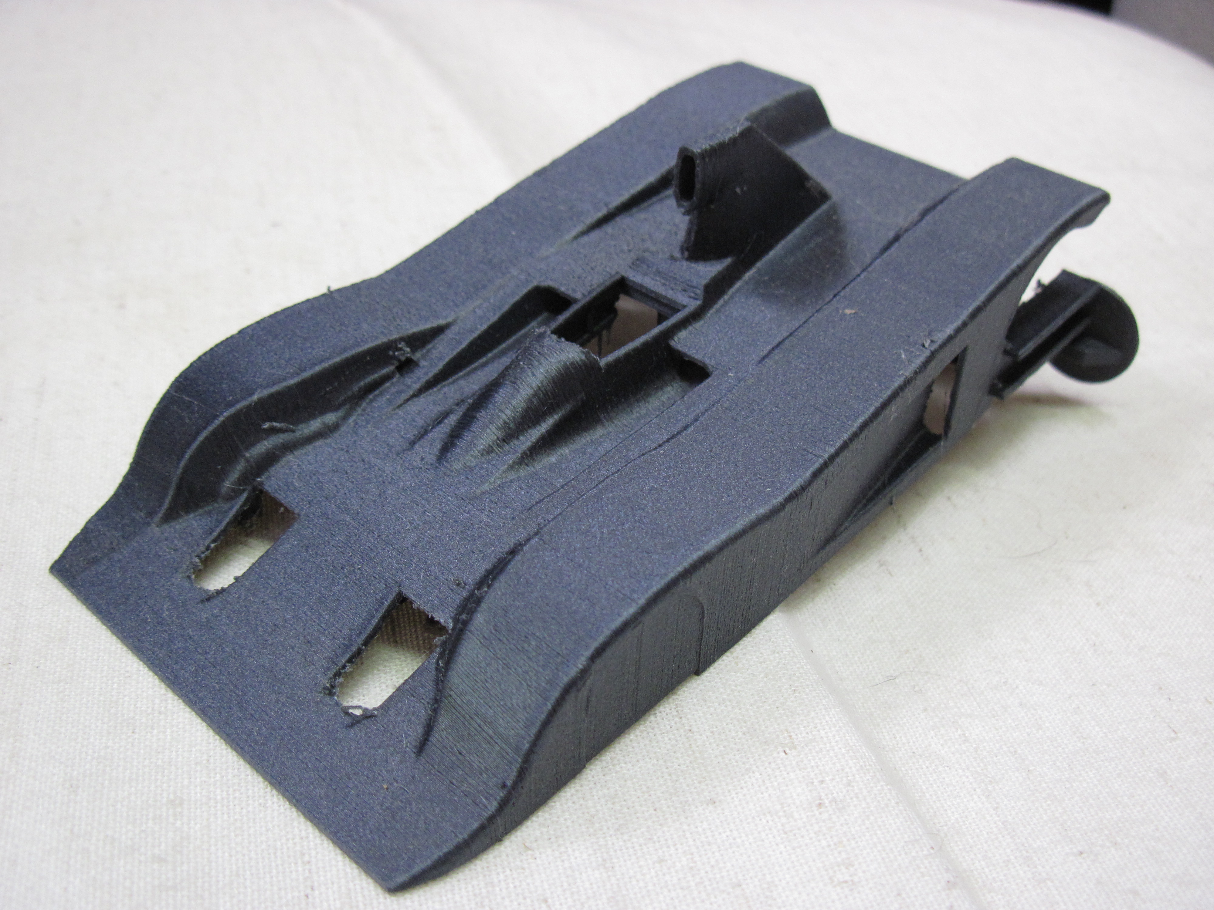

And printed this in CF, Lola T333 wide nose.

I can confirm that Lola of John's is superb and the finish is excellent and requires very little finishing. It is the first time I have been tempted with a 3d printed body shell as most others I have seen on these and other boards pages leave a lot to be desired. Great to see these things improving all the time. Keep up the good work you guys.

What filament is that John?

Kevan,
It is carbon fibre strands in PLA from Amazon as below.
https://www.amazon.co.uk/ZIRO-Printer-Fi...bon-1-75mm
Few issues on layer de-lamination to start with but good customer support and upping the nozzle temperature to 245-250C and knocking back the fan speed fixed that. The black comes out more silver grey but at least I can see what it is from a distance.

My preferred filament is CF-PETG, I find 240-245°C and 25% fan works
