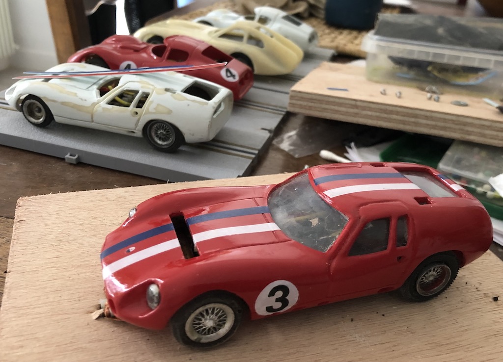

Like your work on the cars - how are you doing the screens??

I've had a proper Chinese replacement for some time and it works fine and includes more tools that I am ever likely to use plus all my old Dremel cutters fit as well.
I've already thinned the resin down around the open areas and will just use contact cement to stick thin clear plastic in. It's worked OK for the wooden ones so hopefully will be OK here too. Shouldn't look too far out as the resin can be thinned far more than the balsa and I reckon that looked OK.

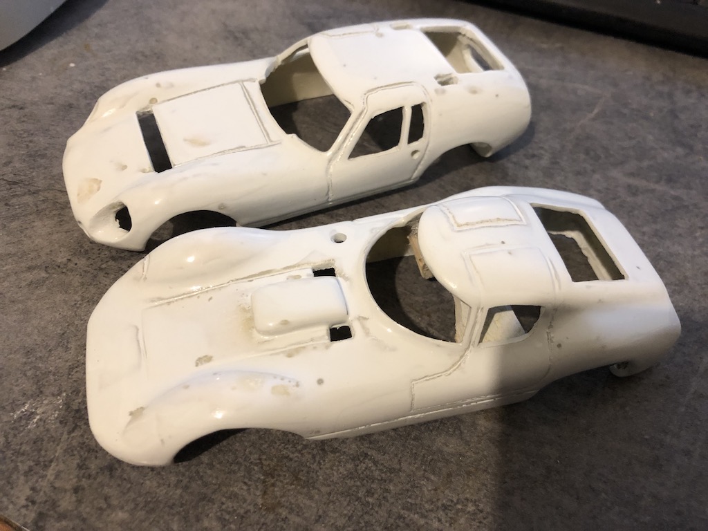

Resin body experts. I've scrubbed the bodies with soap and water, rubbed down with wet and dry and still there are areas that refuse to accept paint. What do I use to get rid of what I assume is release agent? I've used car paint this time. Cheapo supermarket paint worked OK though. Don't want to have to strip it all off.

Did you cast them, Gordon?
Did you use release agent?
After a good scrub and chemical clean if areas not taking paint still is a problem I think it is a resin issue not a release agent issue.
One part of one type of resin I use starts to crystallize after some time and I think if this is used on making bodies I think parts remain unmixed and cause this issue.....No empiracal testing sorry, just a gut feeling.
Solution is to.....find a paint that works or....there's the bin over there.

Thanks John,
No, I didn't do them, I just sent the formers to a guy in the UK (you are a l o n g way away
) so I had no control over the mix.
I do have the moulds so if I have to, I can get some resin.
The first pair in red were fine using some cheap supermarket paint so I'll try some of that in white first. I thought using some cellulose would give a better finish!

Gordon - I have in the past found that when this happens - spray from a distance an give a verrrrrry fine mist of primer - repeat several times. I have found this works on difficult bodies.
Hope this sorts it out.

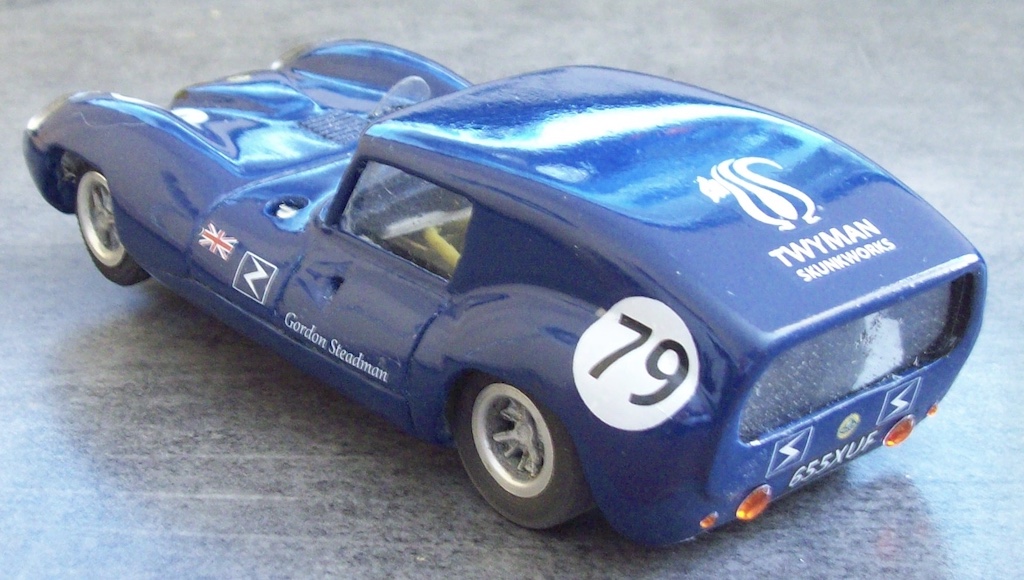

Anyway, the first is about as far as I'm going to take it. Decals arrived from Colin so it's done I reckon.
