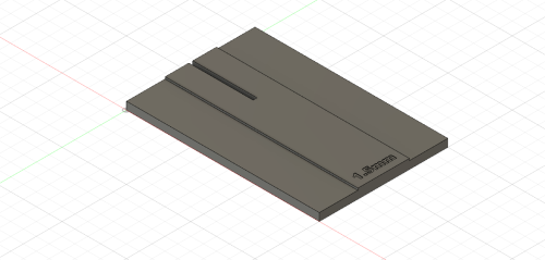

(21st-Oct-22, 04:32 PM)Graham Wrote:  I am using a Scaleauto gauge to measure track clearance, it is not perfect if I check it with my digital caliper, as I have found that the increments on it can be plus or minus 0.02 mm out, depending on which step you are using.
I'll have to look for one of those for future use, my metal sheet offcuts were around 0.1~0.15 mm shy IIRC
Pendle Slot Racing have them for sale

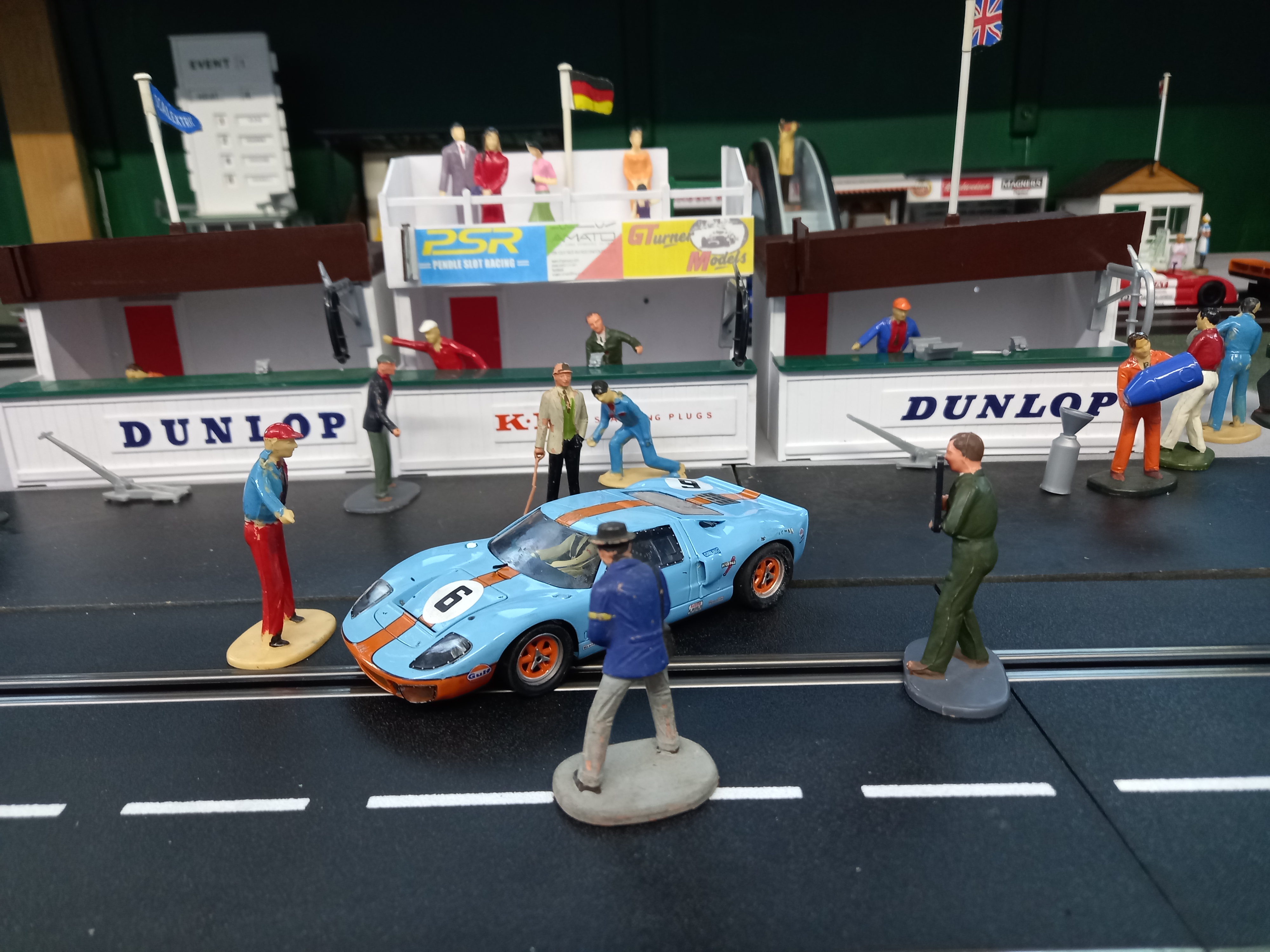

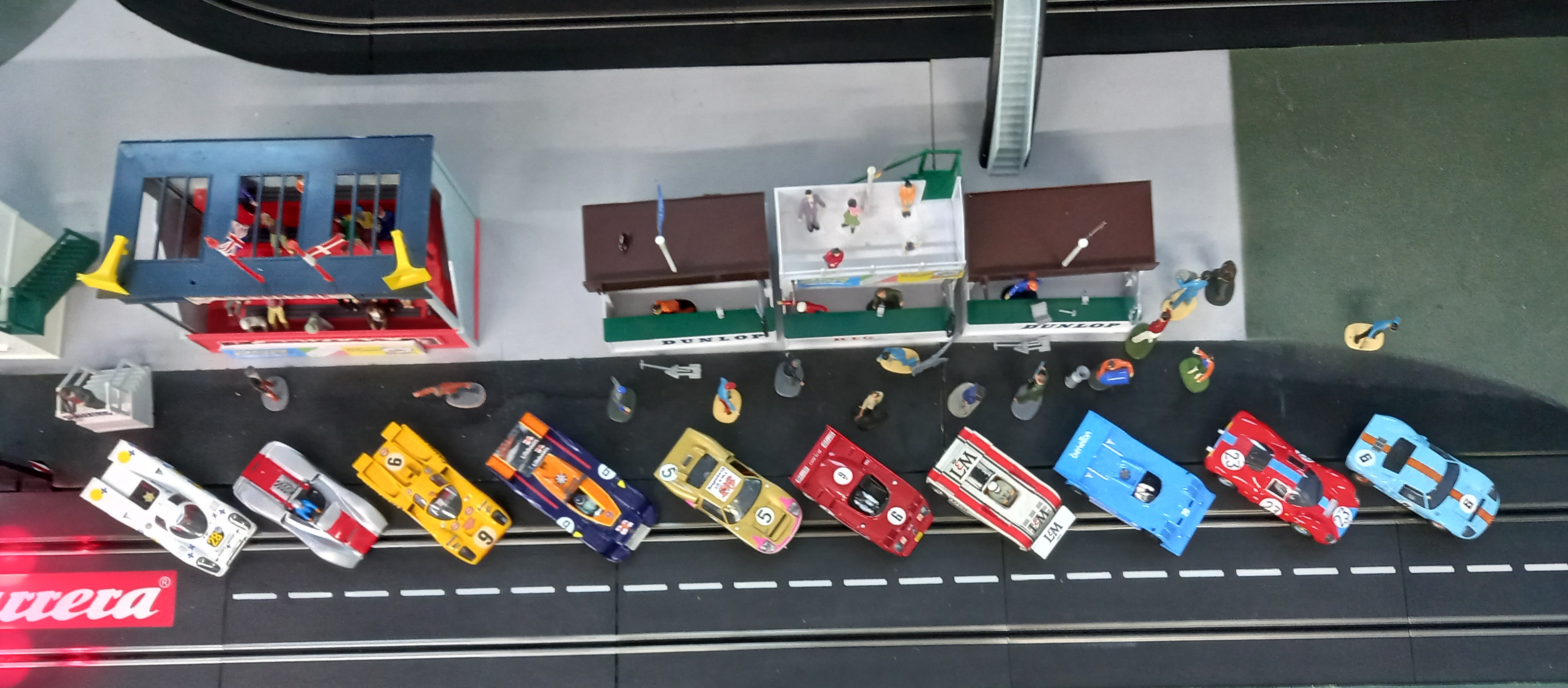

So to start with a quick photo session this morning
InterSeries (Class D)
Ruscillo Racing - Ford GT40
Classic Slot it car with standard body, chassis and SW 23K motor. No lights fitted
Test Run -  As you would expect a very smooth running car, great around the corners. Does not feel exceptionally fast but very consistent.

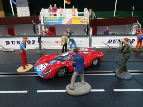

ALS Racing - Ferrari 330
Classic Policar with standard body, chassis and SW 23K motor. No lights fitted
Test Run - This did feel a little faster, but also very good on the corners and very smooth.

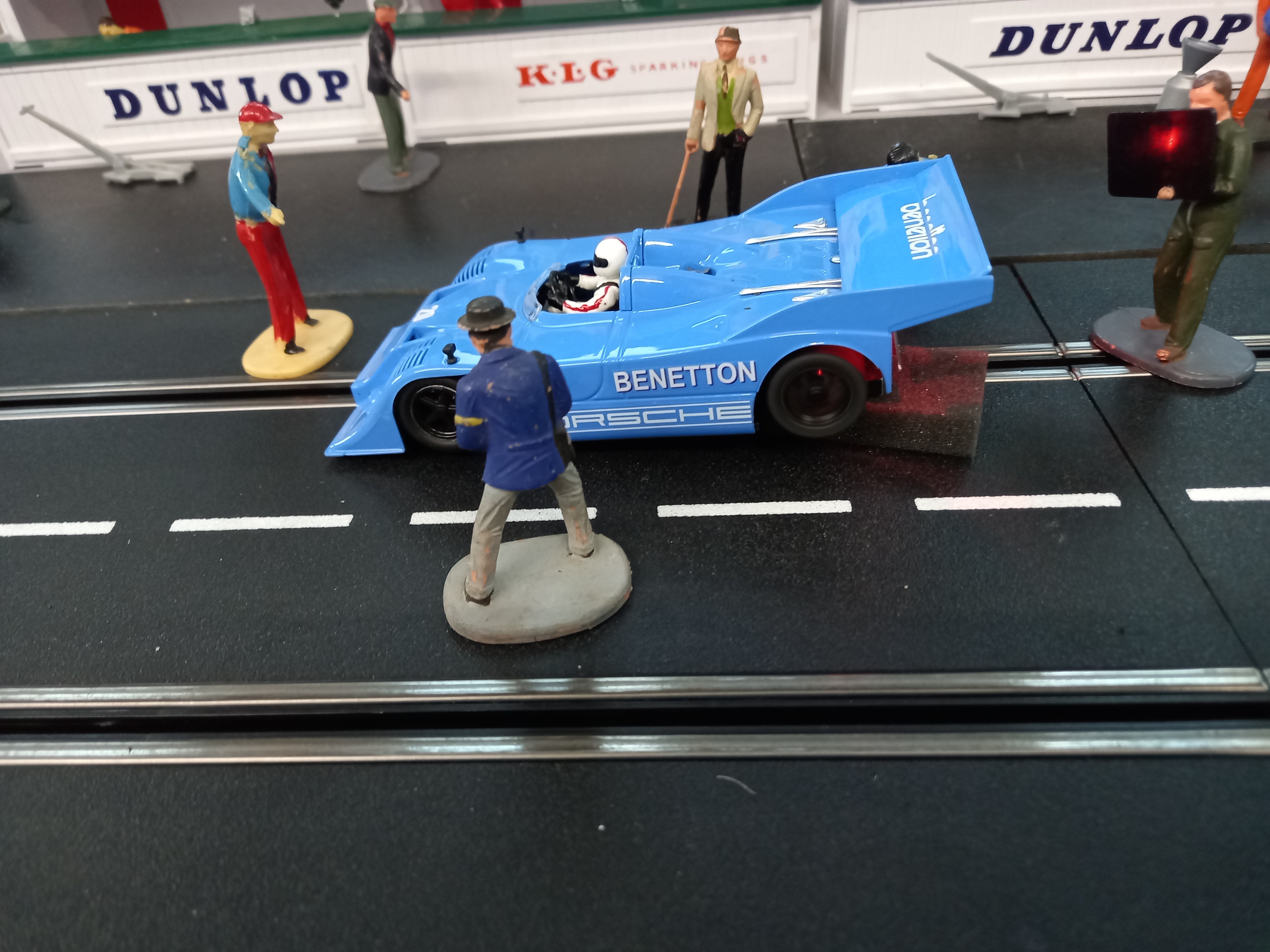

Courtney Sport - Porsche 917/10
NSR based body and chassis but with a metal motor mount and SW Predator 22.5k rpm motor.  Brake Lights fitted to rear
Test Run - Into the very fast league of entrant cars, very easy to run, fast everywhere.

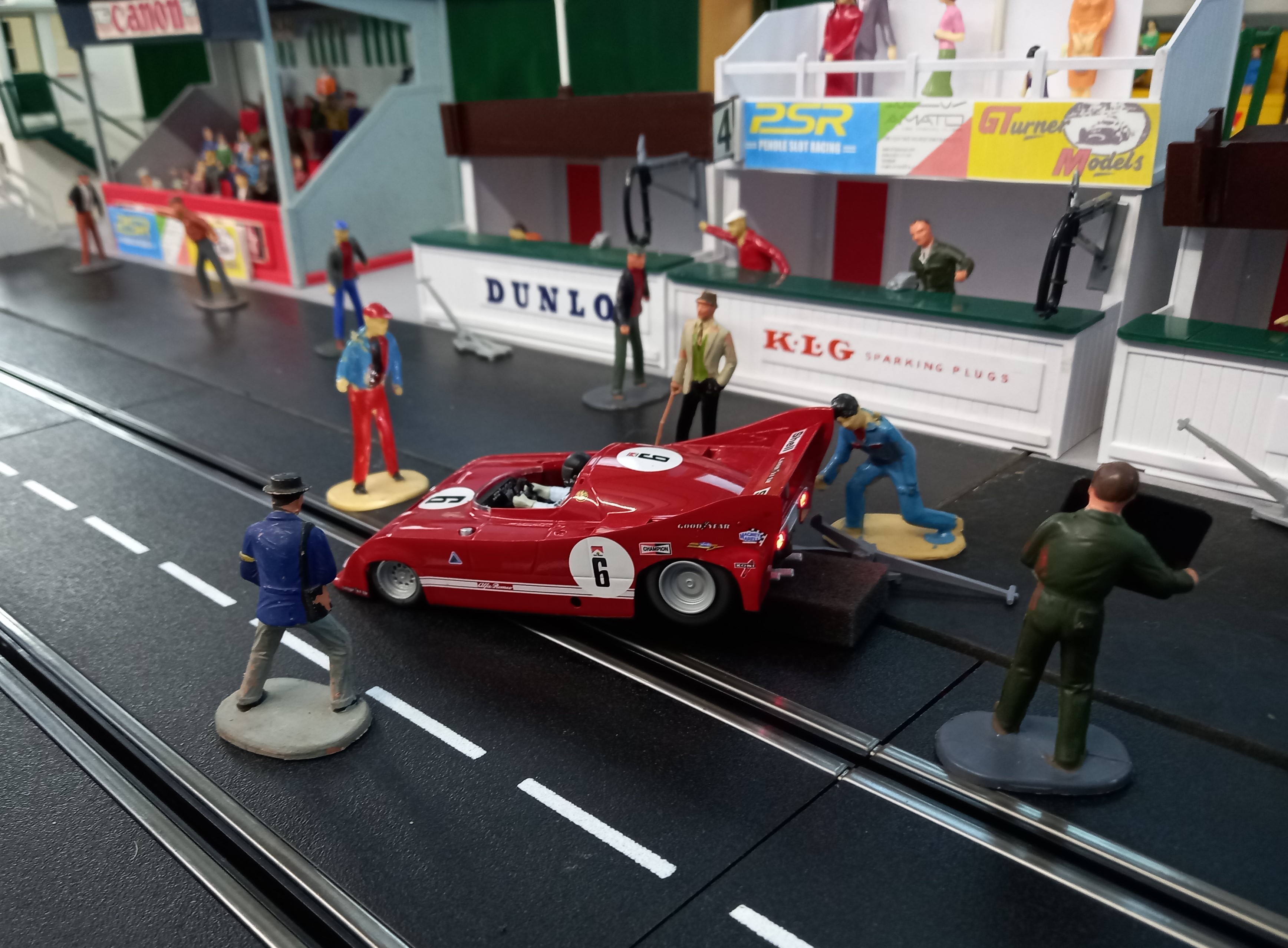

Mountain View- Alfa T33
SRC body with Olifer chassis and SW Piranha PSM21 motor. Full set lights
Test Run - one of the smaller cars but very well put together as you might expect from this team. In the very fast league and holds the track around the corners very well.

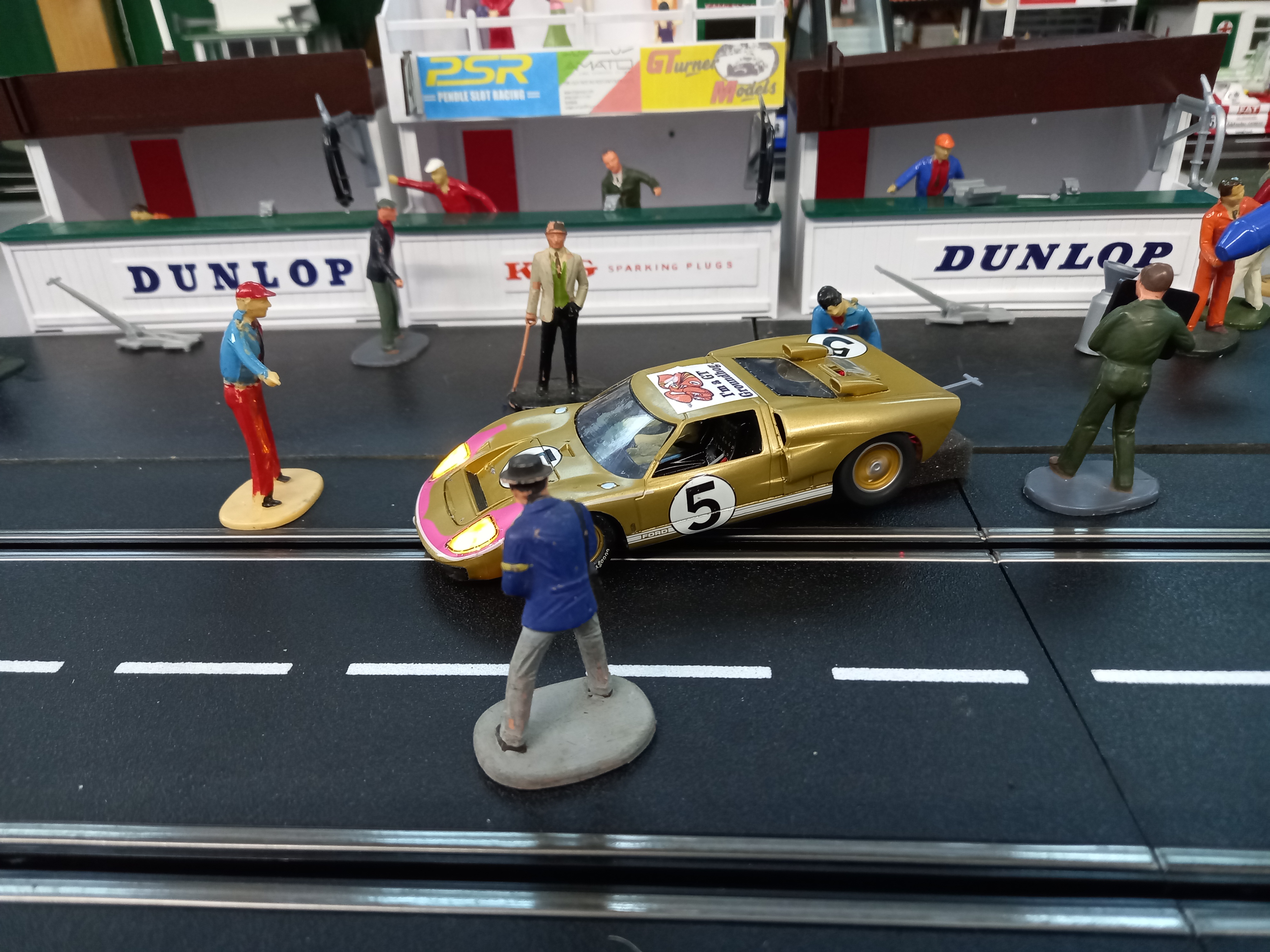

Team Groundhogs - Ford GT40
Standard Slot it body, chassis and SW motor. Complete set of lights
Test Run - not one of the fastest cars, seemed a little less smooth on running than similar cars, but quite steady around the track.

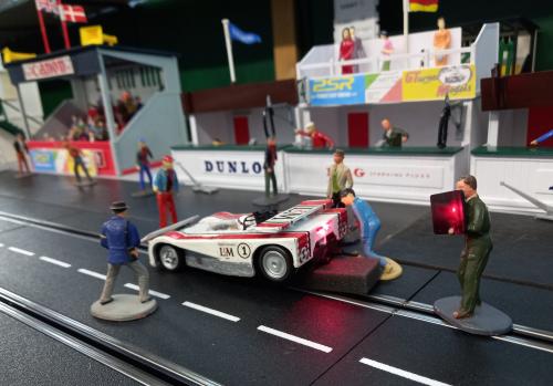

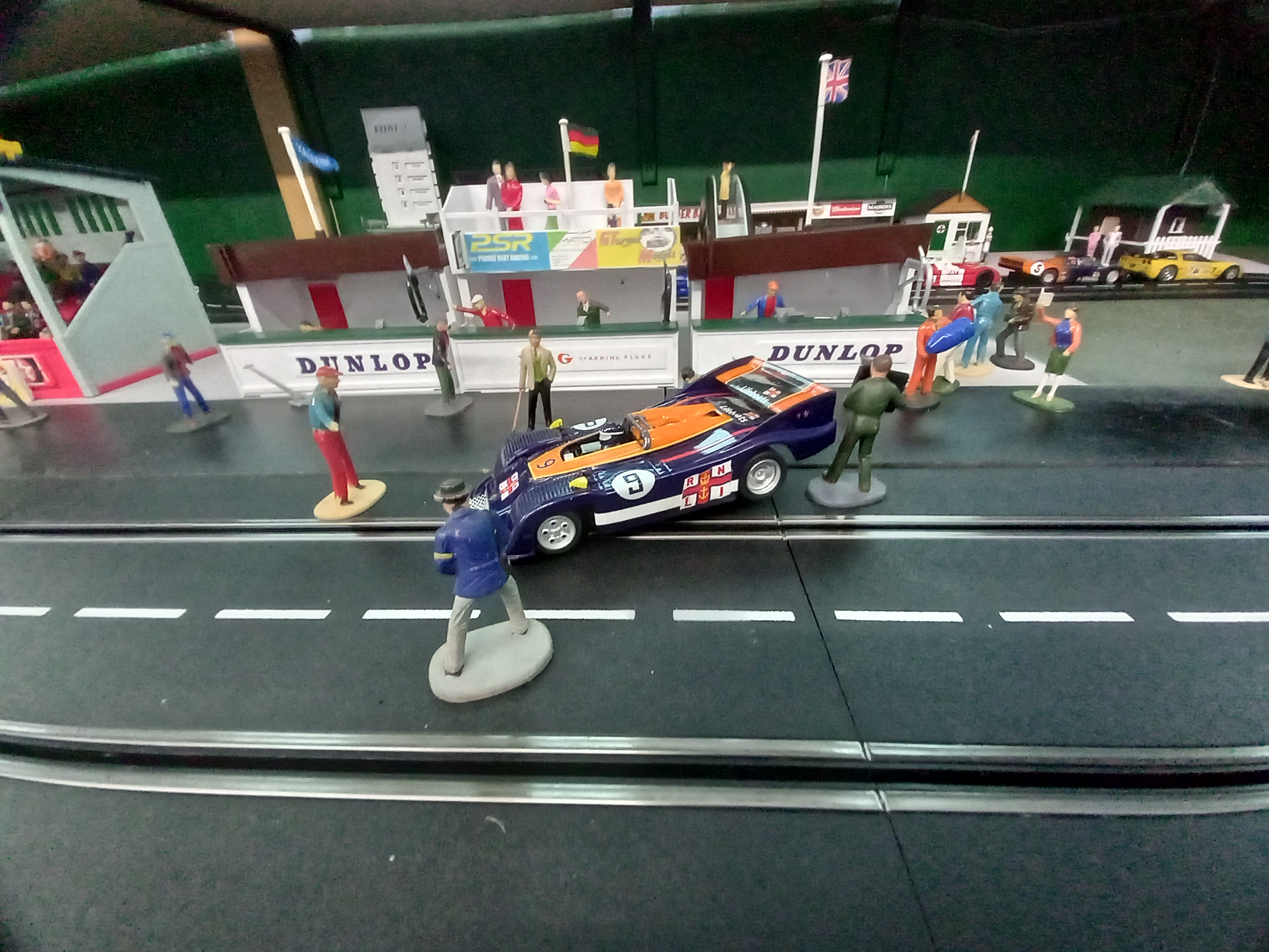

Lifeboats Racing - Porsche 917/30
Carrera body ......but with a NSR chassis and AW motor 21.5K. No Lights fitted.
The guys from across the pond might struggle to find records of the Lifeboat Racing Teams car listed in the Can Am series, and perhaps their car was never quite registered in the series, although if it had been it would have looked like this  Rofl Needed a little maintenance to get this one running consistently, but the team were kept informed.
Test Run - It is one of the heavier models, so I don't think it will be one of the fastest but it is monster of a car and very wide, therefore  very stable around the corners, and with that NSR running gear might throw a few surprises especially around some of the larger and faster tracks.

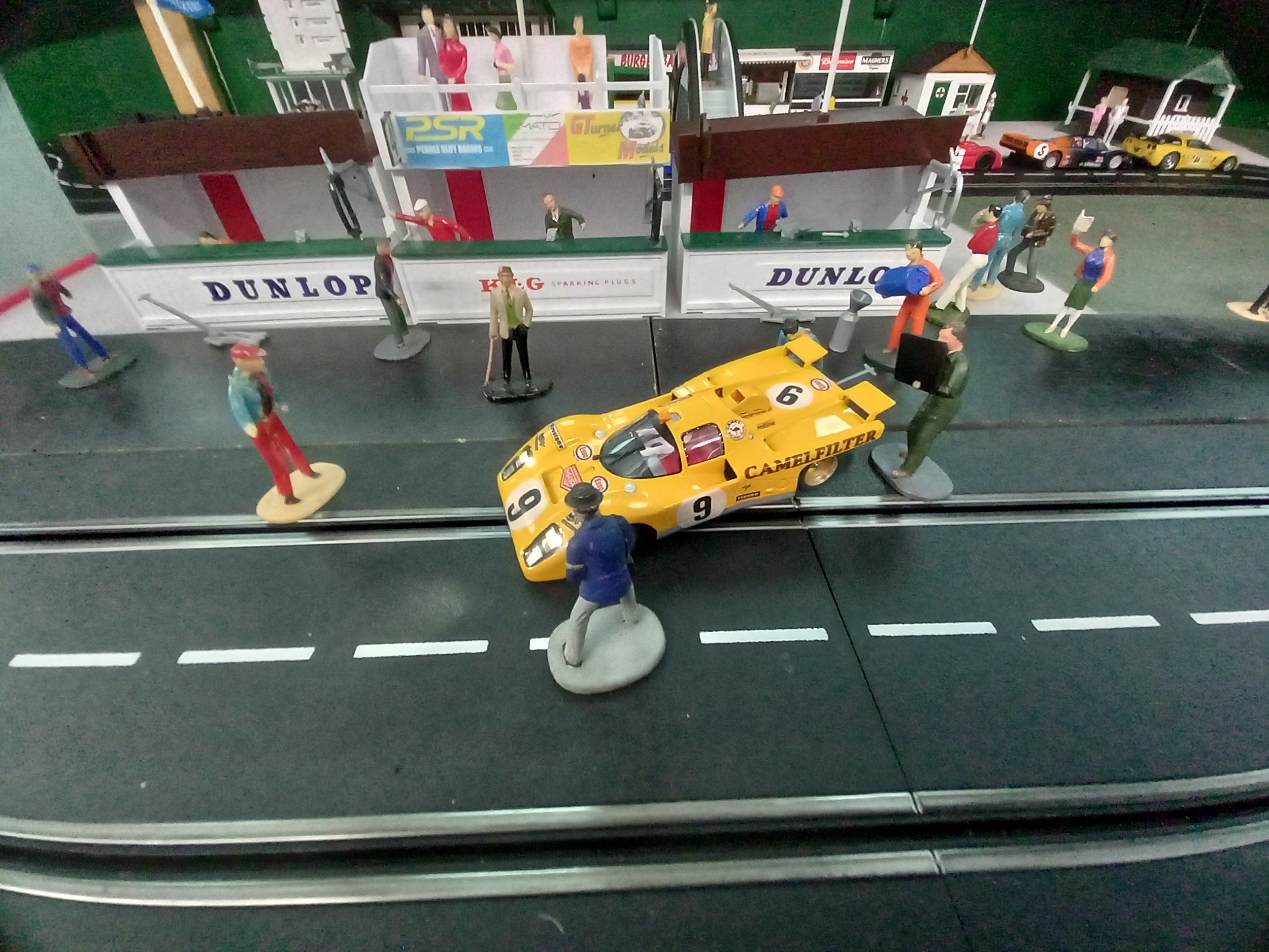

Savage GT - Ferrari 512M
Slot it body kit with SW BRM 23k motor. Front lights
Test Run - Umm, very interesting, it is "Super quick" around the Harlequin. And of course I should say what a fantastic job on the livery. I would not know that this was a self decorated model. First class  Thumbup
cheap ebay feeler guages also work , are accurate and only around £3
A length of piano wire is cheap and easy to feed under cars and move back/forth.

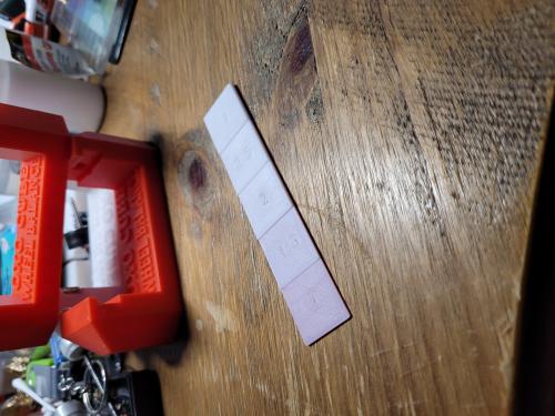

...or 3D print a simple ground clearance scrutineering block.  Here's one I just drew up in the last few minutes with 1.5mm ground clearance (it could be any distance)

(22nd-Oct-22, 08:42 AM)Graham Wrote:  Savage GT - Ferrari 512M
That sounds ambiguous, now I am worried  Sweating
Thank you for your kind words about the paint, It was supposed to be my first air-brushed car, but I couldn't get on with an airbrush so ended up being rubbed back to primer and finished with Tamiya cans, even then I wasn't happy with the first colour (called Camel Yellow, so I had hopes) so it got another coat of a lighter yellow, probably now a lot thicker/heavier than a factory body  Rofl

(22nd-Oct-22, 10:29 AM)Kevan Wrote:  A length of piano wire is cheap and easy to feed under cars and move back/forth.
made this a couple years ago , its not super accurate due to the 0.4 nozzle i used , but its near enough
i use it in conjunction with my setup block , works well , free STL for you 3DP guys :)
