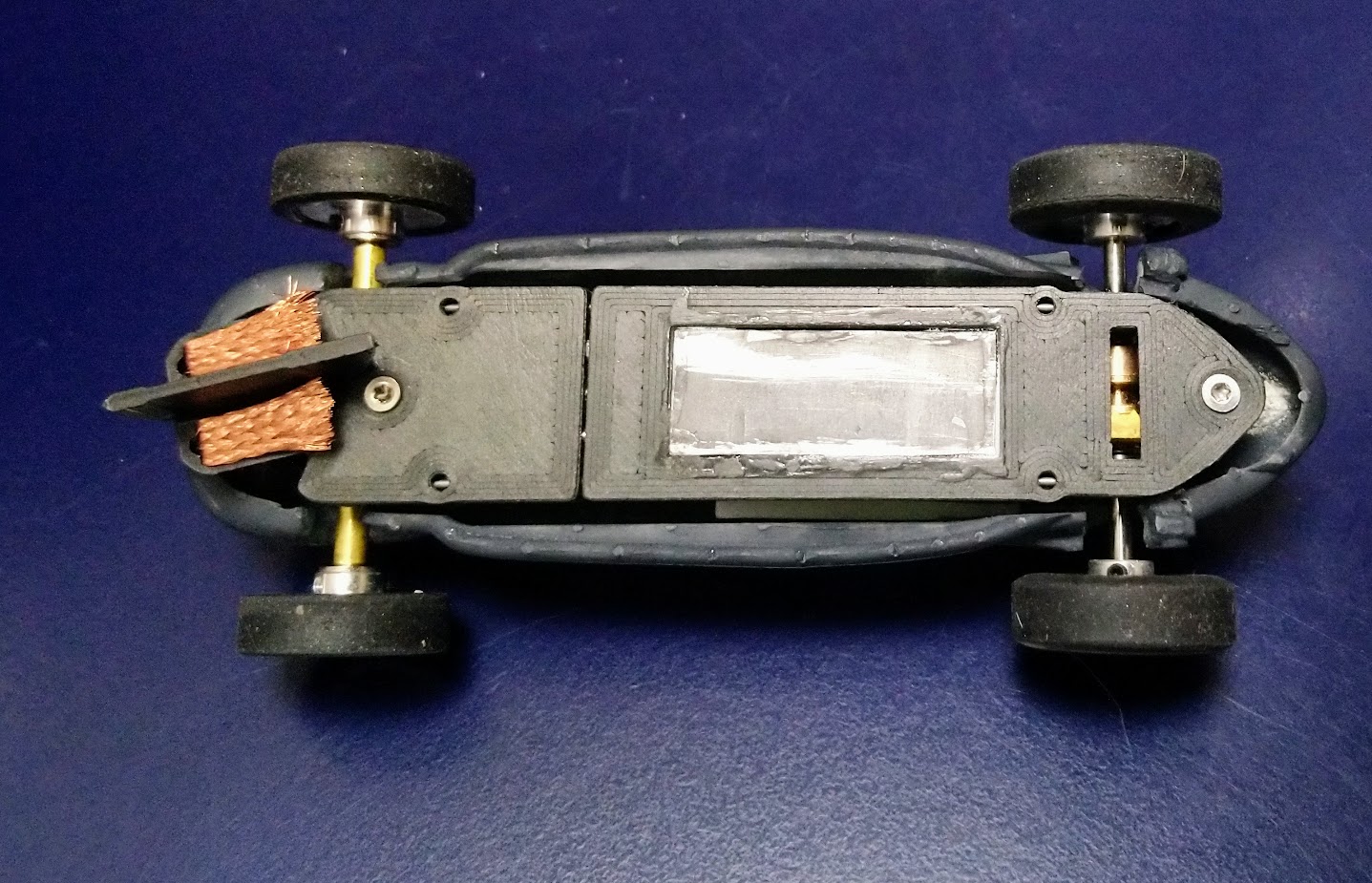

Currently printing a two piece chassis for the 3D printed Mercedes W165, the design is along the lines of the red Lotus 25 which goes really well.
I intend using one of the tungsten TIG rods you see glued to the chassis next to the W165.
Rear axle will be ballraced like the current setup.

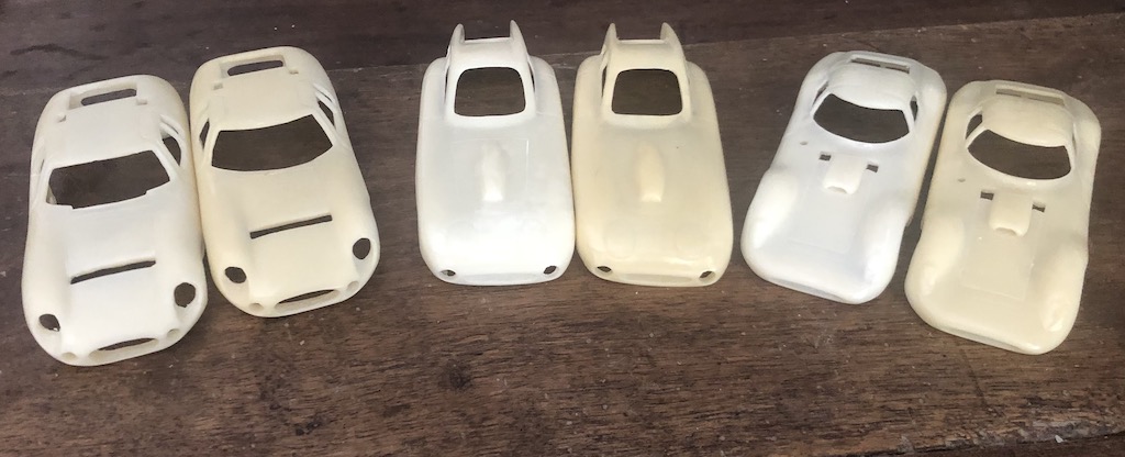

Have taken a few minutes to finish cutting and grinding the resins I had made. Good thing I had two of each as I messed up the Bristol. I hadn't realised how crooked it appeared. Turned out that the roofline was half a mil out one side. I discovered this after I'd taken some off the bottom of one side of one of them. Such is life.
The Masers turned out OK and I'm making two versions of the 152, the prototype and then the first racing version. There seem to have been loads of changes to the car as it developed - although it didn't develop much it seems!
As these are all to scale, they are a bit narrow but will go well on my track with Pittman 196Bs (anyone got any to spare?) No idea when they will all get finished as it's back to work soon.

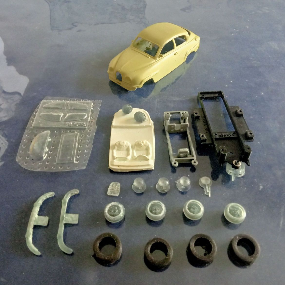

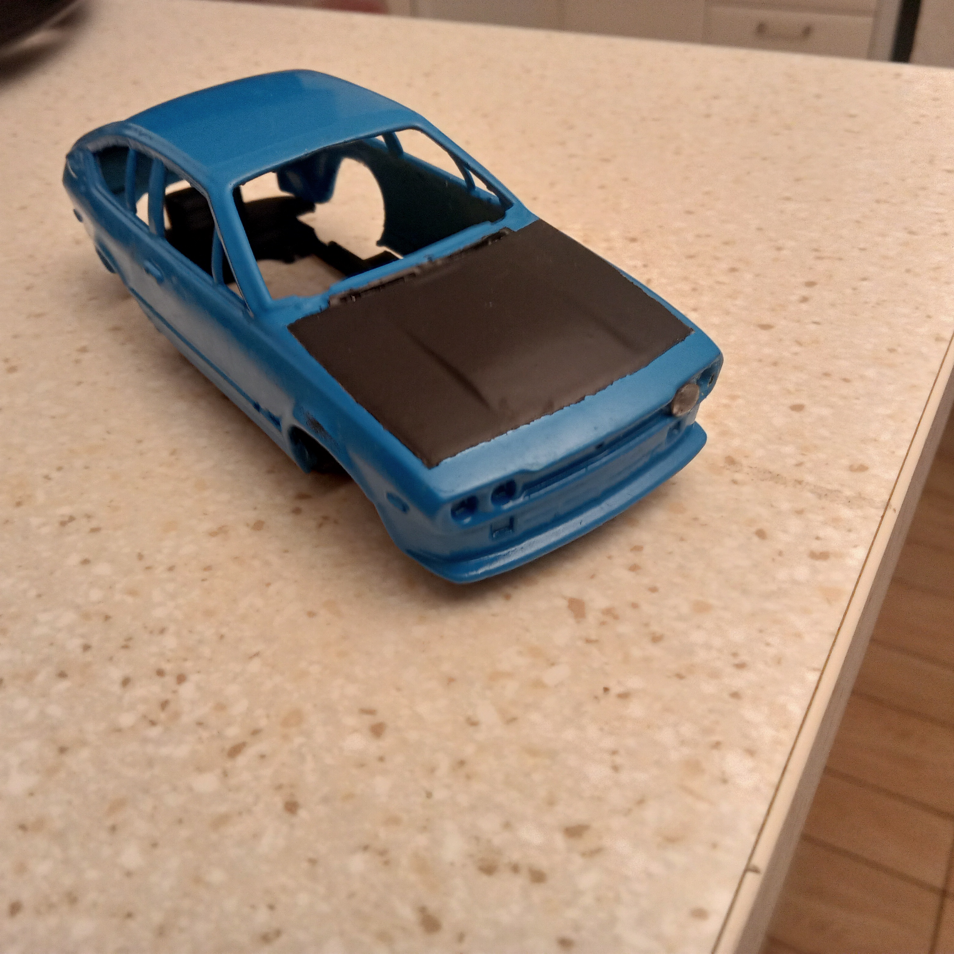

All 3dp.An Alfa Romeo GTV V6
a Saab
and 3 Autobianchis

(18th-Jul-22, 07:38 PM)Kevan Wrote:  Currently printing a two piece chassis for the 3D printed Mercedes W165, the design is along the lines of the red Lotus 25 which goes really well.
New chassis feels much better.
There's a centre pivot which is 2.4mm tungsten TIG rod and a couple of pieces of the same rod either side of the pivot.  Tungsten is denser than lead.
This is to CSCRA regs for Voiturettes and that guide doesn't protrude past the front of the bodyshell.
