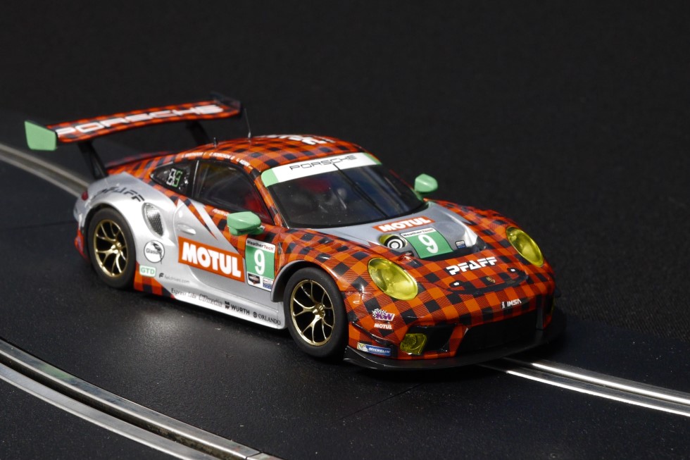

Back to the Scalextric model - and there's no doubt this is a beautiful-looking car with very sharp decoration...

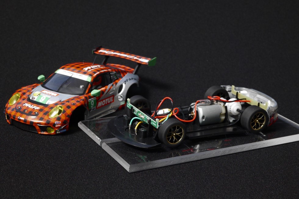

Plus a look underneath and inside the car...

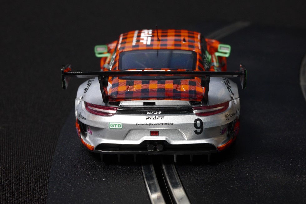

Apart from the neat Porsche logo and the reinforced DPR hatch, it's a pretty standard Scalextric GT layout. Except that the lower portion of the rear is a separate piece. This isn't unheard of on slot cars and does allow much more detail and a more authentic shape than a one-piece mould. However, racers will need to do some work on this to get some decent body float - a little bit of surgery and gluing the separate part to the body should do the job. Slightly more work than normal, but not insurmountable.
The magnet comes out easily and there is plenty of room for ballast. I set up the car non-mag with a pair of urethane tyres, a gram or so of blue tack beside the motor, plus a C8515 digital plug - and gave it a run out before our Worthing Digital evening this week...
No timing, but the car was nice and smooth to drive on a big 100-foot Scalextric digital layout. From some quite fast-paced laps, I though the car has everything needed for a good Scalextric GT racer. The front wheels are just touching the track, so the usual work re-profiling the braids, truing wheels, tyres and adding a little weight front and mid-ships would certainly improve things - plus that work on the body layout to get some float. It turned out a few WHO/digital racers have the Pfaff Motorsport Porsche on pre-order, so we'll definitely see at least one on our GT championship grid later this year.

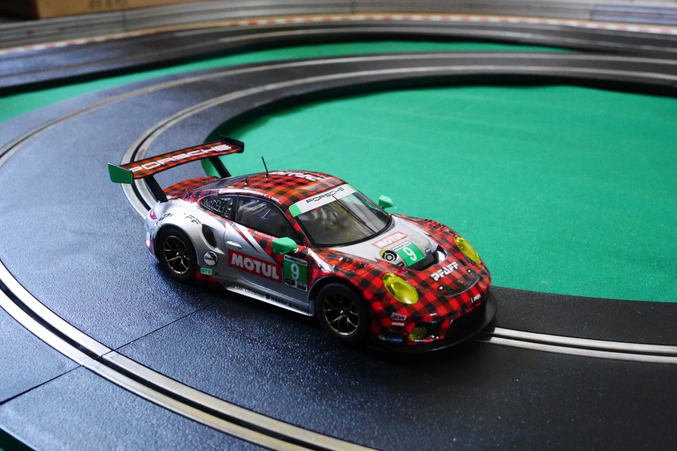

After some satisfying laps at WHO/digital last week, it was time to give the Porsche a spin on a typical home track - which will be the normal terrain for most of the production models sold... at least of those that get taken out of their boxes.
As the Porsche came back from the club in a non-mag set-up, I started with it that way. I removed the digital chip and changed the tyres to some NSR Supergrips, as that's what I've used when I've tested preview samples before. Simply removing the magnet and using the Scalextric tyres (designed for magnet racing) is a waste of time - the Supergrips and about 1.5g of weight in front of the motor gives a better car and a meaningful comparison to other preview models.
My test track is a typical 4x8 rug racing layout - essentially the Jadlam SL6 set, built with Scalextric Sport track and an ARC Air powerbase. It's very technical and gives a good indication of how a car will handle on a home track, plus there's a quick squirt of full throttle on the four-and-a-half foot straight.
The Porsche was very predictable on the track - no surprises, no weird understeer and just a gradual slide of the rear end, which was perfectly controllable. I could throw it into corners and get some big slides, but it was easier to drive it neat and fast. A first 2 minute run got me acquainted and then I set 22 laps and a best time of 5:15 seconds - a very decent non-mag time for a Scalextric car...

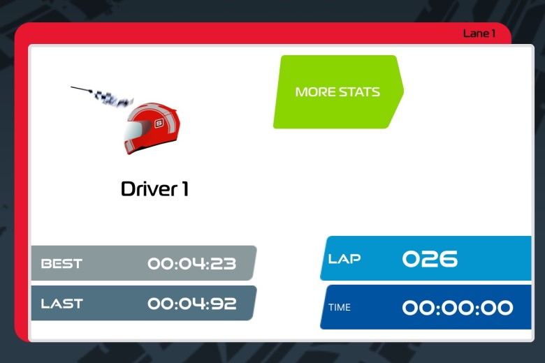

Without being able to tweak much on the car (it had to go back to Margate in its original state), I loosened the body screws as much as I could... Back on the track, the understeer was gone and the car was easier to drive. On my first timed run after the tweak, I set a new best of 26 laps and 4:23 seconds - getting much closer to the 'old' Porsche...

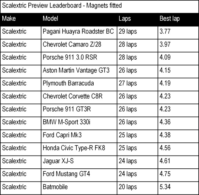

Compared with the other Scalextric preview cars I've looked at over the past couple of years, the Porsche sits right in the middle - interestingly on an identical lap score and best time as the Corvette C8R with magnets fitted and the new Vantage is just ahead of them...
Whether deliberate or not (and I suspect it is), the Scalextric team are producing cars in their different themed ranges that can compete with each other on track. The GT cars seem to be a little less stuck down than some of the other cars - partly because they are easier to drive with a wider track and are less tippy (the Mustang being an exception). The Porsche 911 GT3R certainly fits in very nicely to the range with its sharp looks and excellent track performance, with and without the magnet.
